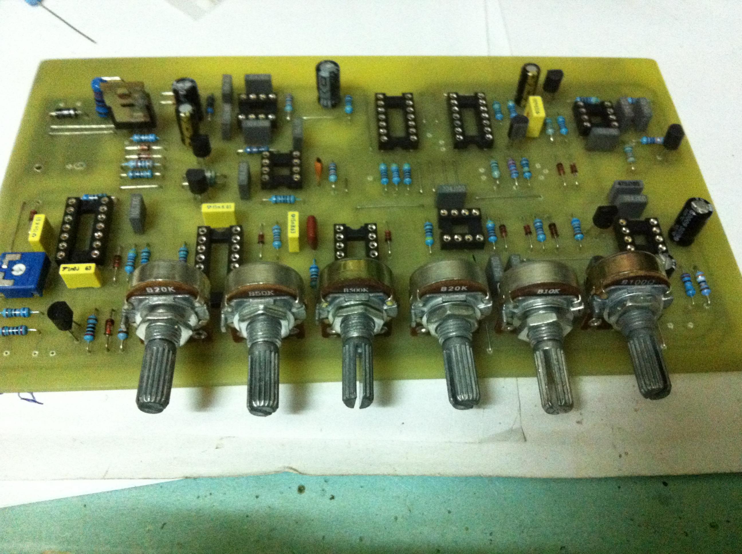

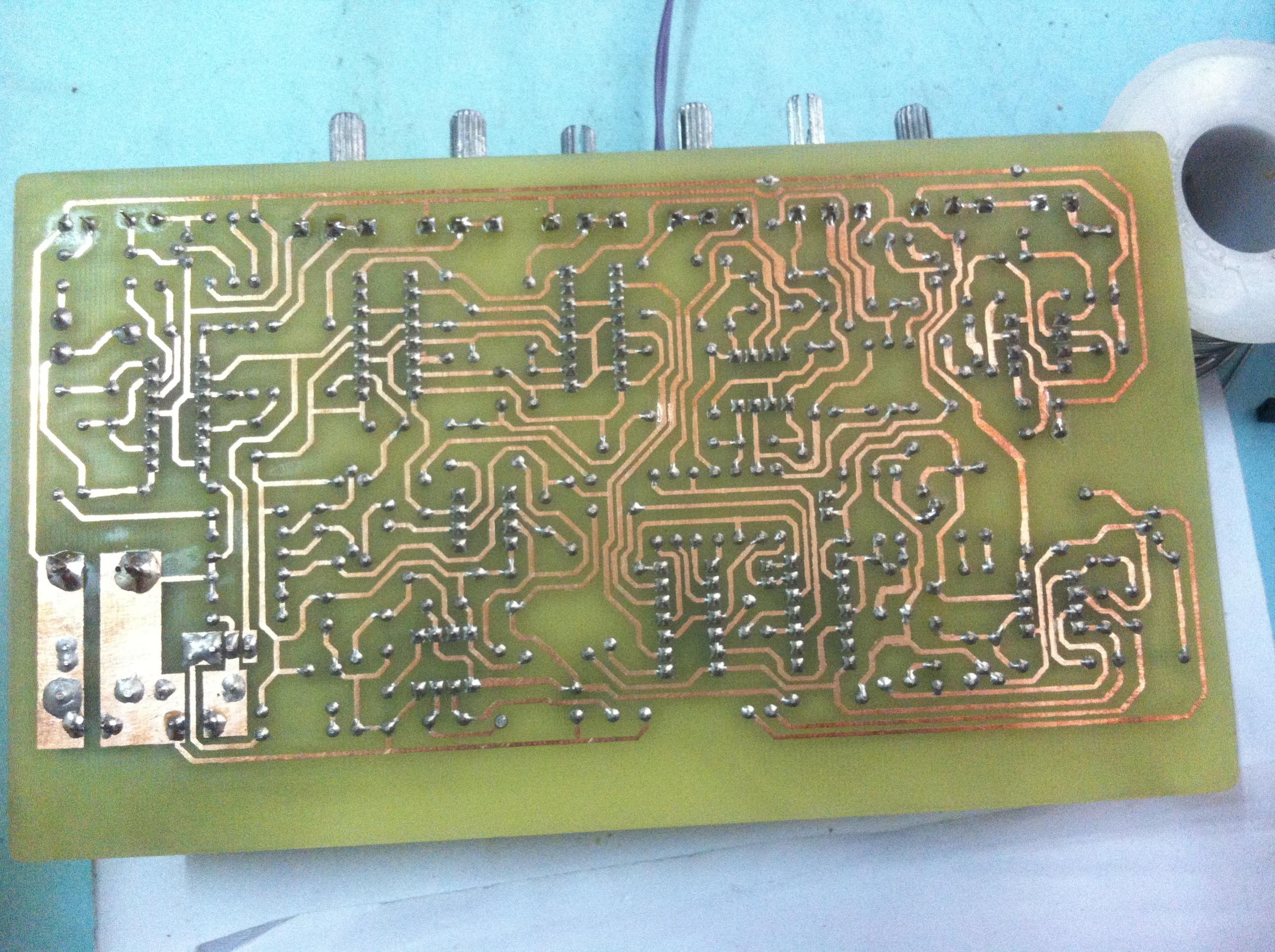

        this is My DP can someone explain this board
        im missing one BC546 what i can use for replacement
        • BC237 BC238 BC547 BC548

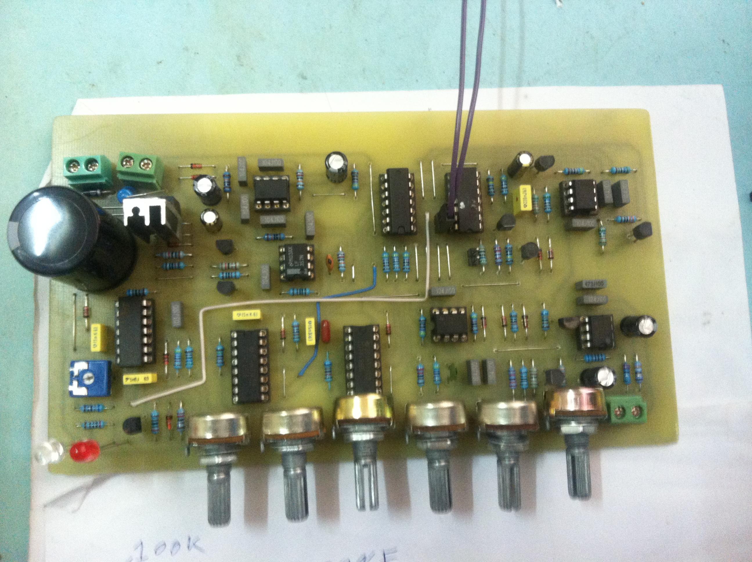

                  • My DP Picture
                    • no paku the diodes in D8 D9 position on the schematic posted by KT like he said if they are not real they can't handle the 200ma max like real ones. i think thats whats wrong with your dp i had the same problem till i changed them. what schematic did you use your board is different ill look and tell you the numbers for yours.
