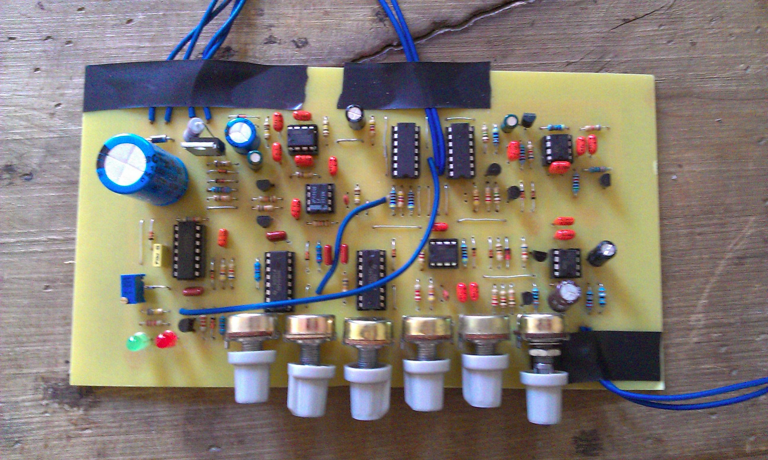

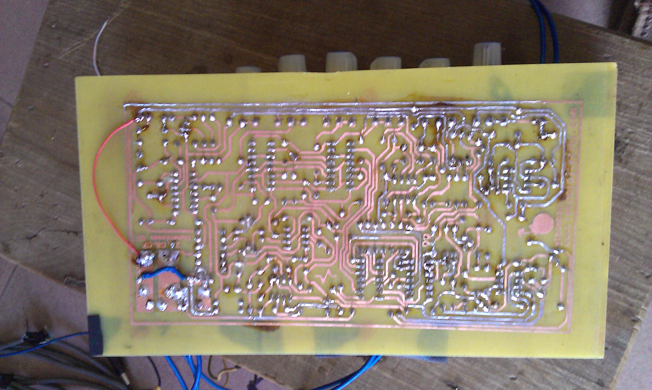

        • This is me I just finished DP, open when a voice, without a voiClick image for larger version
ID:	334564ce, is how a matter
ID:	334566This is me I just finished DP, when the power is on a voice, without a voice, is how a matter

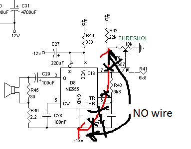

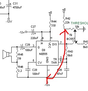

            • From the 22K resistor is connected with 555 feet first can get very good sound, without any reaction to the metal, I'm not electronic professional, where should I check, how is this going, who can help me

                • Don't pick up sound, where should I check, this PCB is right

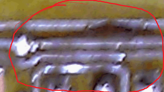

                  • Check places like this Click image for larger version
ID:	334579 for any solder bridging

                      • I checked all the solder bridging left where the line is good, the problem is that, when the power is only a voice, without any sound.
