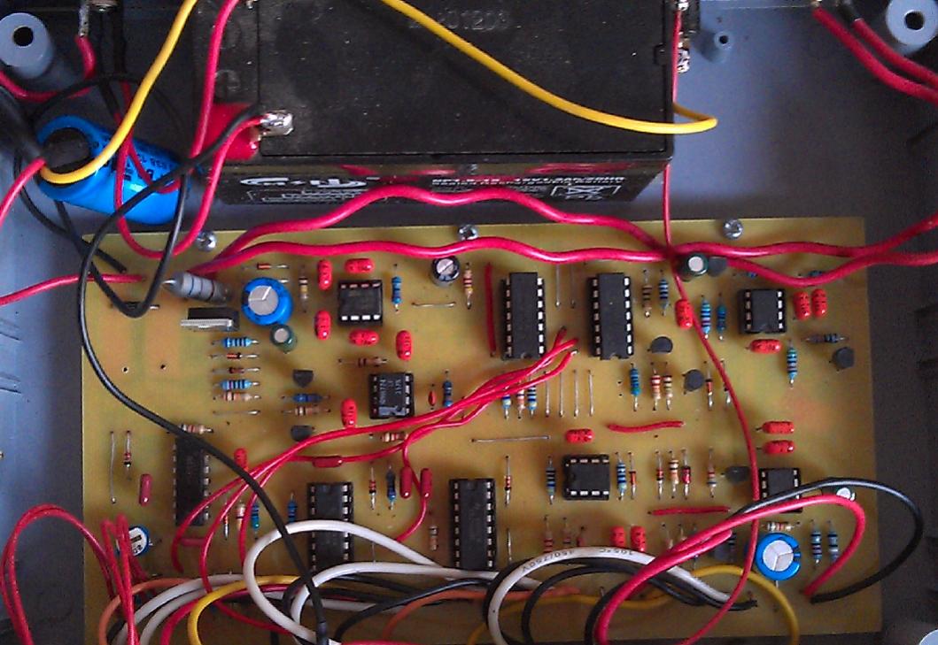

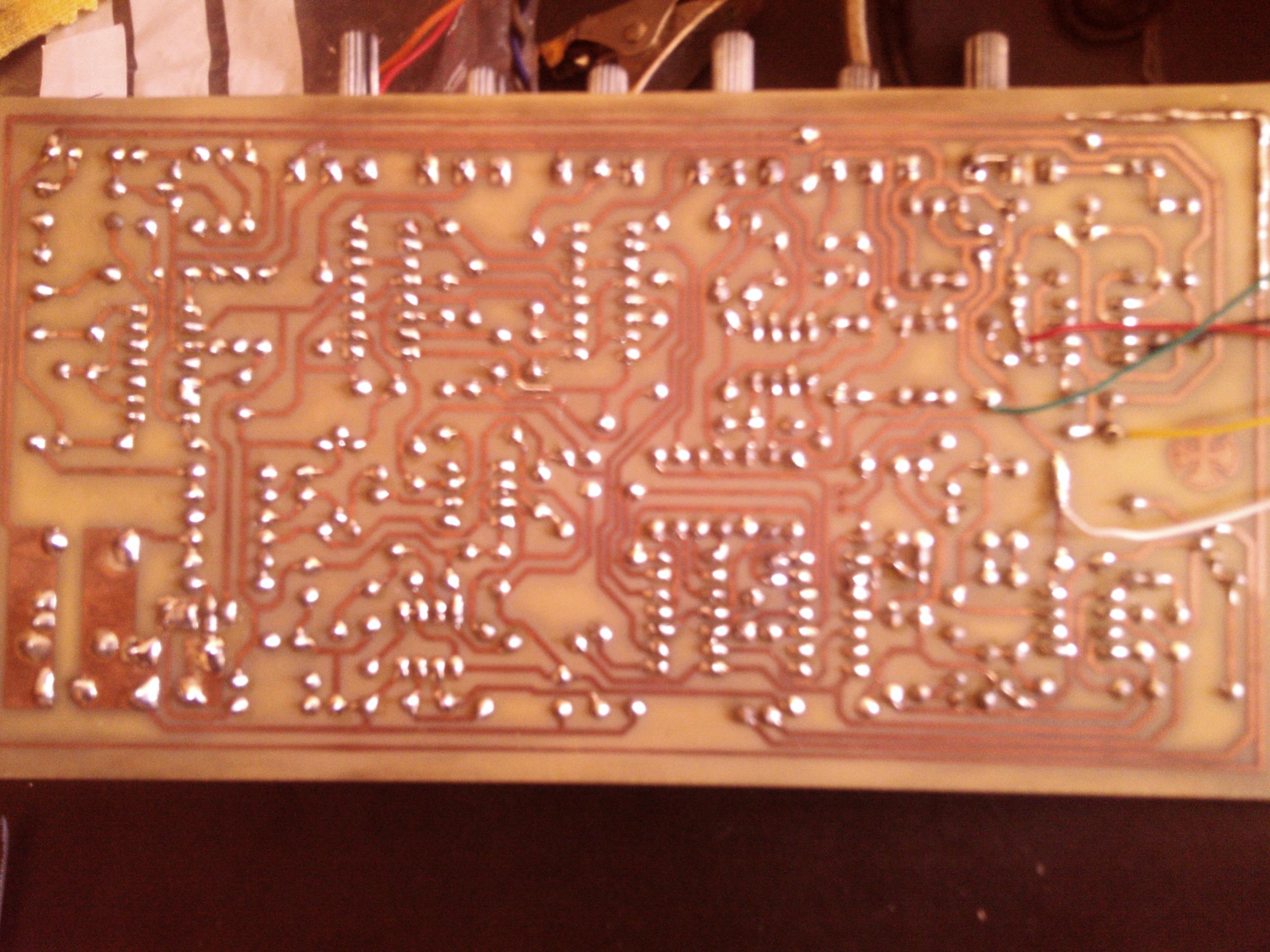

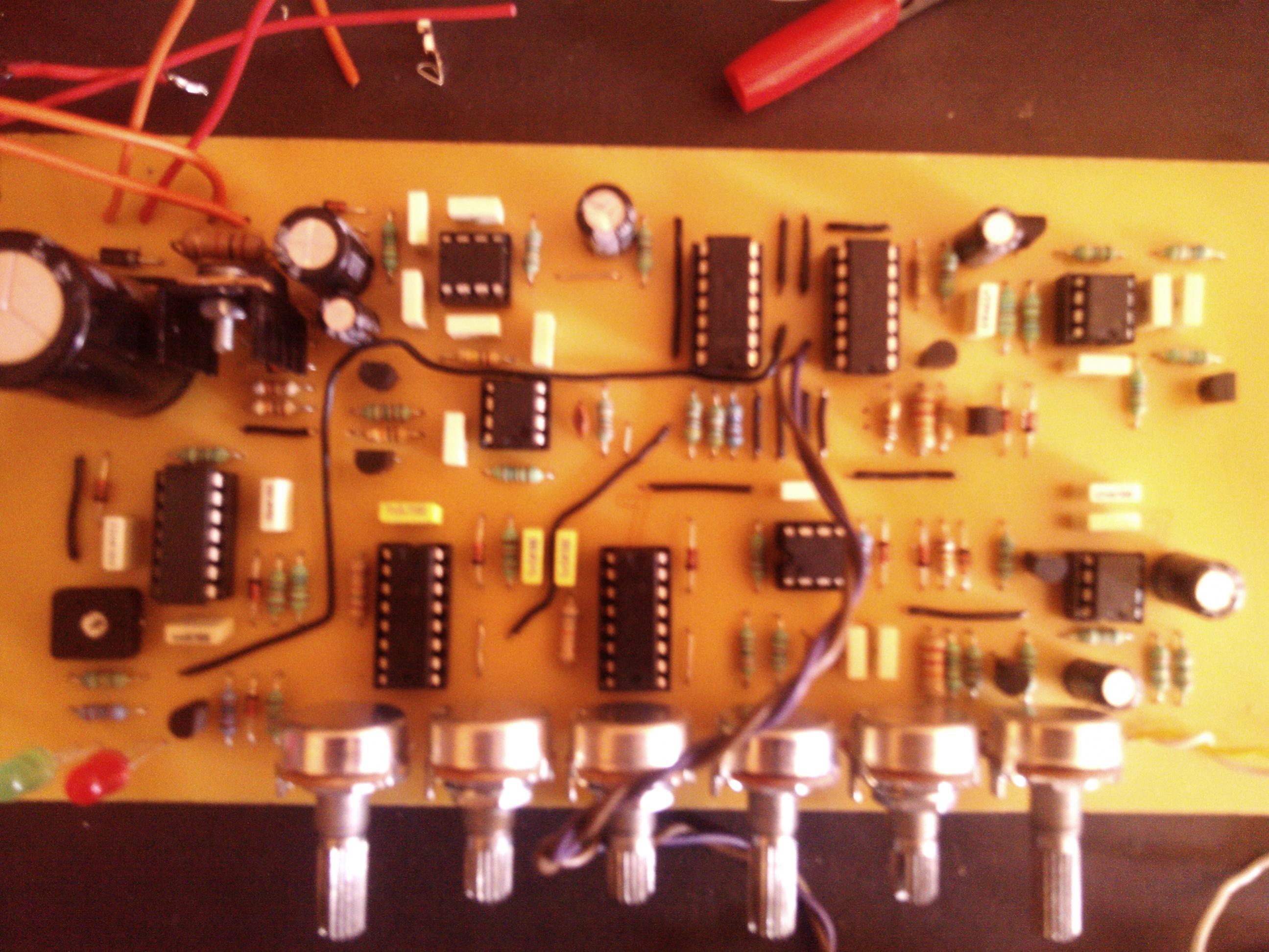

                            • I have a problem with my delta pulse pcb.The coil is 28cm 2.5ohms i detect gold ring at 23cm in air,one euro coin 25cm clear signal,coke can 45cm,paint can 57cm.
                              Detector works well except one problem and i post video of lcd together with the picture of my pcb.
                              The problem is when i turn noise pot over the first half of the whole turn for better detection the red led also brightens up and detector just beeps once then gets silent and stops detecting and irf740 starts warming, so when i turn the noise to lower again it starts working normally.
                              Also one more thing that may be important the 9v1 zener gives me 8.85v when working normally and 8.2 when this problem occurs.
                              Dumper is 1K.
                              I have looked for mistakes on my pcb but couldnt find any.
                              I gratefully hope someone on this forum can help me fix this ,here are the pics and vid. of delt working normally when noise is not high:

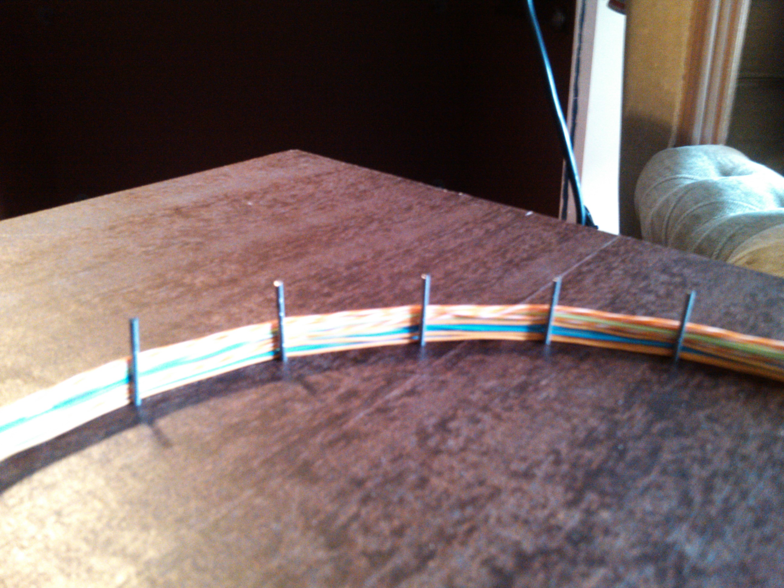

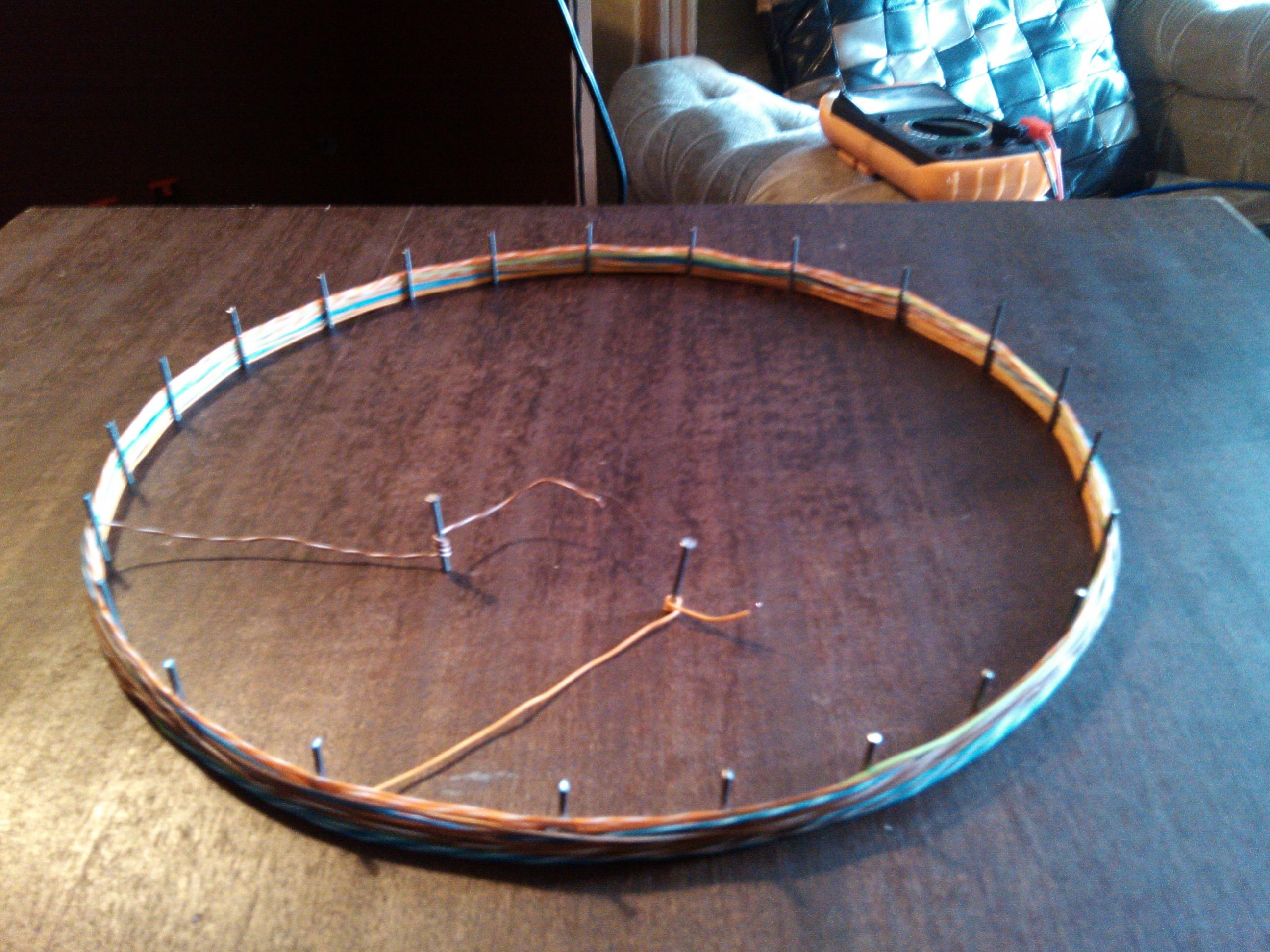

                              • hi to all
                                i made this delta pulse but dosnt work
                                i have sound , 250 hz & 19 cm coil 30 turn 0.45 with 3.4 ohm
                                i used 12v 4A for sourc capacitor
                                first i have coil with 15 turn of .45 with 2.5 ohm but when i start multimeter show 4Amper use! and
                                my red led & green led was on. i turn off fast
                                then i chang my coil to 19 cm coil 30 turn 0.45 with 3.4 ohm.
                                now my delta is on & have sound but dont sence any thing
                                i used lf357 & irfp460
                                please help me. thanks a lot
