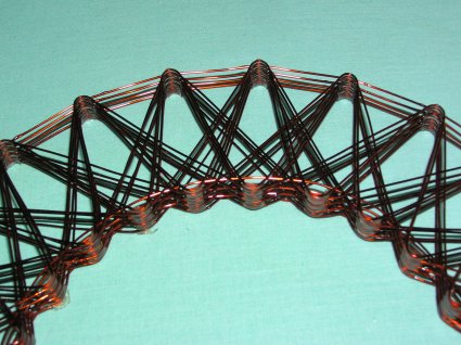

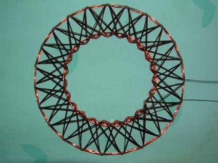

              • pancake coil
                Hi all,
                I just finished to build this coil but it doesn't work good on my DP.
                Very difficult to find an adequate value for dumping resistor, a lot of instability during work an a lot of ground effect.
                It's 25 cm in diameter with 32 turns. It developes (only) 240 µH and 1,2 ohm.
                Any comments or suggestions?
                • Originally posted by Noemio View Post
                  Hi all,
                  I just finished to build this coil but it doesn't work good on my DP....
                  Excelend work.
                  Did you try 2-3 om resistor in series with fet ?
                  Did you try up to ... 300 pulses ?
                    Hi all,
                    Very good work.
                    DP needs more inductance and biger DC resistance.
                    As an example 700... 1000 uH amd 3....4 Ohm resistance at the coil connector.
                      Hi all,
                      (Just curious) what gauge wire did you use?
                      I think your coil will have more capacitance towards the ground because your zig-zag wires add comparatively little inductance compared to the added wire length.
                      Additional parasitic parallel capacitance would cause the coil's decay curve to be relatively wide, compared to the decay curve of a coil with a more direct wire path.
                        ... your zig-zag wires add comparatively little inductance compared to the added wire length.
                        What I was trying to say, is: your wires crossing at almost 90 degrees will have their individual magnetic fields partially cancel each other.
                        Apply the Left (-or right-) Hand Rule, to visualize. Where your fingers point at each other will be magnetic field cancellation.
