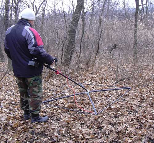

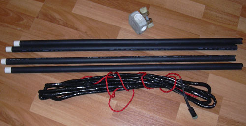

                            • Originally posted by esus View Post
                              hi kt 315
                              I've actually received an instruction uses with the sniffer very short
                              but I wanted to learn more about the realization of a square coil of 1mx1m
                              n being a connoisseur like you
                              I prefer not to commit any imprudence
                              Geo has answered my question on another post
                              I will advise you of the progress of the construction
                              especially if it works
                              cordially

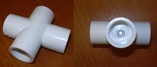

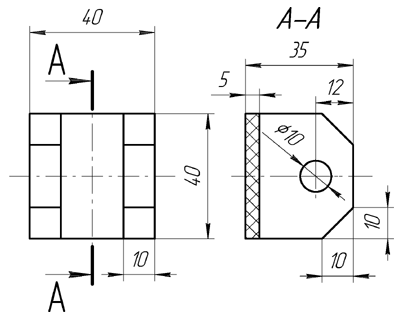

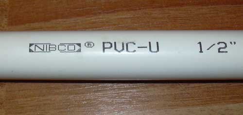

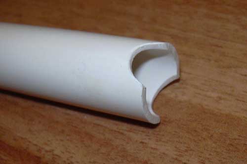

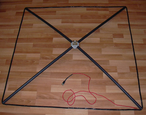

                              esus, I HAVE gave this link. why you ask me again? follow these pictures and you will build the coil
                              good luck
