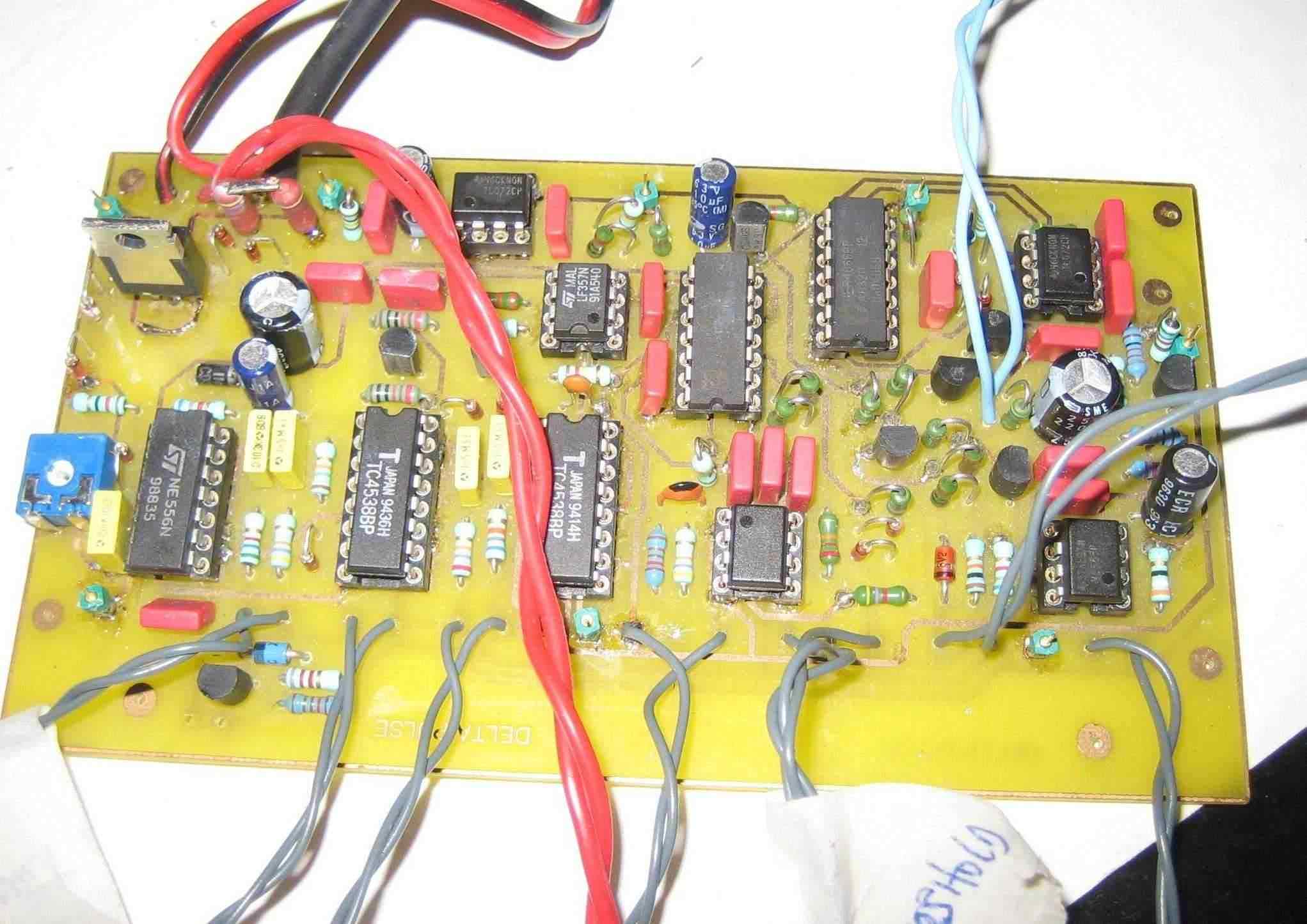

    Hi Nelson. At my DP 556 is always cold. I don't understand what to looking for it?
    • Nelson, check all the connections, but first clean very well and eliminate path of solder resin. With a magnifier see possible shortcircuit.
      • Delta pulse in sprint layout format
            :confused:
            Your 556 might be failured due previous mistake. This is oscillator setup,might be some failure arround it.First power supply and filters arround...???
            It is gonna be some job to find problem.
            I wish you luck and nervs.

              ivconic,
              You must use the one 1N4148 diode between the pin 7 and 6 of the D8.(Anode to pin 7 and kathode to pine 6)
              It can eliminate the harmonic sound.
              hope this help,

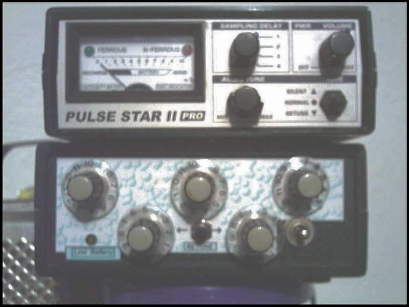

                      • BIG PSII COIL
                        Dear Ivconic,
                        You said that big coils work well for DeltaPulse and PulseStar machines. Can you give me some hints about constructing a big coil for PSII? I am most interested in making a 2m x 2m coil, such as the universal search loop. I am only a beginner :confused: interested in experimenting with coils. Below is a post I made earlier this week. Thanks for reading this.
                        Hello,
                        I own a PulseStar II, and I would like to get a larger coil, say 2m x 2m. The “Universal Coil” sold by the manufacturer appeals to me (http://www.tb-electronic.de/prodinfo/ps2/univcoil/unien.htm), but they charge over $350 for the coil. I am sure one can be built much cheaper. But first I have two questions:
                        1) Is it practical for me to try building a larger coil without access to an induction meter?
                        2) Am I likely to damage the PSII electronics if the inductance of my experimental coil is too far off?
                        I was thinking of starting with 8 meter length of 14 strand wire (metric 16/0.2) and connecting wires end-to-end until the coil performance is maximized. I would leave any unused wires free (unconnected).
                        I am not an electronics person like most of you but I like to try simple projects (but only if I am unlikely to damage the PSII electronics).
                        Thank you for this very interesting forum. I am impressed with the electronics knowledge here and willingness to share information.
                        Bob

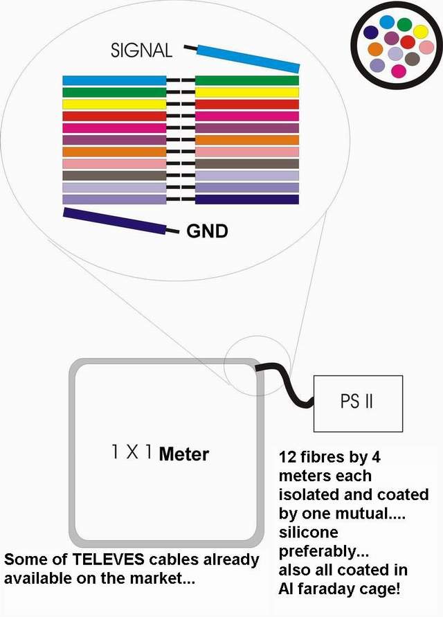

                          • My DeltaPulse
                              Hi PulseStarIIUser,
                              i will try to answer some of your question;
                              first i am posting here original setup for 1x1meter coil for PSII. This was sent to me
                              from one of my friends from Macedonia,Goce,tribute to him!
                              About 2x2meters coil...well,pretty simillar setup.I do have original 2x2m coil for PSII,
                              to tell you the truth, i had not benefit much from it so far. 45cm coil suits 90% of
                              my needs.I can agree that 1x1m coil can also be very usefull.But 2x2m coil is pretty
                              hard to deal with.It will take 2 man,large space and a lot of luck. But search yourself.
                              If you want to make it,go ahead.Resistance is 2.5 ohms including cable.
                              "1) Is it practical for me to try building a larger coil without access to an
                              induction meter?"
                              Why not? If you have accurate datas...I left without it for some time,i made a lot
                              of coils so far, mainly good ones, these days i have some problems with small coils only.
                              "2) Am I likely to damage the PSII electronics if the inductance of my experimental coil
                              is too far off?"
                              No,youre not! Do not be affraid! Just keep coil resistance over 1.9 ohms and experiment
                              freely! Some of them will work better,some of them not...
                              "I was thinking of starting with 8 meter length of 14 strand wire (metric 16/0.2) and
                              unused wires free (unconnected)."

                              Way to go DAN129 !!! Very nice pcb! Neat,clean...better than mine!
                              What are your experiences with it? Frequency? Coil datas? Depths?
