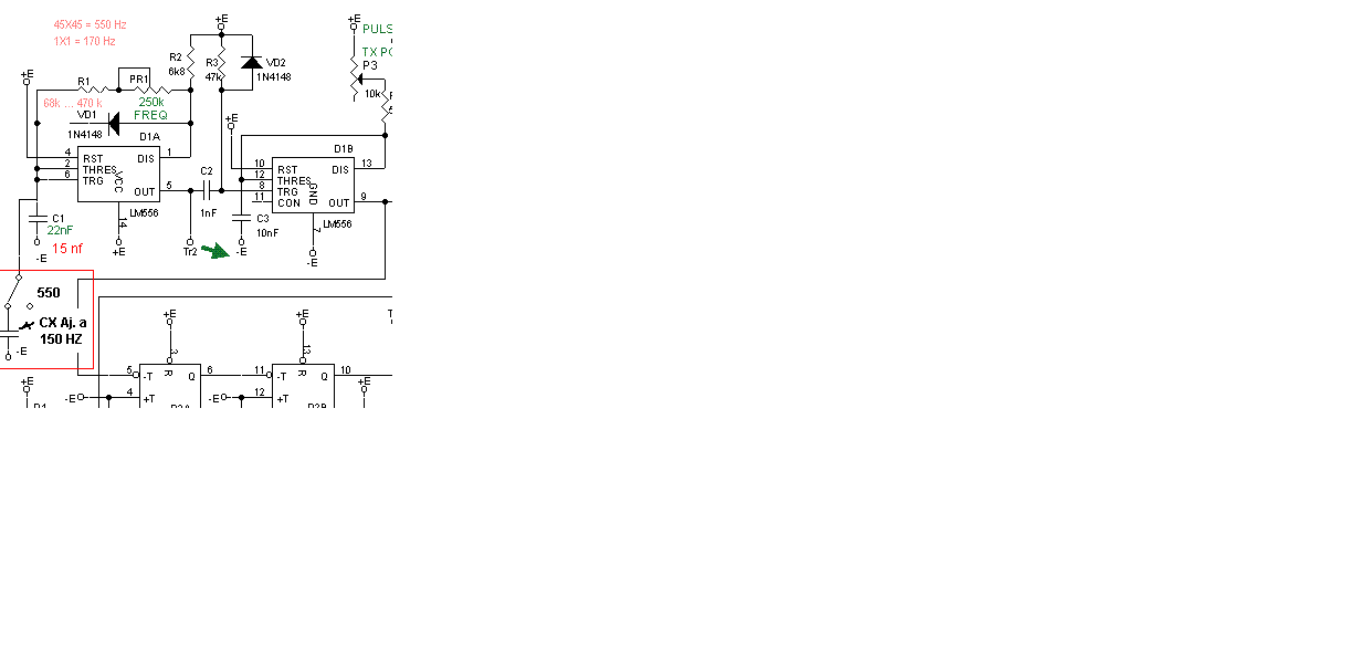

              • Ne556 was swapped in, but he did not want to vibrate. Capacitors, resistors ok, the diodes as well. The first half of the ic wibrating well, but not the 9-foot. I noticed that the potentiometer (noise) soldered was broken. That was the trouble. :-)
                I found the rotary switch. 4 x 3-position. It would be worthwhile to redesign PCB and all three rolls to make it suitable solution. The switch could switch to the lowest 28 cm, 40 cm and 100 cm search head proper configuration. Good idea? The answers found that the frequency of dumping resistor should change. This has come with a small roll, the transistor T2 collector off and a 1.5 nF capacitor 1 nF to replace. If I missed something please write. So would three and four parameters to change rolls. This switch (rotary switch) could be solved.
                http://www.hestore.hu/files/lorlin.pdf
                Bye! Gabor
                • szucs_g
                  For coils of 28 to 45 cm, I use the same frequency (400 to 550 Hz).
                  Roll 1X1 meters, I use 150 to 170 Hz
                  Place a simple switch C1, to add capacity in parallel to achieve the rate of 150 Hz.
                  Increasing the power (power control, and measure the total consumption of the DP, in alrrededor 180 to 200 mA).
                  Use different resistors inside each coil to compensate for the differences.
                  greetings, Jose
                  • Thank You!
                    28 cm coil with 550 Hz and 40 with 400?
                    With capacity can I modified the frequencies easy. (take in parallel :-) )
                    May I set up power with a fixed resistor? To 180 or 200 mA.
                    Witch dumping resistor must I use to 28 cm (550 Hz), 40 cm (400 Hz) and 1m (150 Hz) coil's? Can I measured it with multimeter or experiment, this does not warm the fet?

                      • Coils from 28 to 45 cm.
                        Use the same frequency coils 28 and 40 cm, the value determined experimentally for better performance (from 400 to 550 Hz).
                        Measure the frequency with a tester.
                        Set the pulse width (power), 100 to 150 usec. Use oscilloscope.
                        If no oscilloscope, adjust the power for a total consumption of DP between 130 and 150 mA.
                        1x1 meter coil
                        Use a frequency of 150 Hz or so. Measure the frequency with a tester, determine the value of CX experimentally.
                        Set the pulse width of 200 usec. Use oscilloscope, or measure the total current of MD at 180 to 200 mA.
                        If you respect the power values ​​mentioned, the FET should not be heated.
                        Place a higher value than normal for the damping resistance in the PCB.
                        Set this value with a resistor installed in each coil. Determine experimentally the value for best performance in each case.
                        see diagram
                        Greetings Jose
