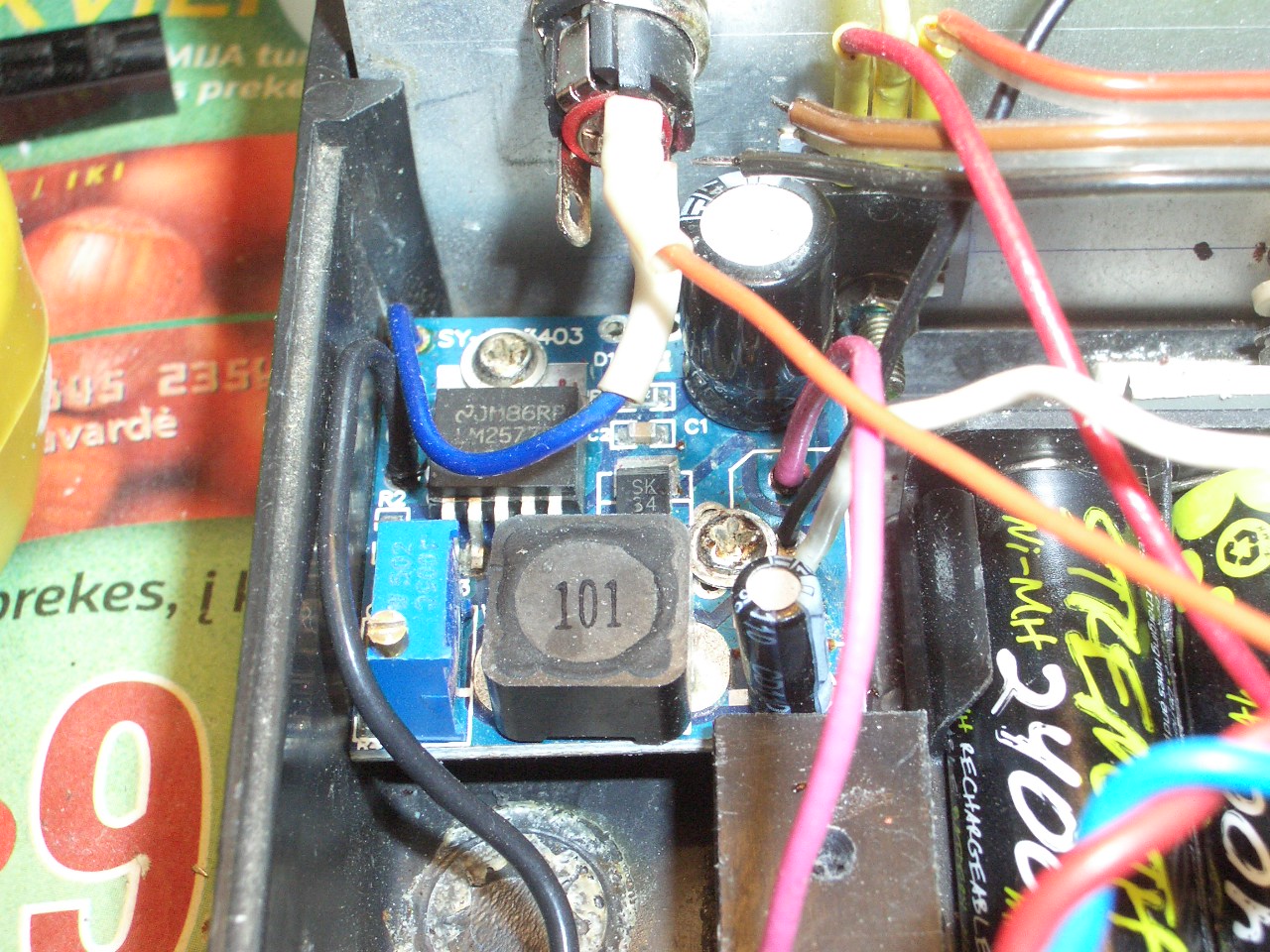

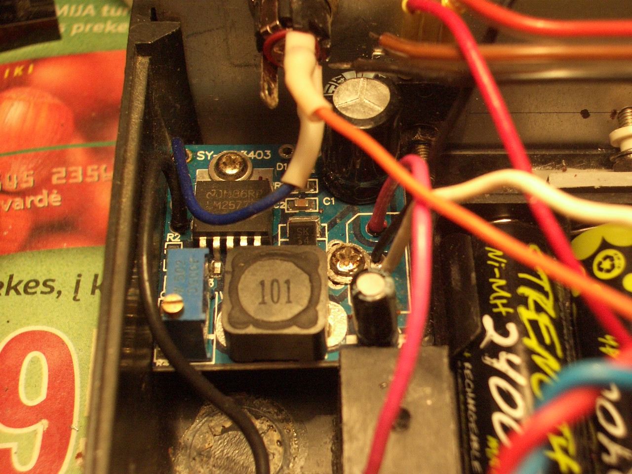

        • my last update - for more stable working I did set an impulse converter. so DP works from 8 pcs of AA type now.

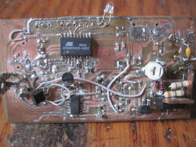

                you only will waste your time. if you will get a problem NOBODY is not be able to help you. you see yourself - people constantly ask to help, but there are NOT the effective suggestion. that is because they uses unknown PCB layot or do PCB at marrowbones.

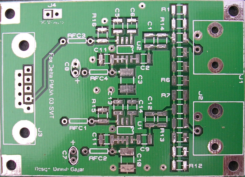

                      No, I do not. SMD is not so popular as you think. I have a huge bunch of Hammerhead PCBs in SMD, Carl Moreland has a bunch of the boards for shipping too. Nobody wishes to order the SMD. Although I plan redesign Bounty Hunter IV, it is SMD board. nice schematic with a potential, IMO.

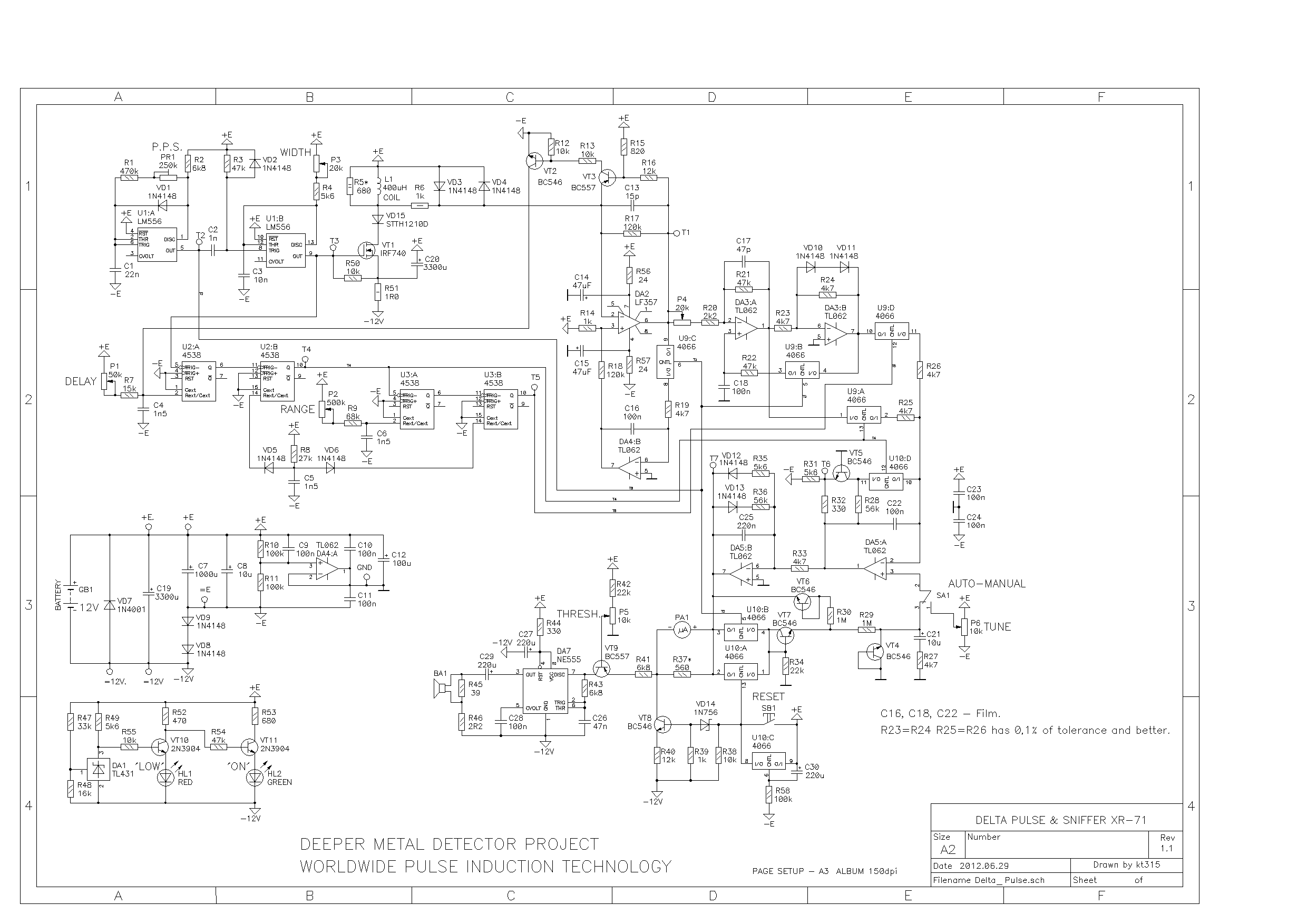

                            • Hello Kt315,
                              Thanks for nice schematic ! and al your other info..
