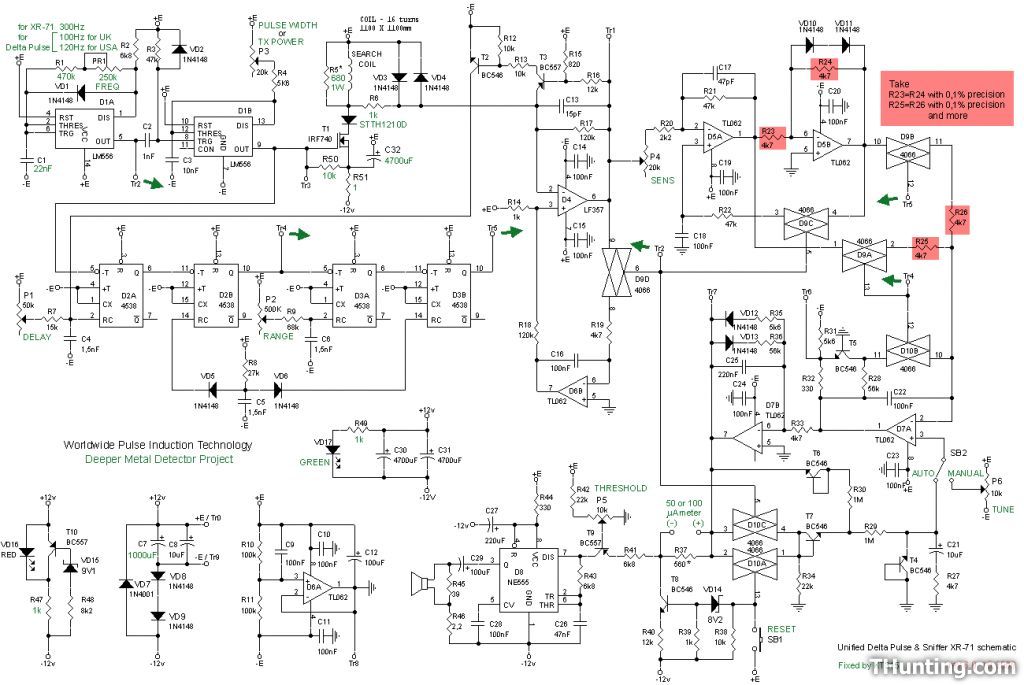

        ST TH1210D is specialty diode for T1 [IRF740]
        Ahhh i see is a substitute for irf740 or the other way..case closed

          I'm glad I asked but I'm still a little bit confused.
          Maybe the FR diode is not meant to replace the IRF740 but is suggested to be placed across the IRF740 to help reduce the flyback time?
          Just a guess.
          Think about it - you simply cannot replace the IRF740 with a diode. No how, no way. Or, at least I don't think so. But, putting a FR diode (in reverse) in parallel from source to drain would help reduce flyback time. IRF740 already has a reverse connected diode from S to D. Adding an FR diode would speed things up a little bit.
          Even better might be to use a MOSFET that already has FR diode. I know of only one such MOSFET at this time, but I am sure there must be others.
          I found this only by accident:
          STF12NM50ND has FR diode: http://www.st.com/stonline/products/...e/ds/14936.pdf
          STF12NM50N has a slower diode but is, apparently, otherwise identical:
          I am interested in the FR diode version but unfortunately the TO220 package is not stocked by my favorite distributer, only Dpak or DDpak are stocked. I will search some more when I get time, or maybe try the DDpak in my project (if it ever gets to that stage of completion).
          Without having the exact diagram to go along with the parts list you posted I don't know where two of the 4700uF capacitors go. I can only find one 4700uF on my DP schematic. Maybe they are all supposed to be in parallel, which would provide 3x the filtering; a very good idea.
          Here is a link to the STTH1210D. http://www.st.com/stonline/products/...4/stth1210.pdf
          tuxnor, what you are probably wanting to do is stick to the original DP schematic but add one FR diode across the IRF740, and add two 4700uf capacitors across the one that's already there. (?!) Be sure and connect the FR diode in reverse, or else it will muck things up and won't last very long.

                THANKS..youre all right ..not a replacement for irf740 and i also found schema at last

                  • Originally posted by tuxnor View Post
                    at last STT diode shown up ,,but 4700 uf c32
                    That is a more usual place for the FR diode (instead of being in parallel). I had an argument earlier in this thread where I tried to prove that adding an FR diode in series (as shown in your schematic) would improve the flyback time in the Deltapulse.
                    I don't recall having won that argument, but that would not stop me. I would still use a series diode because I believe you will see a faster time for your flyback voltage to decay to an acceptable level for sampling. I think that the optimum value of damping resistor will be different depending on whether or not you use the series diode. That will depend on your coil and would need to be determined experimentally.
                    On another note, just today I looked at what might happen if an FR diode were placed (in reverse) ACROSS the IRF740, and it does not look like a good idea because it does not seem to make the decay happen more quickly. Don't do that. Now, maybe if a MOSFET with an intrinsic FR diode were used it would be an improvement over a MOSFET with a standard zener, but that is a whole new ball game and I won't say another word about it. I have added too much confusion already.

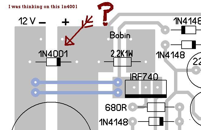

                      Hmm,,is it 1n4001 ? they have added as substitute for stth ?or like this?
                        No! You must realize that by using the IRF740 the circuit will usually have a peak voltage close to 400V. That would destroy the 1N4001 very quickly. You also have peak current somewhere around 2~3 amps depending on your pulse width and coil. That also eliminates other 1N4001 series devices. Don't be cheap, or else you will blow something up! Also, soft recovery is recommended in addition to being fast.

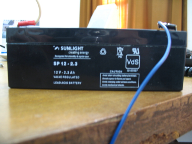

                        • Battery problem
                          I wl'd to ask if this battery is better for DELTA PULSE and i wl'd to ask why i can test if my battery is ok or not (It decharge rapidly)
                          thank's

                              • 1n4001
                                have they used this 1n4001 as a substitute for stth diode ??
