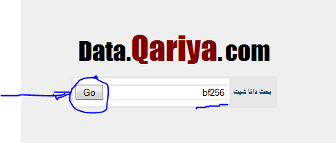

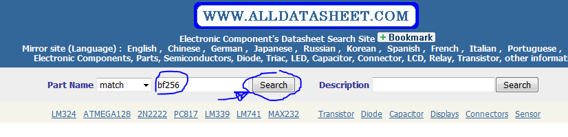

    • Originally posted by Nicolas View Post
      Look it Mohandes you can search for every component datasheet
      http://www.qariya.com/electronics/datasheet.htm
      http://www.alldatasheet.com
      thanks nicolas
      i search in google

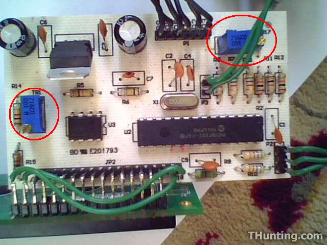

      • Hy!
        Could you tell me everbody what is a function these potmeters?

        • Originally posted by Attilawap View Post
          Hy!
          [ATTACH]27352[/ATTACH]
          Hi look this video you can understanding
          They are for the calibration and discrimination. Value 10k
