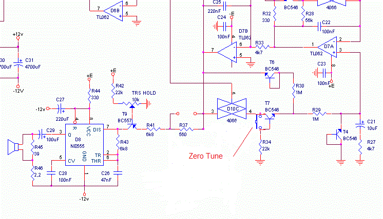

          • Hello Great Alex
            if i place a metal near coils the signal increase rapidly then the signals fade out and the device become retune itself ( i still have the peice of metal near the coil and the signal fade out) , it's like auto tracking mode !!
            first of all is it normal or my DP has a problem , any body has a video of DP when a metal object remain in a fix distance to DP coil ?
            and this auto tracking make the detector response very weak on deep targets cause it's speed is very high . i built a switch between T7 and R29 for this problem but i need changing it speed not to remove auto tracking at all.
            the description the previous paragraph is normal in the operation of the Pulse Delta, and corresponds the "automatic mode."
            You can try the "manual mode", then the Delta Pulse behavior is similar to other MD PI.

              • Hi Jose
                changing R27 or C21 changes the auto tracking time but it change the metal detector max depth according by my tests .
                i think the soloution must be at T7 (Maybe)

                • Hello Grat_Alex
                  Experimenting with different values ​​of C21 get: Quick Response with less capacity but unstable.
                  Slow response with increased capacity, but always with the same sensitivity once stabilized.
                  Damping resistance, Coil decompensated or poorly detector setting, you can create erratic operation of "automatic mode."

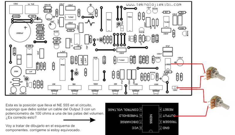

                  • Hola José, te va la imagen
                    corrigeme si estoy equivocado, por favor... puedes dirigirte a mi persona en el siguiente email: [email protected]
                    gracias y mañana informo resultados
                    Great Alex and Jose
                    This is the position that takes NE 555 in the circuit, I suppose that I must weld a cable of Output 3 with a potentiometer of 100 ohms to one of the legs of the volume.
                    He is correct this?
                    I am going to try to draw it in the scheme of
                    components. to correct if I am mistaken.
                    they flow I inform broken results on diodes or resistance
                    for your help me, thanks my friends
                    Heriberto
                    • Hola Betobrambi
                      No hay que agregar nada de los componentes ya existentes en su PCB, solamente hay que controlar.
                      Suguiero controlar la salida del 555 (pata 3) y el control de volumen, por ser elementos que corresponden a la etapa de sonido.
                      No need to add anything to the existing components on the PCB, but must be controlled.
                      Suggest a package to control the release of 555 (leg 3) and volume control are elements that correspond to the sound stage.
                      Jose
                      • Hola jose
                        nada útil se encuentra en la página n º 37?!
                        pero gracias de todos modos
                        I disconnect T7 B and C legs
                        the result is amazing :
                        reset works amazing it's works realy like Reset now!
                        speed of autotracking reduced and it can detect deep in auto mode

                              • Hi Great_Alex
                                Thanks for this Mod
                                In the original project, the audio fade when the coil remains stationary on a detected object.
                                This improves the work of MD in mineralized soil? What is your opinion.
                                Meet some mod to increase profit?
