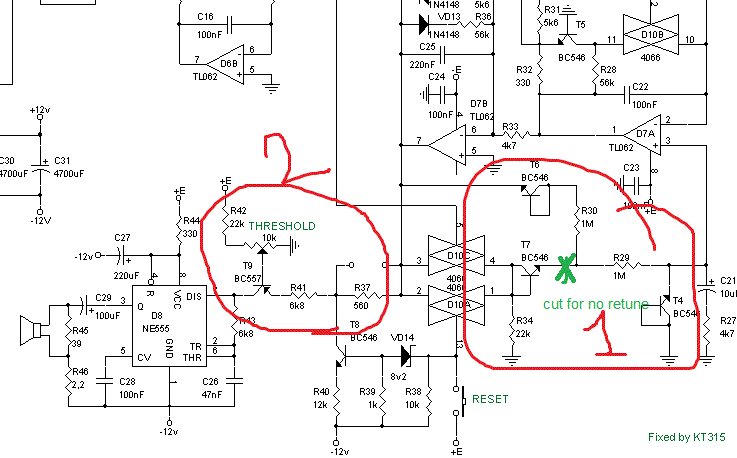

                    • Hi KT315 & all Delta Pulsers
                      I think response time of Delta pulse is normal and no need to change
                      I built 2 delta pulse with single sided pcb , both of them works the same
                      maybe my DPs not works good they work like motion detectors ?!!
                      if i place a metal near coils the signal increase rapidly then the signals fade out and the device become retune itself ( i still have the peice of metal near the coil and the signal fade out) , it's like auto tracking mode !!
                      first of all is it normal or my DP has a problem , any body has a video of DP when a metal object remain in a fix distance to DP coil ?
                      and this auto tracking make the detector response very weak on deep targets cause it's speed is very high . i built a switch between T7 and R29 for this problem but i need changing it speed not to remove auto tracking at all.
                      best regards
                      • Hi Great Alex
                        The operation of the delta pulse is normal, as you describe.
                        You can try changing the value of C21 to vary the response time, I think it is better not to touch.
                        I try to manual mode, for continuous tone about the detected object.
                        Regards Jose

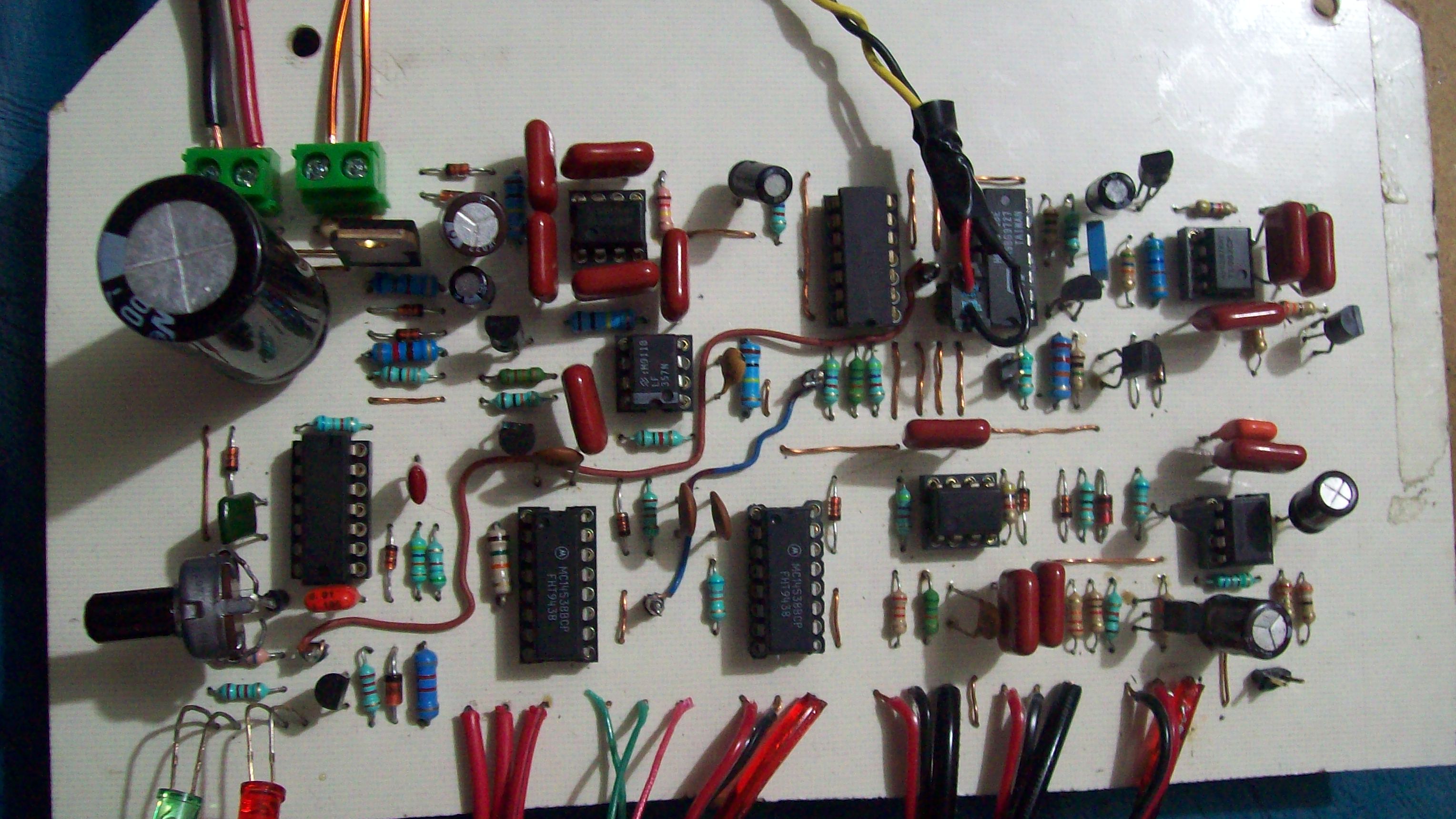

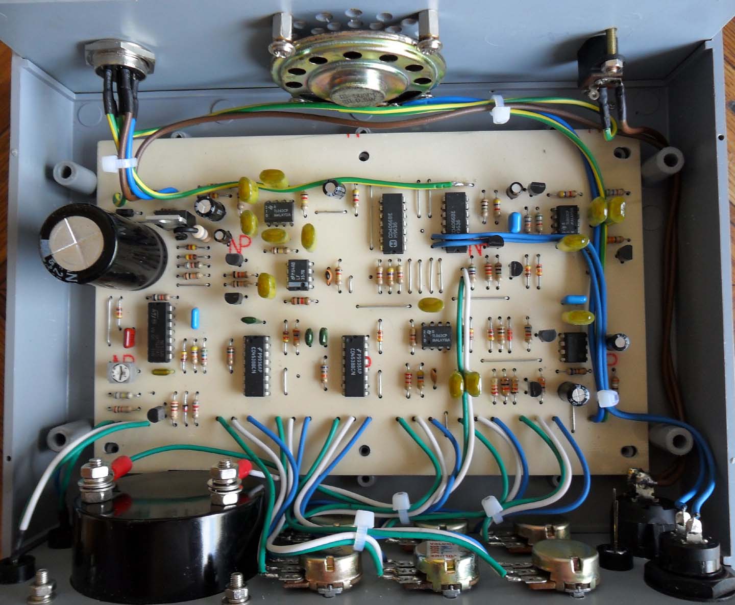

                          • amigos
                            the greatest photo, of nF red is my work…
                            There is not no sound, illuminate leds either…
                            Which is the error?
                            I am not expert, but I am learning with you. It is my second Delta Pulse that I construct friendly Thanks for the aid
                            Heriberto
                            • my friends, info for your's
                              my friendly, I want to inform that I solved to the problem of the lights leds…
                              but now, the green LED (remains caught and it does not go out…
                              green LED must be caught all along?
                              I changed tl 062 and lm 555… in 2 occasions.
                              not yet there is sound… I changed could help?
                              thanks to read
                              best regards
                              Heriberto
                              • Hello Betobrambi
                                Green LED should light all the time.
                                Sound, controlled from Pin 3 of the 555 to 1K pot (volume control) and connection to the speaker.
                                Regards, Jose
