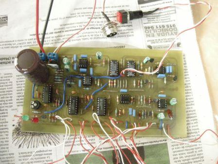

  • Hola a todos, hace un tiempo he terminado mi delta pulse, pero por la razón que sea, cuando lo enciendo está todo el rato pitando como si estuviese detectando un blanco superficial. No se lo que ocurre, el ground balance no pueo bajarlo y cuando subo el noise se calienta la resistencia R6 ( 680 Ohmios) y el IRF 740.
    He revisado todo y aparentemente está todo bien. Solo consigo ajustar el ground balance cuando bajo de tensión la batería ( reóstato), pero en ese caso no detecto nada en la bobina.
    La bobina es de 40x40 cms. con una resistencia de 4,3 Ohmios.

    • The imagen...
      • Hello Draco
        Excuse the delay in replying, I measured the voltage -E / TR9, check VD8 and VD9) if there are open.
        Check +E and -E between 1 and 8, 1 and 4 of D6A (+5. Xx and-5.xx volts) Smaller P3 control not to overheat the IRF740
        Best wishes

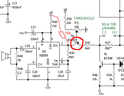

            Hi, can anyone help me detecting an audio fail on a delta pulse.
            I cheked IRF 740 gate, pin 1 of TL 062, the coli signal, pots signals, and frequency that is 120 hz, and all are working fine, but sound does not come thru the speaker or headphones anymore
            This delta pulse is of a friend of mine, who pass it to me to try to repair the detector.
            So now i need wher to look for.
            In advance many thanks
            Nelson
            • Nelson,
              stay o-scope probe in R37-R41 point. you must see some slightly negative noised level. if you bring a metal over the coil coil you must see INCREASE voltage level in the point. it is normal working state of DP.

                    • you must see a DC level.
                      • Ok i got the picture, but my question is , what componente should i check if there is no DC level?
                        On my test, the detector is working, but it has no audio. I replace 555 and the same thing.
                        Also i found the base of bc 557 that goes to threshold, unsolder, so i m thinking that may be this transistor is burn. What do you think. The transistor was solder, but still no sound.
                        In advance many thanks kt315.
                        kind regards
                        Nelson
                        • may be you have not 2 and 6 pins connected?
                          it is VERY oldest matter to say again and again to read forum... desolder T9 off, connect pin 7 via a resistor on +E=+12V. you must get a sound.
                          • You mean to remove from PCB T9 and then connect pin 7 of 555 to +12V via 10K resistor?
                            And what about threshold?
                            Sorry, but my english and electronics knolegment is very basic.
                            Nelson
