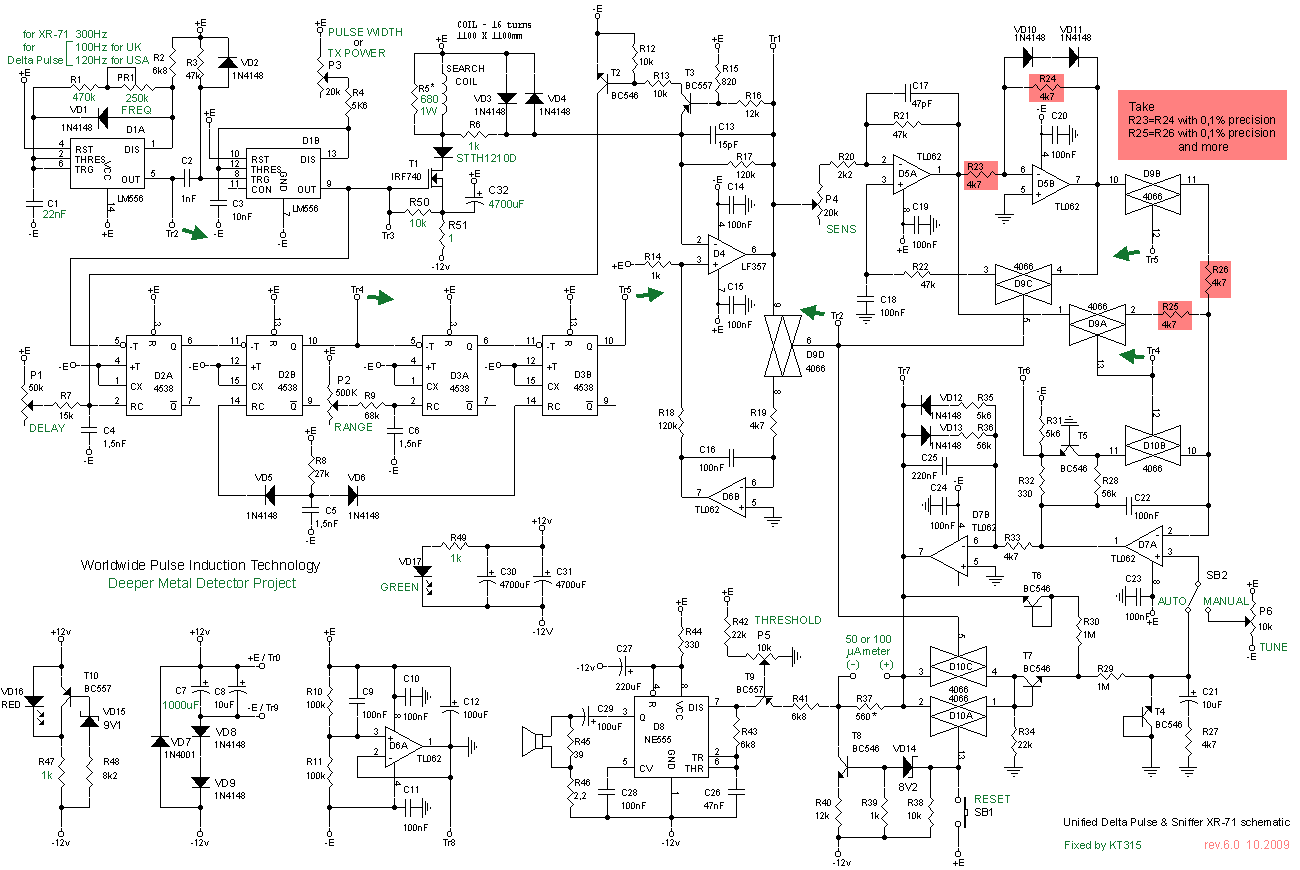

    • precision resistors color code
      http://www.resistor-color-code.com/color-code-chart
      Violet 7 7 7 10M 0.1% 5 ppm
      you see - they are EXISTING! not 10%, not 5%, not 1%! but 0,1%!
      0,1%

              • done special schematic for Persian people.
                    thanks for help with my current configuration i detect coin at 15 cm only i will tay to find resistor with 0.1 %precision

                    • hi
                      for all how make sample side pcb by elbombacı i found a little mistake mentioned by hl54 p 19 (8.2v missed) i guess after making this jimper your detector will be more sensitive i will poste result wen i return at home

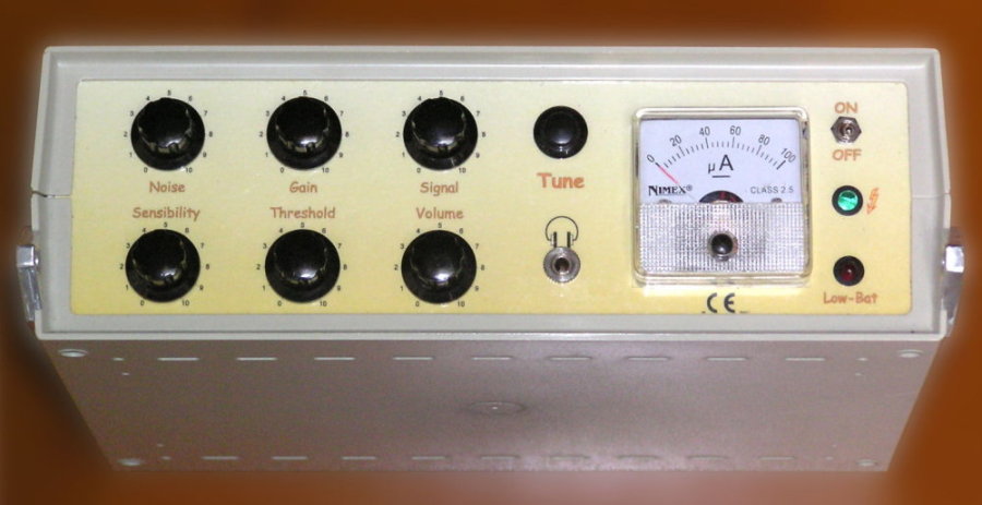

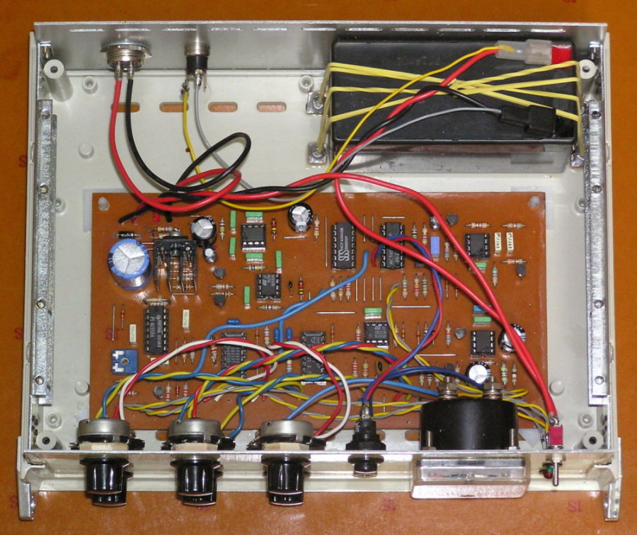

                          • Is born!
                            Is actually the second ‘cause the first was an experiment.
                            I made the coil according to the indications of bbsailor but I used telephone wire covered with polyethylene which has a dielectric constant very similar to Teflon but is more easily found.
                            The container has both the front panel that the base aluminum and this caused a problem when through the headphone jack these were connected to ground. The metal detector was very unstable, singing like a canary, especially touching the cable (RG 59) and the front or rear panel.
                            For now produced about 3.5 euros in its first hour of work on the beach ...

                              • Hello Noemio
                                Try the following
                                To ground the front panel and aluminum rear (+).
                                RG59 mesh must be connected to ground (+).
                                Shorten and twist the conductors between the plate and the connector of the coil
                                Saludos, Jose
