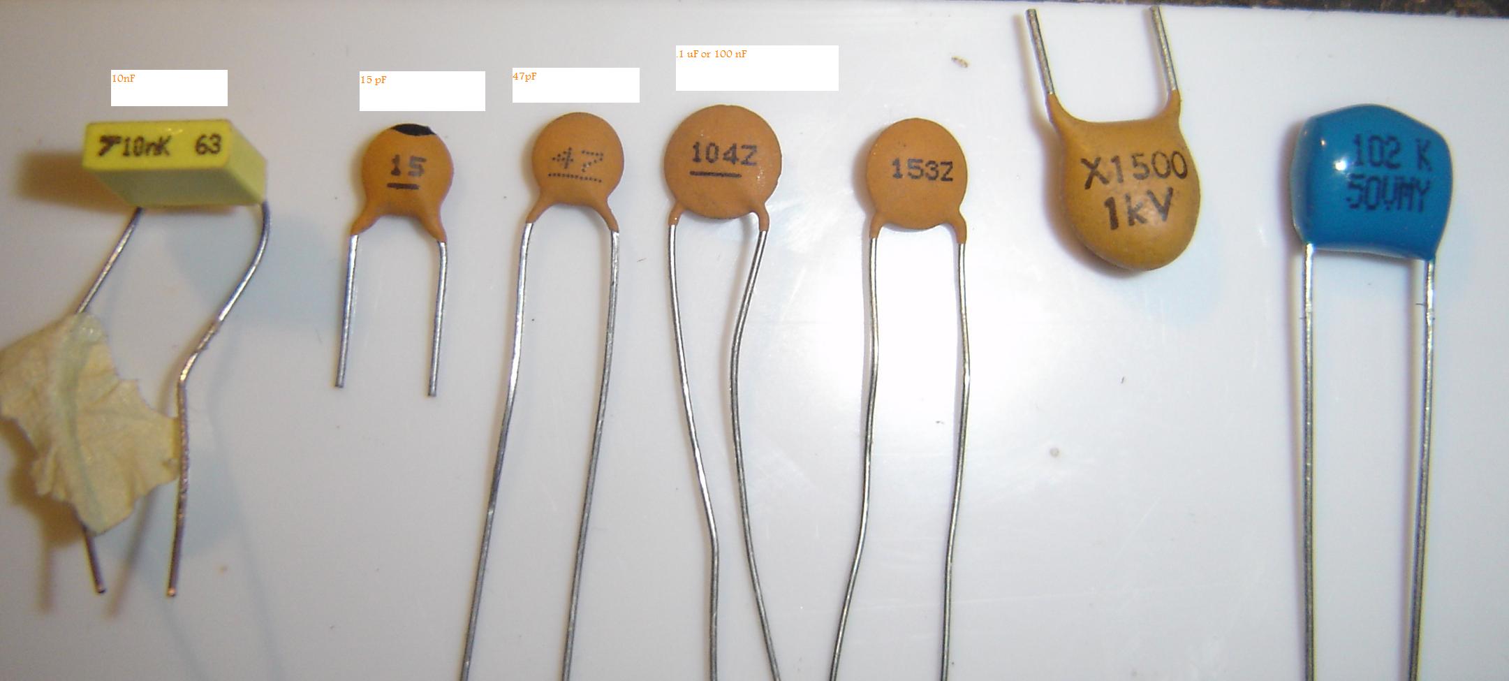

                • hi
                  can you help me to determinate the value an referance of this part im confused
                  thanx br!
                  • Here you go!

                        • Originally posted by salim View Post
                          hi
                          thanx br!
                          last 3 are:
                          15nF (or 0.015uF or 15000pF)
                          1.5nF (or 0.0015uF or 1500pF)
                          1nF (or 0.001uF or 1000pF)
