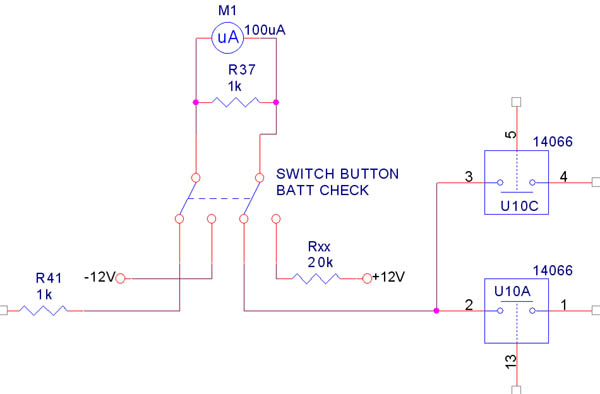

        just a little problem: I've not been able to find a 100 µA meter. The one I found is about 150-180 µA.
        What should I do to use it to full scale?
        Could be a good idea to have a higer value for R37? Or a lower value for R40?
        Thank You in advance

          Noemio, yes, lowering R37 is probably the best way to adapt a 150 or 180ua meter. Here is where someone else looked for help with the same problem (ain't no big deal):

            to add R37 value. for example I use 1kOhm with 100 uA meter. no need to change R40, it sets a current in time you push RESET. only on this moment.
              KT315 is right, I had it backwards. Raise R37 to allow more current for the meter.

                • I also have released this circuit for speedy battery check. one still pushbutton was been added on panel.
                  good luck

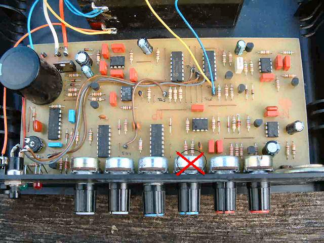

                  • Hi to Delta Pulse experts.
                    I had build my fourth DP, but now i have the following problem.
                    My DP sems to work at inverse. How?
                    Well everytime i pass a metal in front of the coil, while the detector is emiting a sound, the metal stops the sound, and when i place the metal away from the coil, the sound begins. Then if i place the metal close to the coil again, the sound stops. Looks that this is working at inverse.
                    I hope you can understand my english, so please let me know what can be the problem.
                    Ohhh, i also replace all IC´s and same thing
                    Nelson
                    • Hello Nelson
                      Please check GAİN pot tunning connections .
                      Erol

                        • Hello
                          I attached picture of it .
                          You can look photos
                          check soldering of gain.
                          I faced same problem and I saw there are a break on gain connection.
                          Erol
                          • Many thanks Ero. This afternoon i ll chek it.
                            Nelson
