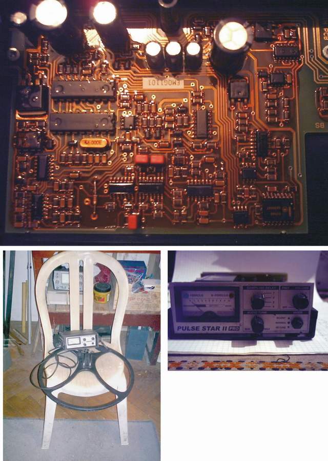

              • pulse star has TWO levels of protection from coping:
                - Black Box way. epoxy-encapsulated block with PCB's you are not able to open without full damage it.
                - two PIC chips with code protection.
                you even have NOT ABSOLIUTELY a chance to learn pulse star. we say about OPEN project here, DP is of.
                  I had version without "black box" on service. Not an issue.
                  But real issue are those 2 PIC's ! Protected!
                  • I suspected PS is without Black Box, PS-II with it. or I am not right?
                    • No i had PSII Pro. It is without black box.
                      Wait...i will find some photos...
                      • Yes it was PSII Pro..
