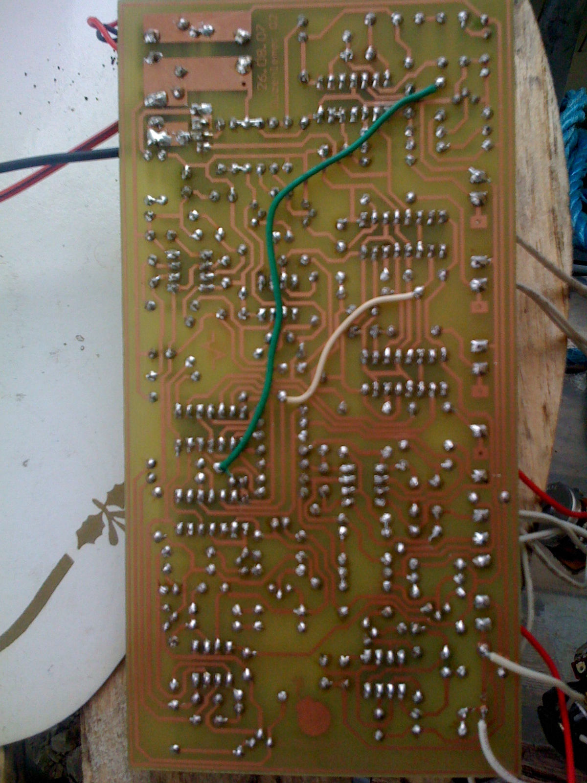

      built delta pulse, with my own designed schematic and PCB.
      I do not see advantages in your design. for me always is very strange a people waste a time on new layout when the first oldie design is good tracing, comfortable, working, not be troubleshooting. certainly this your right to do what you want. but...
      Delta Pulse is not design for RE-tracing, for waste time on fixing, tuning, etc! REMEMBER THIS GUYS! only follow comments what we write here and all! you must get the working device outright on a moment you first turn it on!
      I do not present an electronic skill you have... I hope still you has conducted all points 'Tr2, 4, 5' from left part to right according the schematic...
      I don't know what's your purpose with this post, maybe the PCB designing in such system doesn't demonstrate the rule of PCB in circuit operation, but in practical, high frequency, noisy or industrial systems you can see that your design will not work only because of lack of attention to PCB and its rules. surely one good PCB designing, will have some consequences to better and stable operation.
      OK, forget it, thank you for your note. maybe I wasted my time as you mentioned.
      about this circuit, I found one mistake in soldering, I had soldered one transistor instead of other one , I changed it.
      Now when I turn ON the circuit, the speaker sounds and meter acts, but after 1-2 seconds it goes to normal situation (meter=0 and speaker=silent), but I can't see any reaction to metal,
      some adjustments needed? or one problem again?
      as I mentioned before, it seems that the PCB which is made in forum is not really routed by the introduced schematic. it seems it has some differences with the schematic.
      You can help me a lot by some circuit critical voltages, like Mosfet gate, transitor pins and ....

        Hesamavr , Don’t disappoint . delta pulse circuit is correct . The last revision
        Uploaded by KT 315 . you built nice circuit board. Try check it with oscilloscope
        section to section .

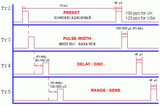

        • aft is right. there are not differencies. the schematic is clear, oldie first one from Bulgarian is also clear. use o-scope diagram, it is enough. note - there are NOT TUNING POTS, except for frequency.

                  • i made some quick measurement with my scope (child toy ) and i have diferent timming diagram, than posted here. I have the latest schematics without fast diode. T2 was over 100uS and T3 only +- from 80uS to 300uS. I change C1 for 15nF and C2 for 22nF. T2 goes down to about 80Us and T3 to 100 - 500 uS. I must borrow better scope Now, a paint spray in 1 meter

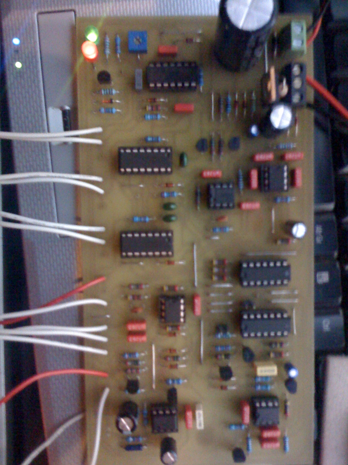

                      i made my deltapulse singelsided pcb..and it works great..i use a detectorpro headhunter coil..its 1200 uh and 8 ohm..

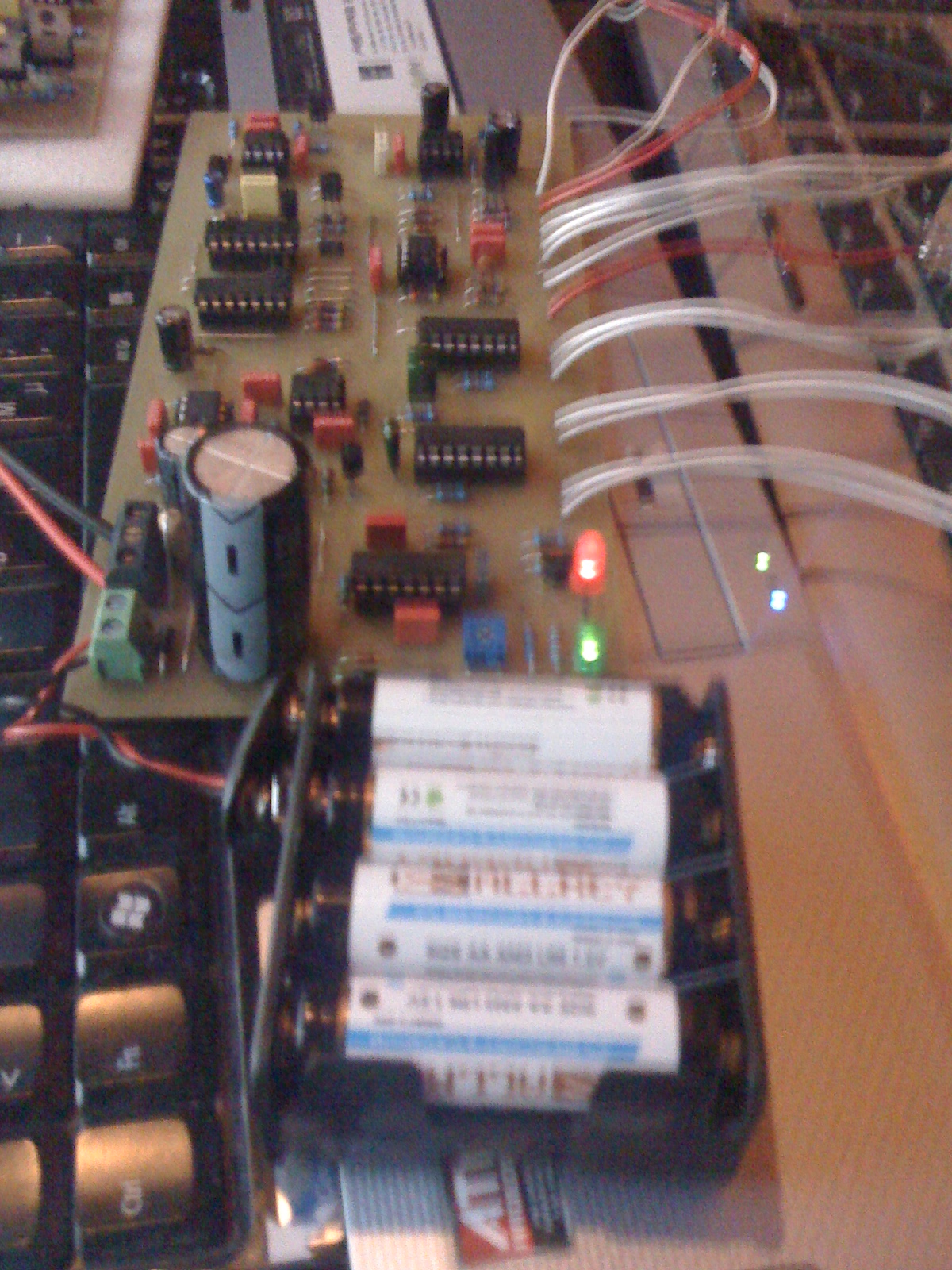

                      • working yesss
                        that picture was with bad battery..putted on new and it works great..
                        yes eaven with old batt..nothing gets warm and its stabil..
                        i am a happy man now...i love this deltapulse...

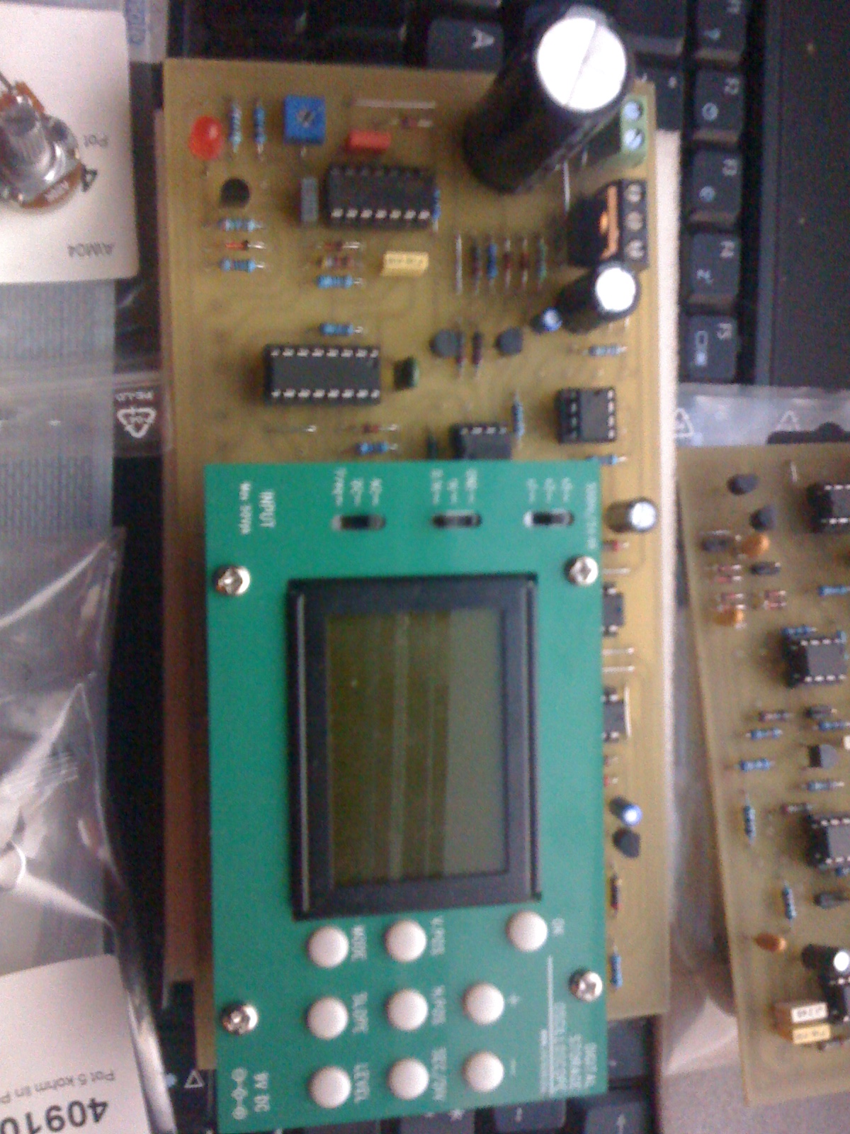

                        • test..
                          i used mylar cap for 1.5 nf c4,c5.,c6 . cheramic plate cap for C17 47pF and c13 15pf.
                          All other caps is poly ,,for me Wima 100nf MKS2 caps worked good here
                          new battery and gave it 12v today,,tested and play with it this eavning,,yes its stabil and sensitive
                          i used 100 ohm resistor for volume untill i get my hands on a 100ohm pot.
                          all resistors used is 1% and not the cheapest
                          Power on for 15 minute .nothing get warm.nothing smells xi xi..and stabile
                          i used cd4538bcn and cd4066be , Lf357 , tl062 and (ne556n instead of lm556)
                          its super sensitive...0.6w for 680r by the irf740 and 2.2k 1w for paralell bobin coil
                          tested in 30 min now ..seems to be better and better nothing is heating and its stabil.

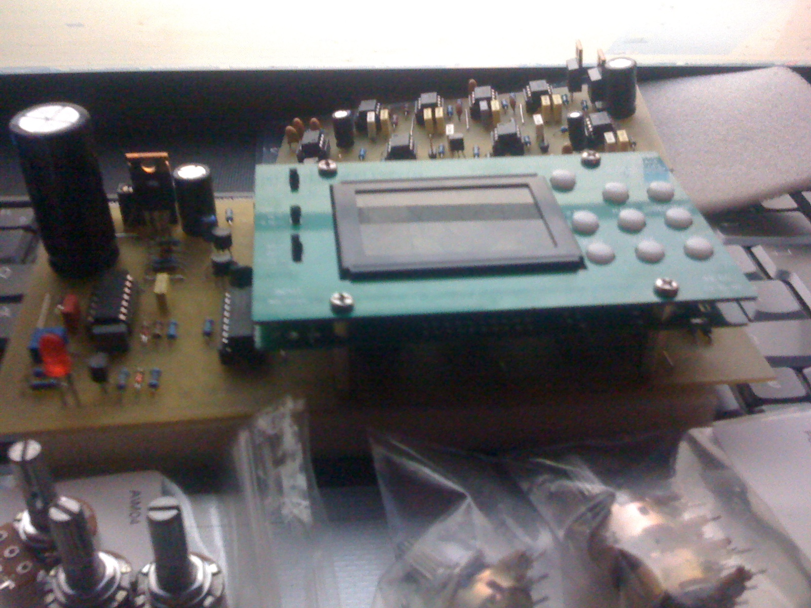

                          Detector turned out to be just great..Thanks to designer on singelside pcb delta pulse... i love it
                          sorry for bad pictures...but thats is all my i-phone can do..no good cam
                          Adding a ociliscope to deltapulse ..lol
                          easy to build
