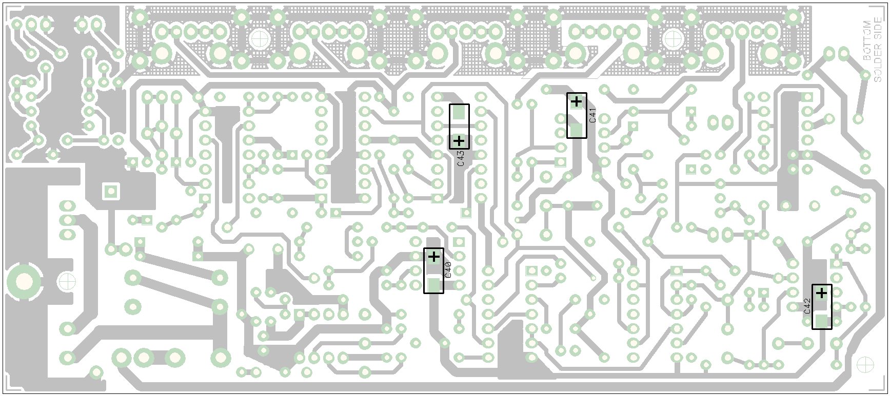

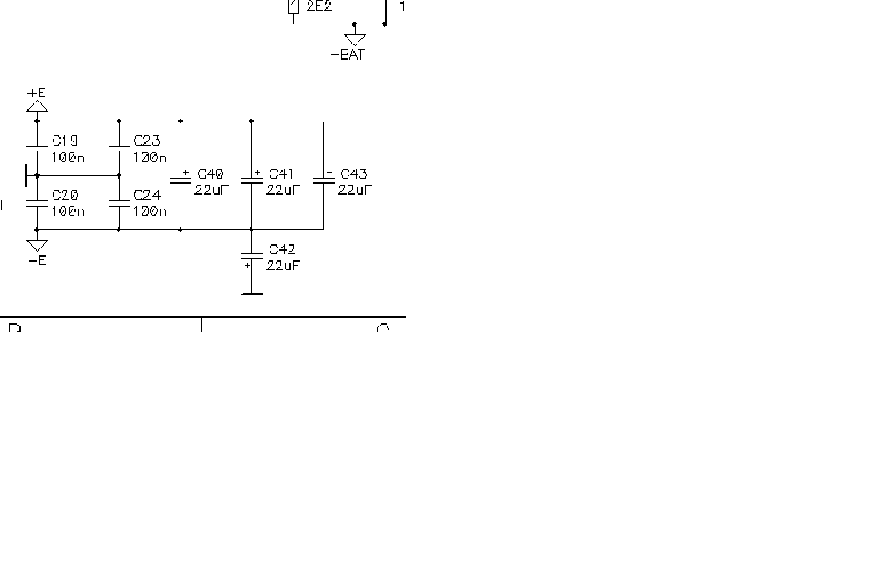

                    hi kt315 and guru
                    i don't success reject ground effect , by only GEB pot . i take video and send here .
                    for tantalum caps i parallel tree and next series to one cap ( like schematic but i add like your image now ) , and i think add wrong C19 ,C20 , C23 and C24 .
                    Excuse form my English in video
                    http://p30up.ir/images/7vphmysxfesq1o2rfbnt.rar
                    if possible for you certain these caps where add to PCB .
                      hi kt315 and guru
                      [ATTACH]28787[/ATTACH]

                        hi kt315 and guru

                          • if possible for you certain these caps where add to PCB .
                            videos I shared above I did without the caps on PCB. Click image for larger version
                              videos I shared above I did without the caps on PCB. [ATTACH]28792[/ATTACH]

                              i add all caps under pcb , but i add it like you , are you add 100n caps (C19 ,C20 , C23 and C24 ) on your board ?
                              i take photo and past here
