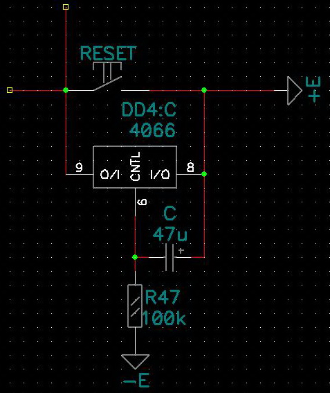

    • just checked my idea of autoreset... mod is working good. Click image for larger version
        just checked my idea of autoreset... mod is working good. [ATTACH]28800[/ATTACH]
        Hi kt315
        Value of C is 47uF ?
        Thanks.
        • hi greylourie, I checked with different values. 47 uF gives for me more clear reset, without retained sound. 33 uF is also, 22 is with retained sound. so 22-33 is at edge.
          I could be change also R47 to 200-470k, but checked with 100k finding optimal C value.

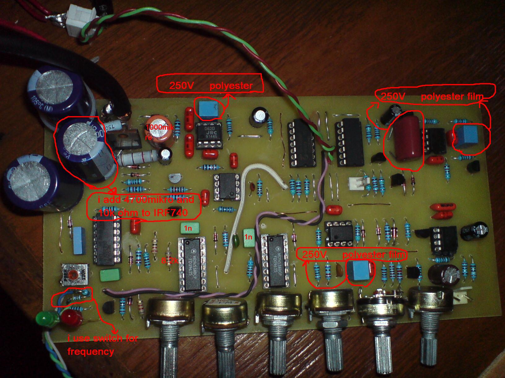

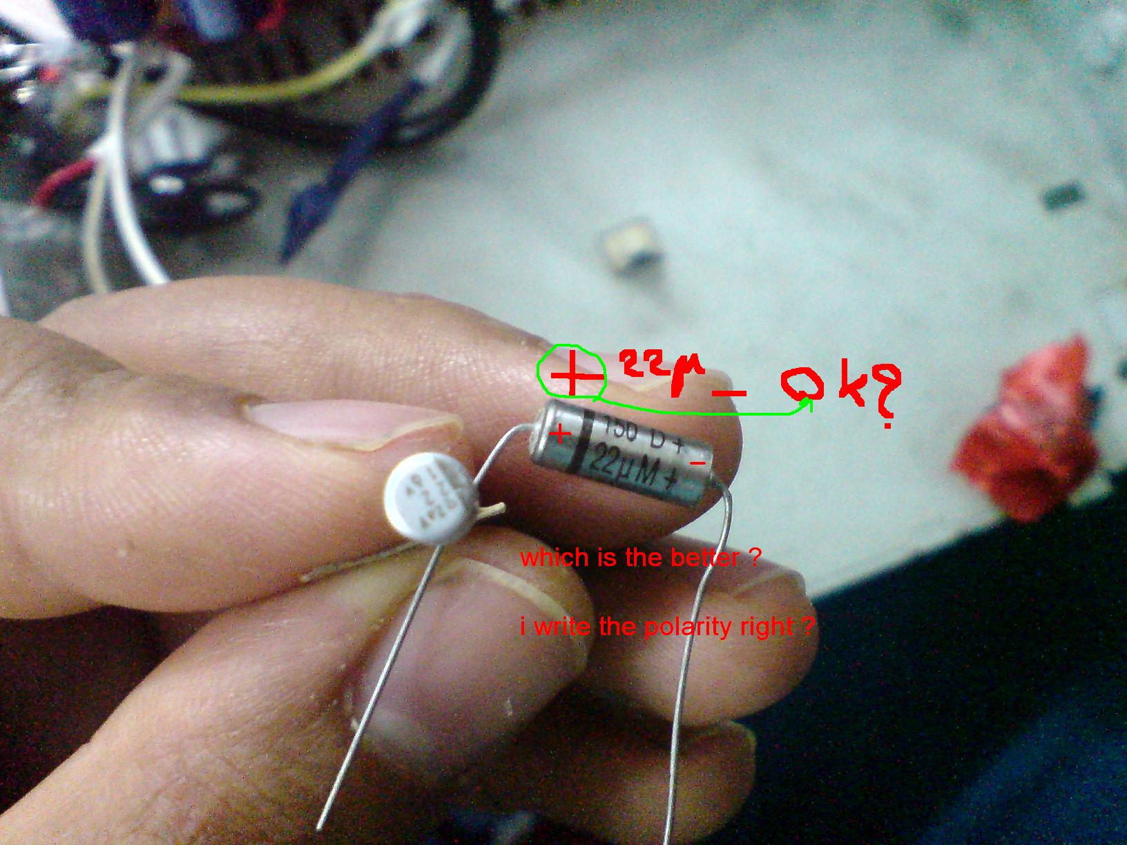

            hi
            Merci . i want add 22mikro tantalum but which is the better , look the pic please , and i certain polarity right ?
            i buy metal film res , i want replace R6 ( 1k ) by metal film res .
ID:	339635Click image for larger version
            again thanks .

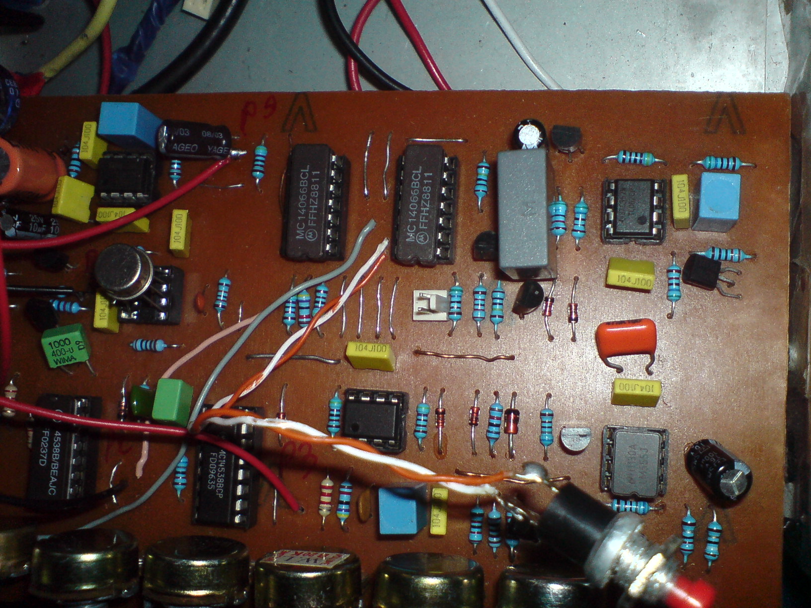

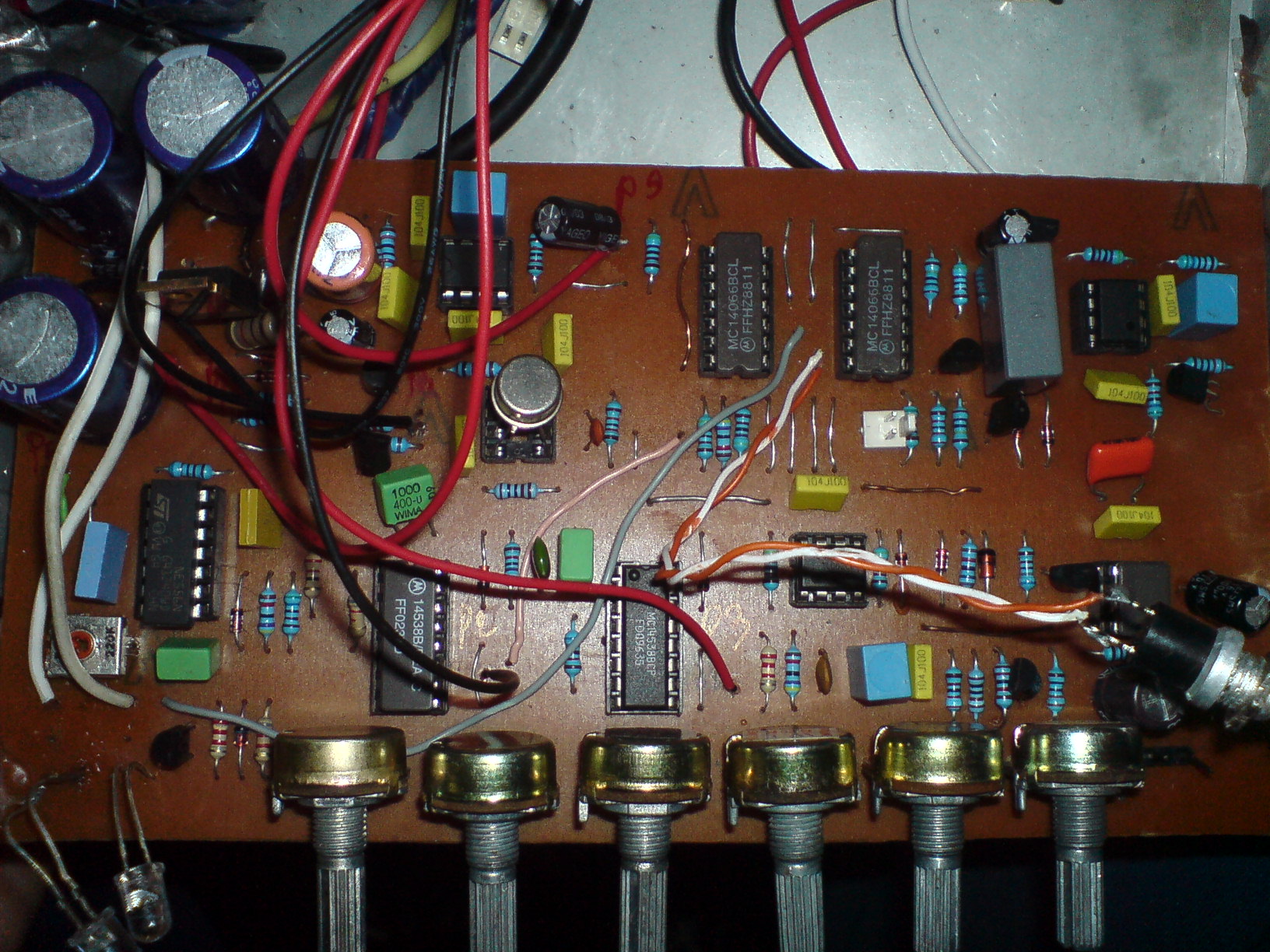

            • DP with the auto-reset mod.
                KT315
                Thanks for the mod. Auto reset.
                Tomorrow I'll try my DP.
                Jose

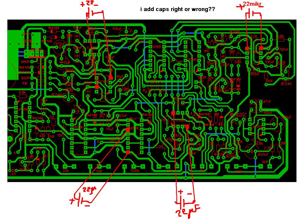

                                hi dear KT315
                                please see and answer , i wait for you .
ID:	339684Click image for larger version
