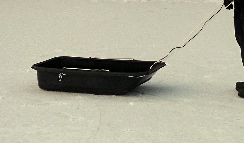

        • Time to "winter pulse" with new sled-coil. Coil size 120cm x 50 cm and 1.7mH. Lake is max 2.5m deep.Click image for larger version

          • Originally posted by Hannu View Post
            Time to "winter pulse" with new sled-coil. Coil size 120cm x 50 cm and 1.7mH. Lake is max 2.5m deep.[ATTACH]32008[/ATTACH]
            it is not correct.use 450mkh and 2.5to 4 ohm.
            get more depth u
            • 1.7mH would be working but it is not tested. try do mini coil with this L and test it at a table. DP is working with 380-550uH coils.
              with 1>mH you ll get more ringing frequency, more amplitude of it, and select the damper resistor value using the o-scope.
              • it was working but i'm going to take some turns away. Some schematics are marked "coil 1.1m x 1.1m 16 turns". It makes about 1mH?

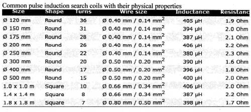

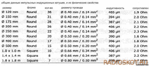

                • and what? this is a cause to appeal to bulgarians? so they had left the geotech long time away. I give you gold table, keep it for future.

                    • gold... we don't have it here. usefull table i see.
                      Now sled-coil is 500uH. still need to make small round coil with same inductance for indoor testing & damp resistor finding.

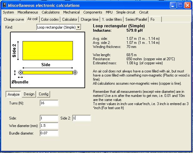

                          • Calculation for the Miscel program indicates that coil 1x1 mtrs, 16 laps, 580 corresponds uH.
                            Also you can see that if we use a copper conductor 1.5 mm2 section, the total resistance of the coil is 0.65 ohms, a vajo value for the DP.
                            So I installed a series resistance of 1 ohm 5W, and it worked better.

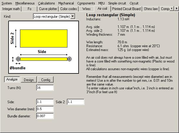

                              • Jose, in your calculation bundle diameter is 70mm. Is this correct?
                                Here is calculation with d=0.5mm wire and 7mm bundle diameter. Click image for larger version
