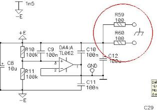

          • fOR YOUR kat315 ... And congratulations to improve delat pulse .. I want to ask about the R 59 END R 60 THE RESISTANCE associated with shields banners and below SIDED. Why do you use and resistance and not directly gnd ...Thanks beforehand G.S

            • GS, I copied this way from DEEPERS 10DD. thinking this has a right to be there. try to connect directly and tell about your experience.
              yours
