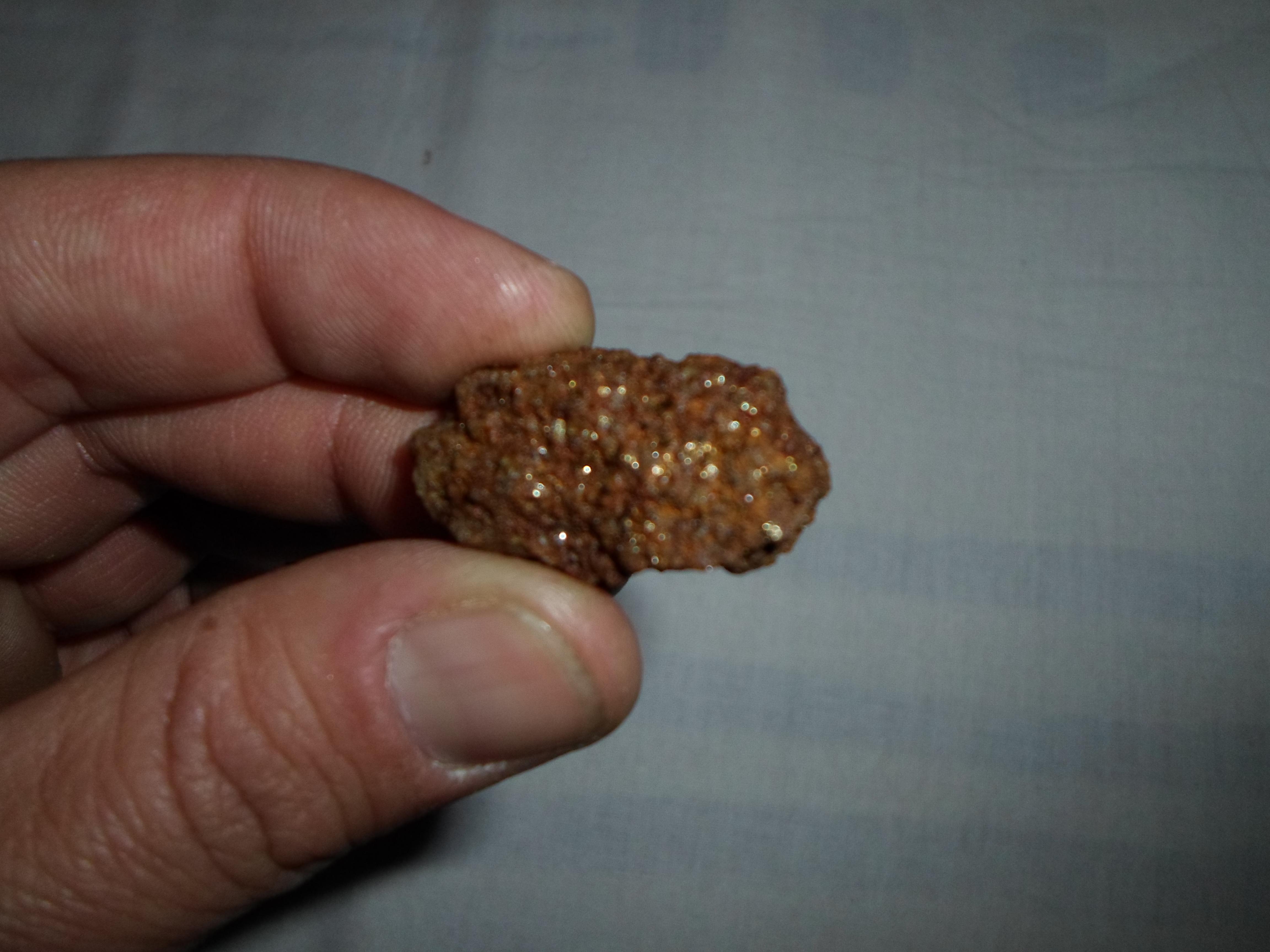

                  • the my own Turns out gold deposit xa xa xa.......

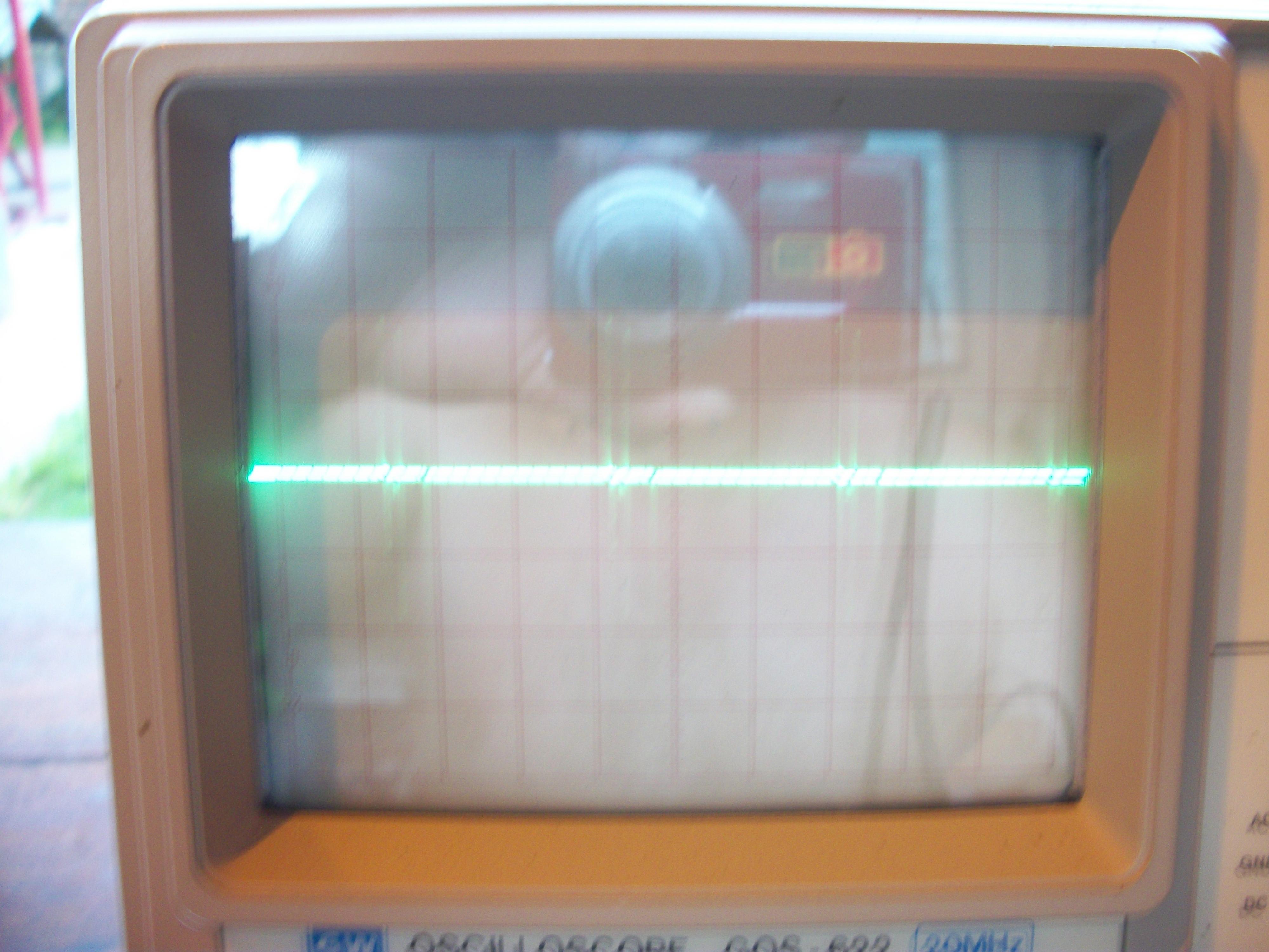

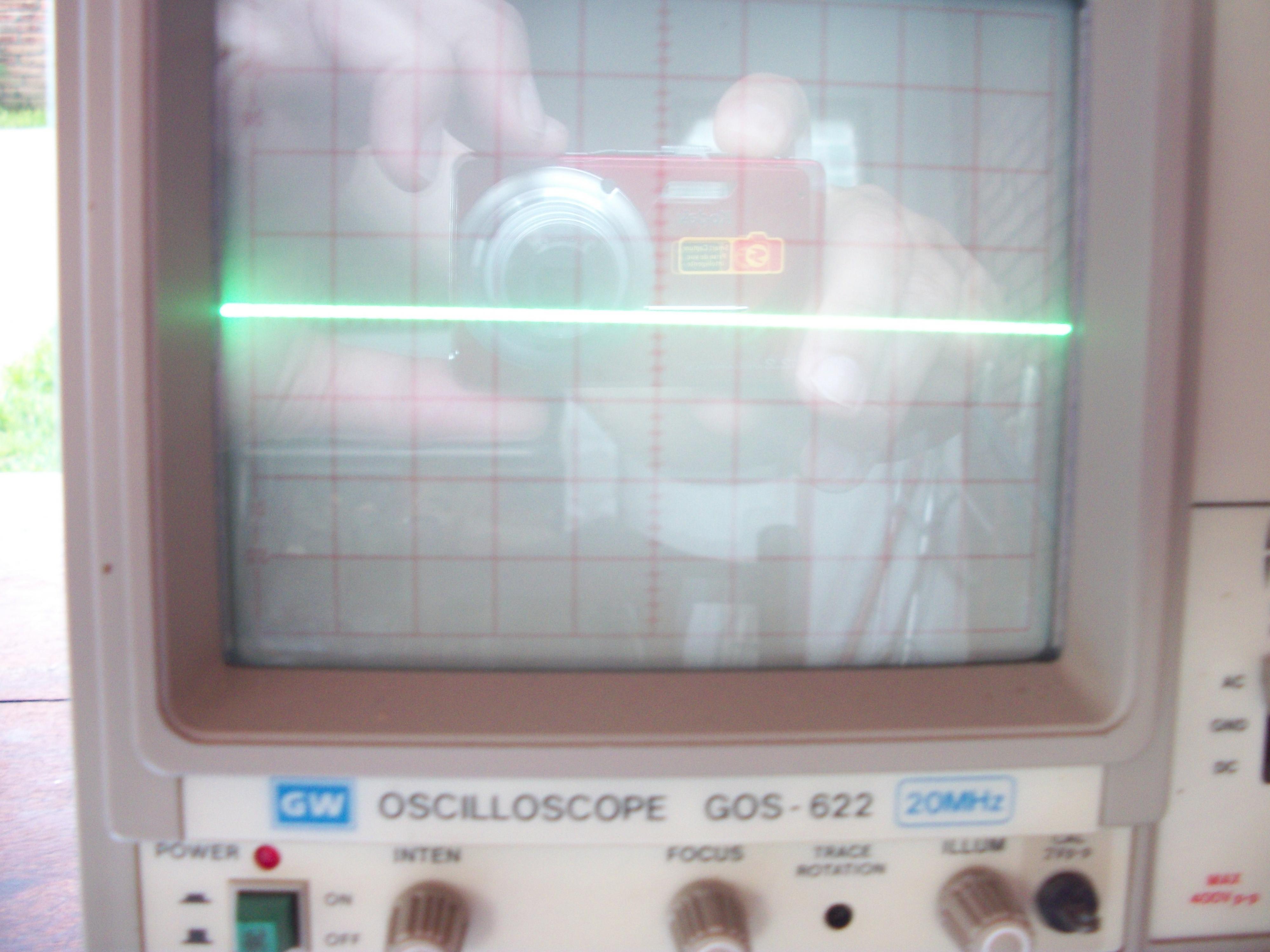

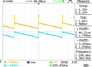

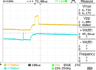

                            mohandes, send me a photo taken with the oscilloscope, the waveform at point "A" of the scheme, to compare with my DP. (ver.6 dp.JPG)
                            okyellow is D9-11 and blue is D7-2
ID:	338606Click image for larger version
                            please measure by multimeter D10 out put pins and D7-2,3,1,6,7 and put it here (when coil connected do this please )
                            Edit : i have 10volts on 555-3 and it is dc voltage ( is line wave not square wave or..wave )

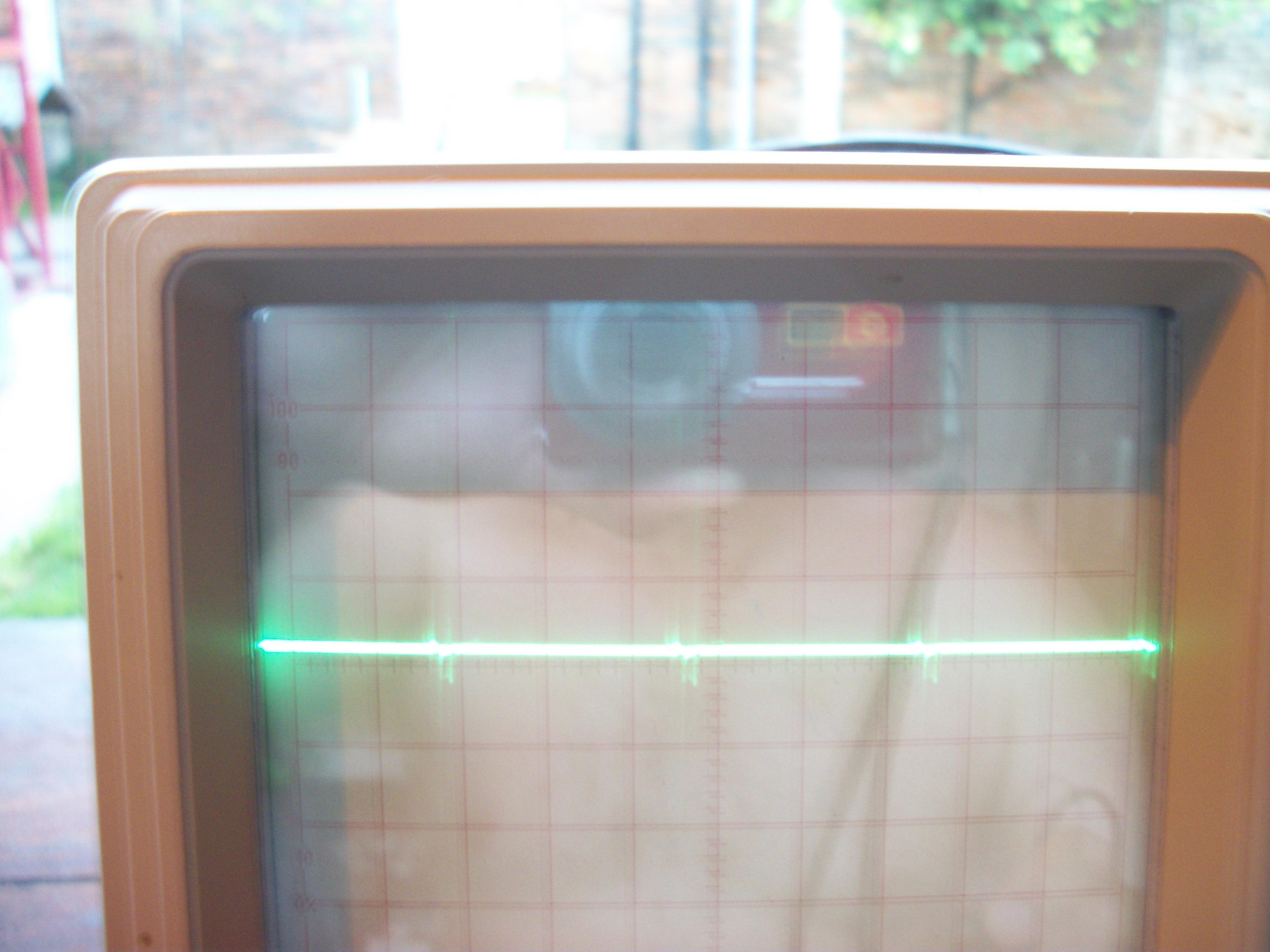

                              Delta Pulse, Automatic Mode, coil connected away from all metal.
                              Oscilloscope vertical sensitivity 10 mV per frame.
                              Signal in "D9 pin 11".
                              Signal in "D9 pin 2" .
                              Signal in "D10 pin 2".
                              Tensions in D7:
                              Pin 2, 58 mV
                              Pin 1, 5-10 mV negative.
                              Pin 7, 100-400 mV positive.
                              In my opinion, the integrator does not work or missing some or Tr5; Tr4 pulse, can be a key 4066.
                              luck
                              JoseClick image for larger version

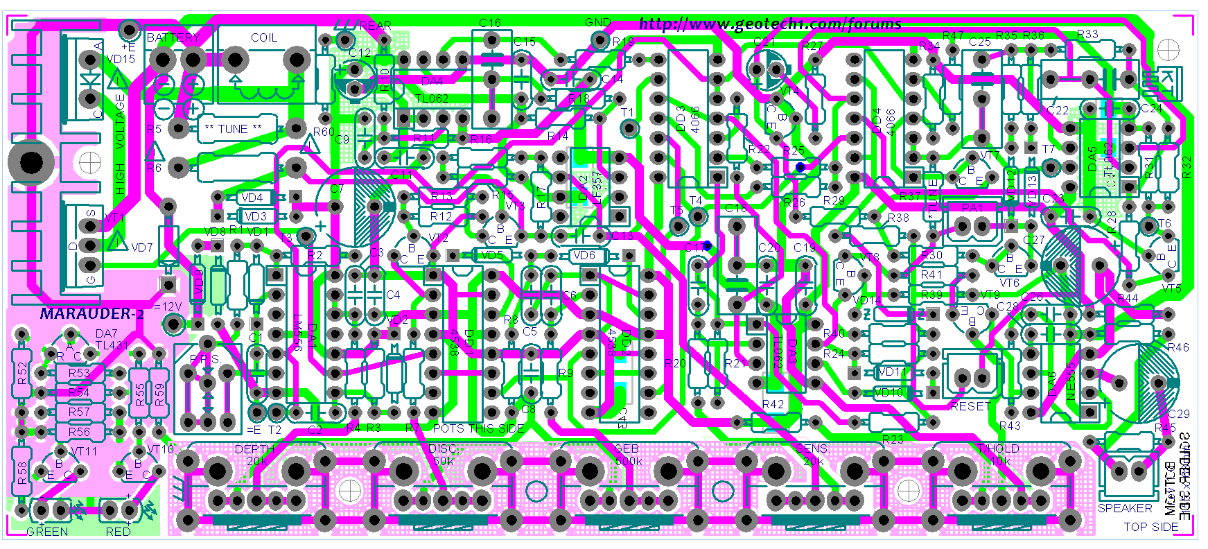

                              • added some copper pour and cutout at SENS pot pads. check.
