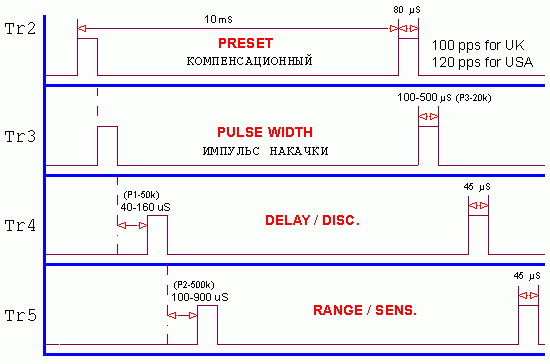

    • follow this diagram and you must get and see these signal CLEARLY and BEING TUNING. it was got from bulgarian people but I had corrected the diagram to more precisely time intervals.

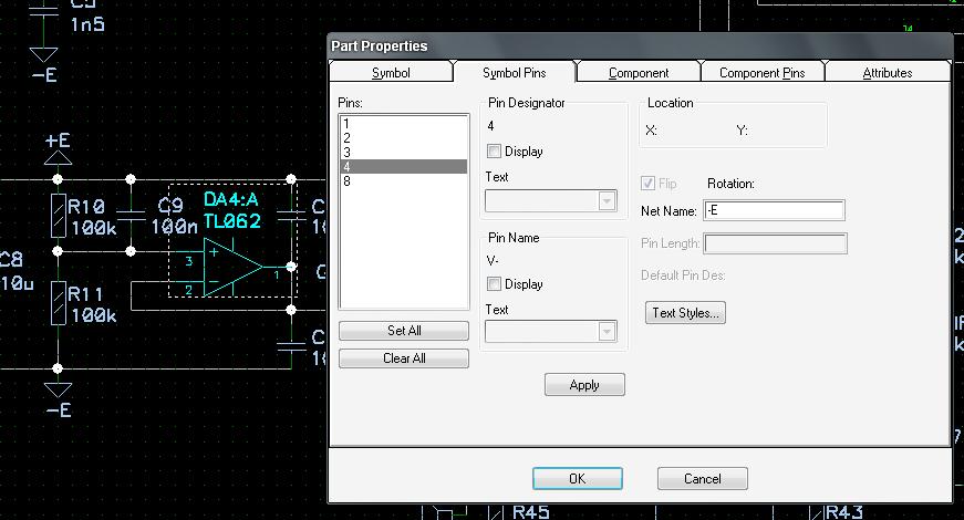

      • the shematic no pins DA2 and DA3 pin 8 on the PCB are connected to the E-
        this is good
        • at the schematic the power supply ICs' pins are maybe hidden. it is normal. but its are right connected to power lines. no mistake.

                  • decrease PULSE WIDTH to 250 us and measure the time again.
                    • Hello. if time increase the pulse ΤΧ what follows we will, (I hope that there will be increase in power).
                      NIKOLOV check the zener VD15 9V1

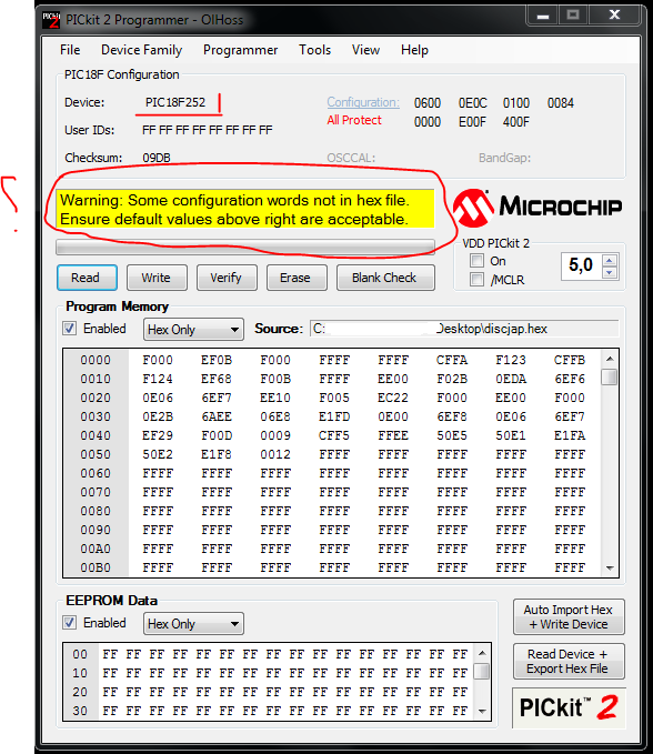

                          Programming the PIC 18F252
                          I noticed this error
                          So I only lighting on LCD but no program
                          Note: The PIC used is a 18F252 - I / SP
                          becaufe the 18F252 - E / SO does not exist
                          What do you think? Error range of PIC.
                          • Hi Nicolas
                            -The prog. Found within the HEX file a configuration and their work is done in comparison with the used pic.
                            -try to use another program covering values such as icprog106A
                            and see results, if similar not validity programming the PIC 18F252 - I / SP.
                            best time
                            j.

                              Hi Jap
                              I thank you Jap the program to another program such Microchip. programming is unrolling correctly but still the same problem
                              The display is completely blank no program opens.
                              Against by a similatuer ISIS hopefully.
                              I try to program three PIC but no reading on LCD.
                              I think the Hex file is corrupt.
                              I ask someone who owns a file is good if walking with his detector can share.
