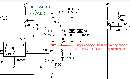

                          Delta pulse'nan hic ilgilenmedim simdiye kadar. Ama altindaki gösterdigim deneyi yap. FET'in isinmasini biraz indirir belki.
                          Miner'nen hic ilgilenmedim. Su anda kendi yaptigim deneylernen cok ilgeleniyorum.

                            • hi Aziz. what do the diode and the resistor give that you added?

                                Hello KT315. Sorry, I'm not Aziz. I once asked Aziz the same question about the diode so maybe you won't mind if I answer. The diode becomes reverse biased during flyback and therefore acts as a capacitor in series with FET capacitance. Series capacitance is reduced, by the formula CT=(C1XC2/(C1+C2)). This reduces flyback time and allows using a higher value damping resistor.
                                The resistor? I think that is a 10k pulldown resistor. The LM556 already has a fast trailing edge in this circuit - but if you use one of the CMOS versions having reduced output drive (ICM7556, GLC556, etc.) a pulldown would be beneficial.
                                edit: Any increase in speed to the flyback pulse should equate to more energy transmitted. Adding the diode should definately result in noticably higher coil current for a given transmit pulse. So, the transmit pulse could be shortened if you don't want more coil current. If you do shorten the transmit pulse you should see an increase in battery life because of increased efficiency.
