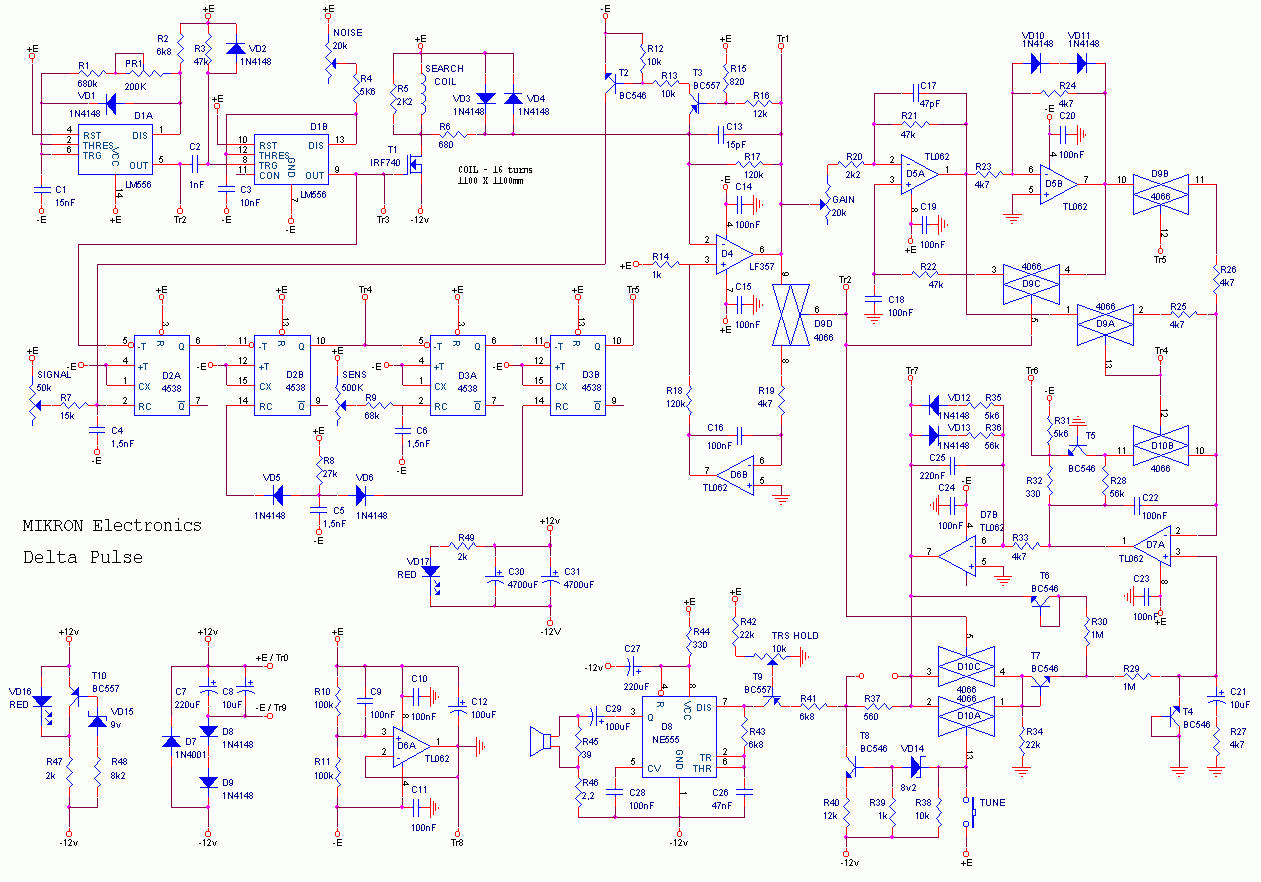

      hi, could you help me connection about Delta pulse ? For example Potansiometer, P3-Tr3 how can i connect them.

        I can“t find the schematic from the delta pulse.
        Can anywhere help?
          Delta Pulse
          Here is Schematic
            PLEASE, do not ask me privately about this schematic. I did not make that. I did read replies from someone who really did it, but writes a tuning was been difficult for him. thereto, the project has very low reaction speed on a target and a reason of it is still unknown. so the guy modified the schematic and offers it for sell.

              Disasembled pcb is the same as this schematic, but i dont know why every1 think that delta pulse is the best PI to build.

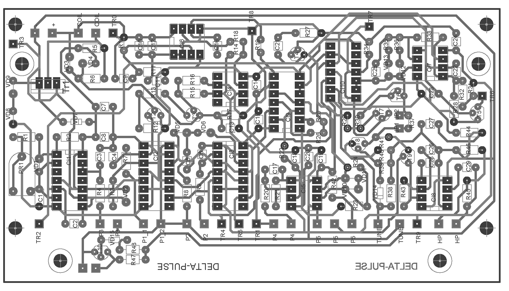

                            i built schematic of Delta pulse but some are lack about connections. for example Tr1-tr2-tr3 and potonsometer connections. Where is the connection diagram. could you send me ?
                              Delta pulse clear question !
                              look at the pictures. Thats my question, how did you connect them ?
                                Originally posted by gemini
                                hi
                                I think that in this pcb you see the connections.
