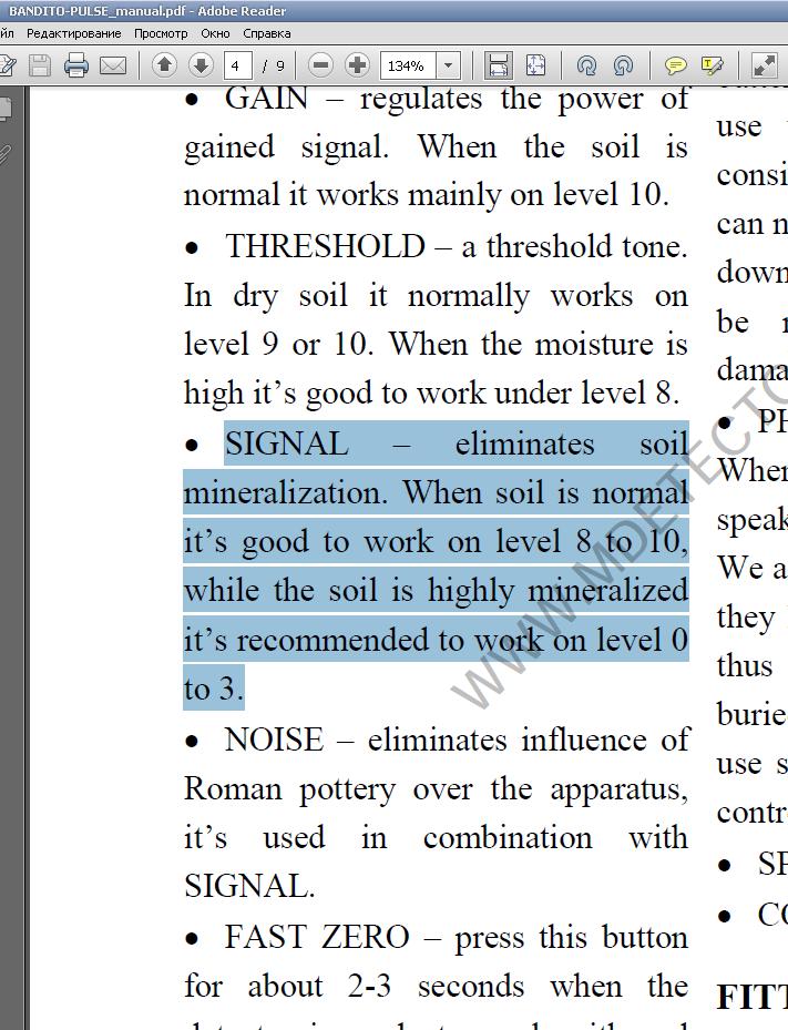

ID:	341123 And this is after you graund balance there really eliminate something cut down on but it is not Ground balance attempt to eliminate the red brick so let me know kt I'm very disappointed I'm your more appreciated,I thought that the more you know about pi detectors !.
      • What do you think Why him Golden Mask him ,Ask Vladimir or see the Bulgarian site Imperio What he says Vlado all the best KT !BANDITO-PULSE_engl.pdf and yet this, Bandito Pulse schematically more (dbp 2010 or detective ) but less delta pulse If I understand correctly Vladimir ..
