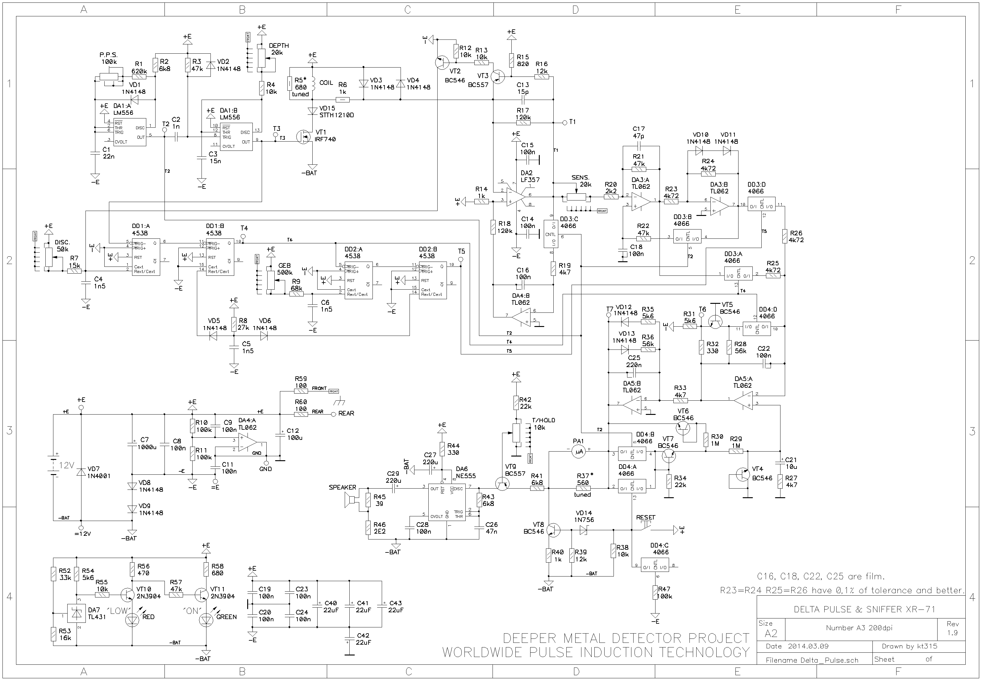

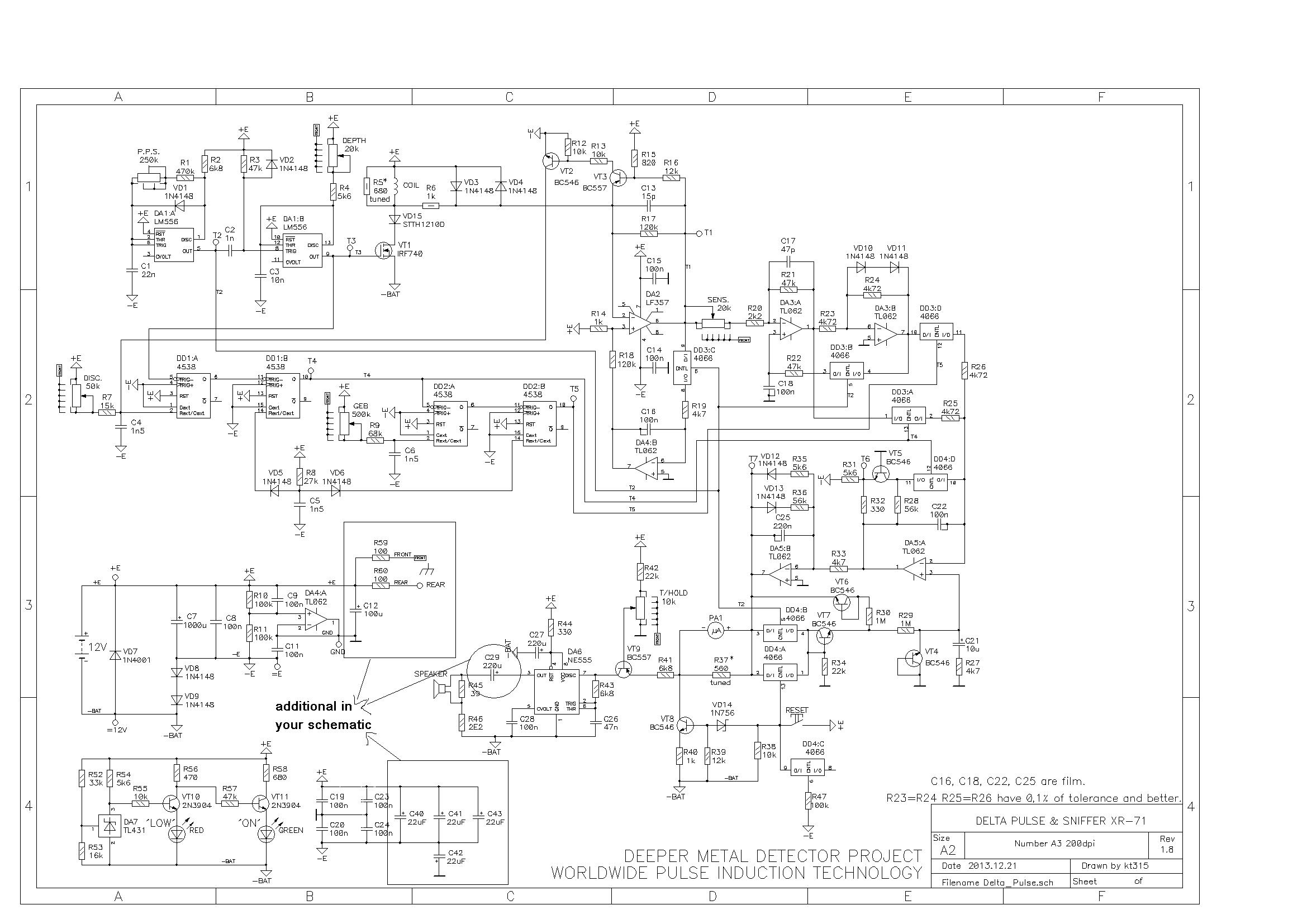

        • hi dear Kt315 .
          i will make new smd PCB ( with your new schematic of DP2 ) , the schematic is ok ?
          and about tnt caps ( 22mkfarad ) you say me attention to all links , and i add again and fault mt detector , please see .
          • the schematic is ok but you do not wish to see changes done on it. as always. for example, I changed P.P.S. trimmer value on 100k,
            because 250kOhm is more rare type. I changed C3 on 15nF, PULSE WIDTH was tuned to sure 150-500us.
            if you want to add tantalums so stay on power lines near opamps, as near as you can.

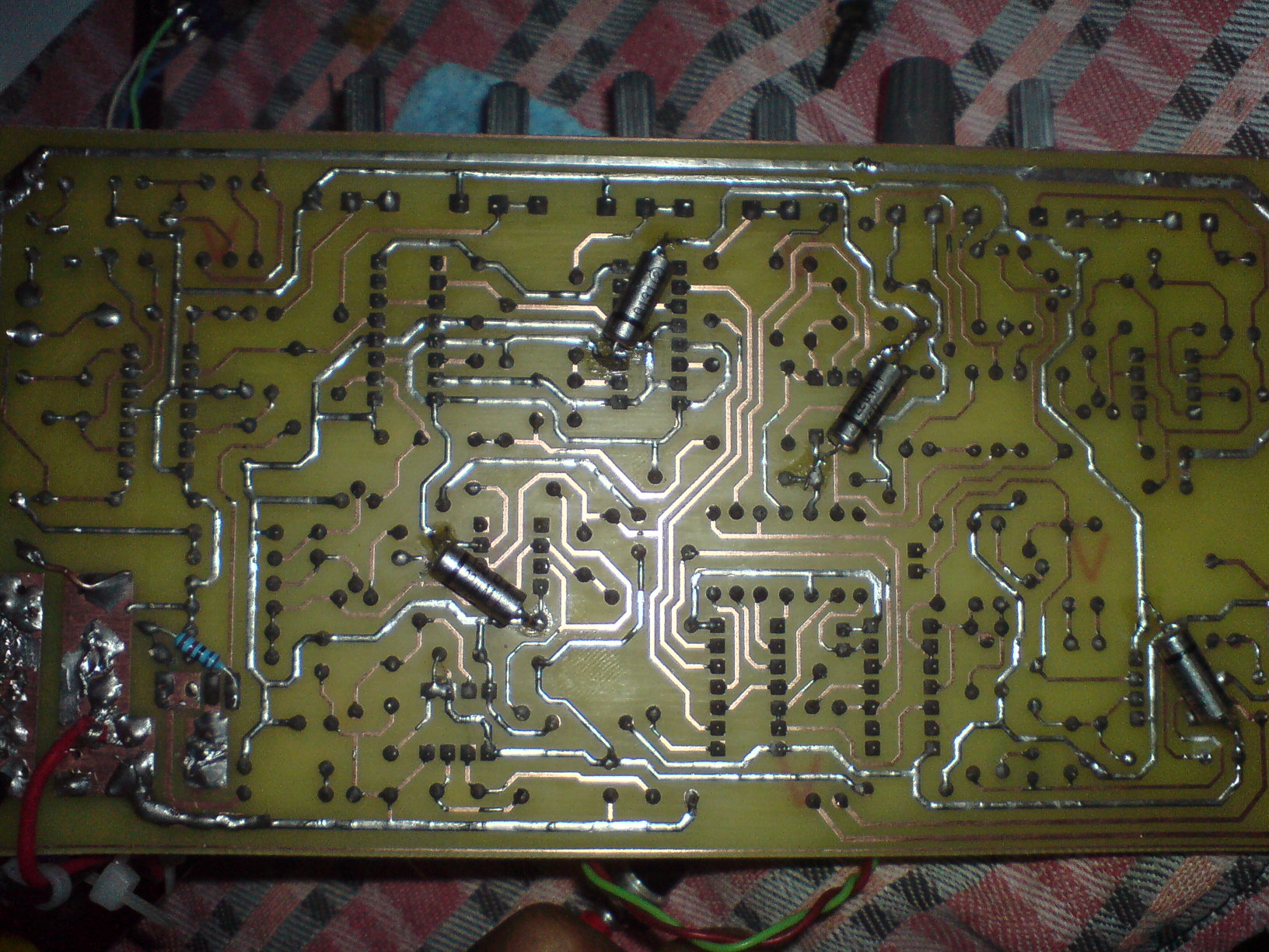

            • hi
              i add caps but ....burn
