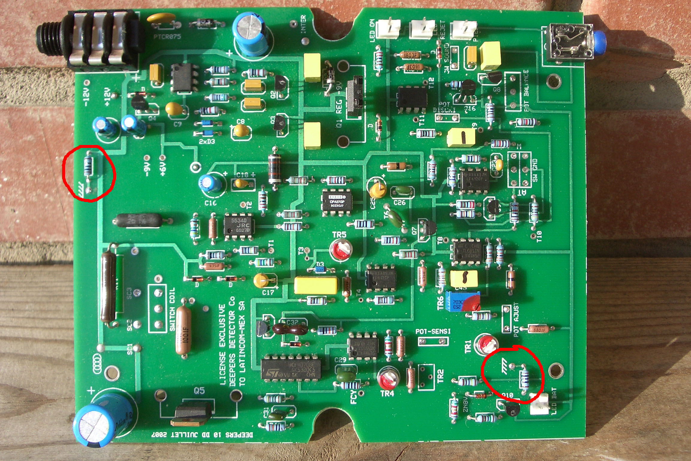

                      • KT315 R60 goes to a point REAR, but what does it mean? In particular, what should be connected at this point?
                        • its mean rear side of enclosure and still one point to connect board, ie shielding point.
                          you take a plastic box but with aluminium false panels in front and behind. you must CONNECT
                          the both panels to (+) of power suply to be shielding.
                          or
                          whole box is only plastic. you cover by the graphite inside but you have to connect
                          front panel and rear (o la la) panel to PLUS of your battery. REAR is a point for the wire going to shield layer
                          on rear panel.
                          this way was taken/copied from DEEPERS 10DD one-in-one.
                          • Now everything is clear. Thank you!
                            • this is Deepers 10dd board, i marked those resistors with points for shielding.
