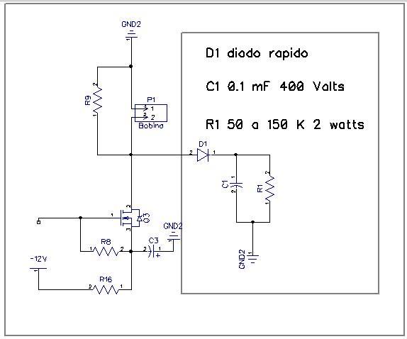

                    • You can experiment with a voltage limiter as the diagram, I use one of my detectors.
                      You should set the value of R1 for pico, voltage value.
                      Check with a voltmeter at the end of R1.
                          Jose[ATTACH]33808[/ATTACH]
                          Thanks Jose, that's what exactly I had in mind!
                          I guess if someone doesn't have the high voltage diode STTH probably could use this instead. Not sure which is better/worse choice?

                            • It can be used in conjunction with the series diode between the MOSFET and the coil.
                              Even with the diode series, one can observe high voltages in the MOSFET, with ociloscopio.
                              In an experimental detector (not Delta Pulse), series and use diode voltage limiter to prevent noise generated by the zener protection in the IRF740.
                              Also decreases the heat generated in the MOSFET.
                              As I am using IRF740, R1, is set to cut approximately 380 volts.
                              As KT315 says, you can lose performance in some cases. You can always return to the source schema.
                              Jose
                              • Thanks for your example and explanation, Jose.
