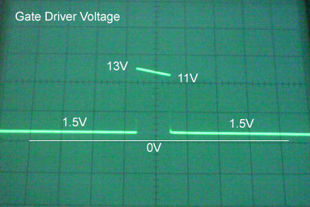

                        • Gate Driver Waveform
                          Hi all,
                          I checked the gate drive...(Voltage is from source to gate)
                          I think it is not good. How about your gate drive waveform?
                          Thanks in advance.
