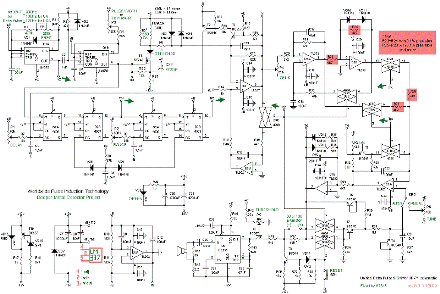

  • Hi all,
    A expert glimpse, please:
    Thanks.

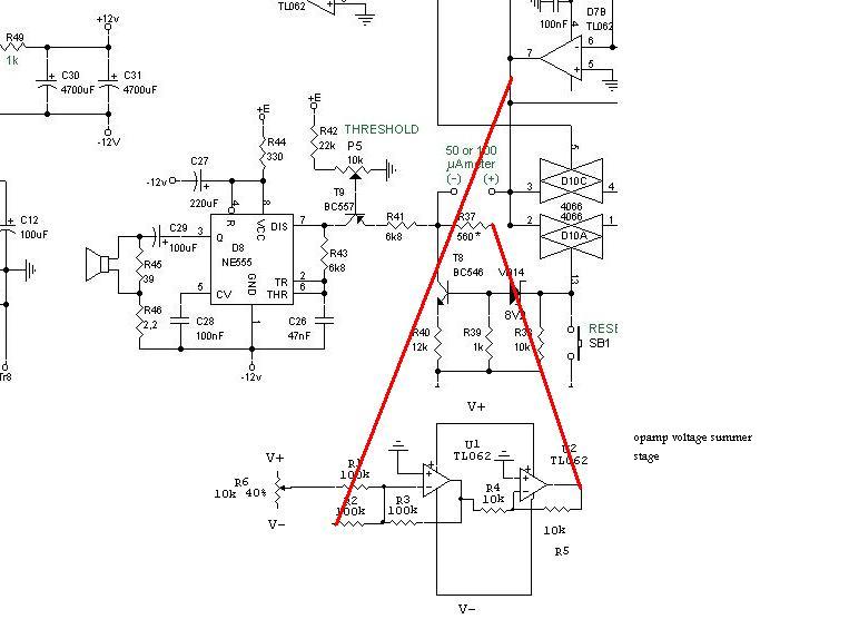

    • FINALLY REPAIRED !!! or maybe....
      Except: Sound "disappears" when the Threshold is at or near maximum (only speaker, LCD still working right)
      (NE555 pin 2 with signal/detection Thresh. at middle = 2.01v, But with Thresh. at max. = 6.84v !! what happens ....??)
      Ger.

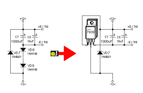

        • Hi ,
          please can any one guide me how to connect leads LM337 (adjustable negative regulator) for exact 10.6volts to get more stability ?
          many thanks
          • R1 = 220 Ohm
            R2 = 1646 Ohm
            V = 10.60v
            KT315 has a good idea with 7909 (search post).
            • some idea
              http://174.132.129.189/~moreland/for...1&d=1311764490
              this make the device more sensitive
              because i increase the thresold voltage that make sound in VCO circuit
              try this
              • Originally posted by berreizeta View Post
                R1 = 220 Ohm
                R2 = 1646 Ohm
                V = 10.60v
                eah... it was...
                • please not write me PM.
                  do according to the datasheet on the IC. copy the PDF on your hard disc and learn the file for first.
                    folks,
                    I have tested my last mod and was very amazing that it is not working good I was dream. so please do not do this mod with 7909.
                    stability is great but sensitivity is very low.
                    yours
                    Hi kt315 ,
                    but how you solve the sensivity probleme ?
                    many thanks again
