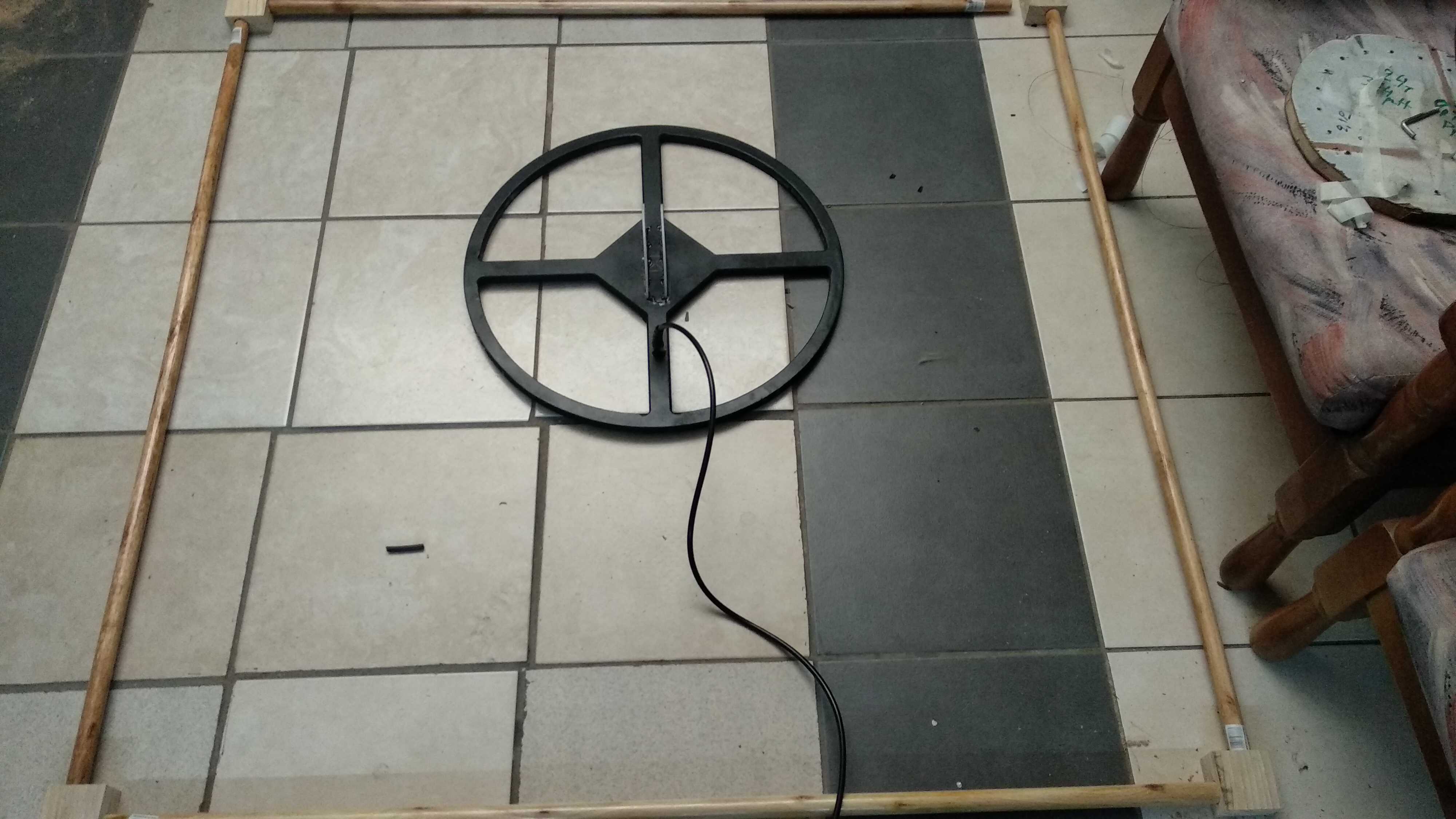

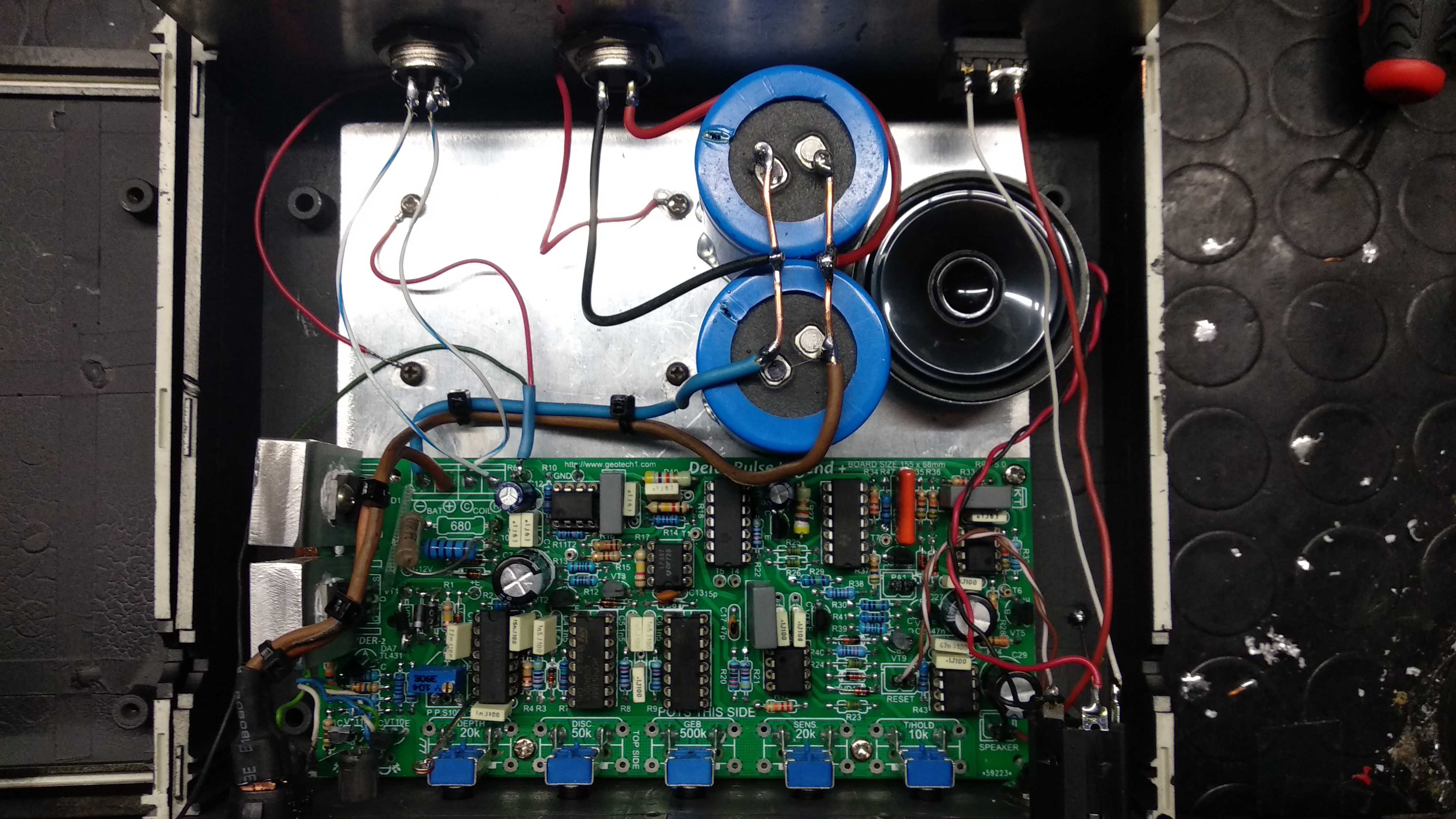

                            Almost finished my DP Legend+ build,must admit it's a very strong detector!!!Planning to use it with 1m X 1m square coil but i've made also a 50cm OD mono coil from 0,55mm double enameled coil wire.
                            At first i attached a 40cm monocoil i had allready made,noticed 2 things: 1) it dumped pretty low 280 Ohms and 2) When i tried to increase main sample width the low batt led came on,the detector seems to need more power to drain so i put single core 2mm wires to power supply and added 2 X 10.000uF/63V to help it.
                            As for my 1x1 construction im a little confused about wire diammeter,found a pic from Sniffer XR71p brochure that uses 1.5mm wire (i guess PVC multistrand) 16 turns..Also found another document from another 1x1 that uses 0.66mm coil wire (enameled) 10 turns..What is the best option here?I have 1mm multistranded PVC insulated and 1mm solid core PVC insulated??

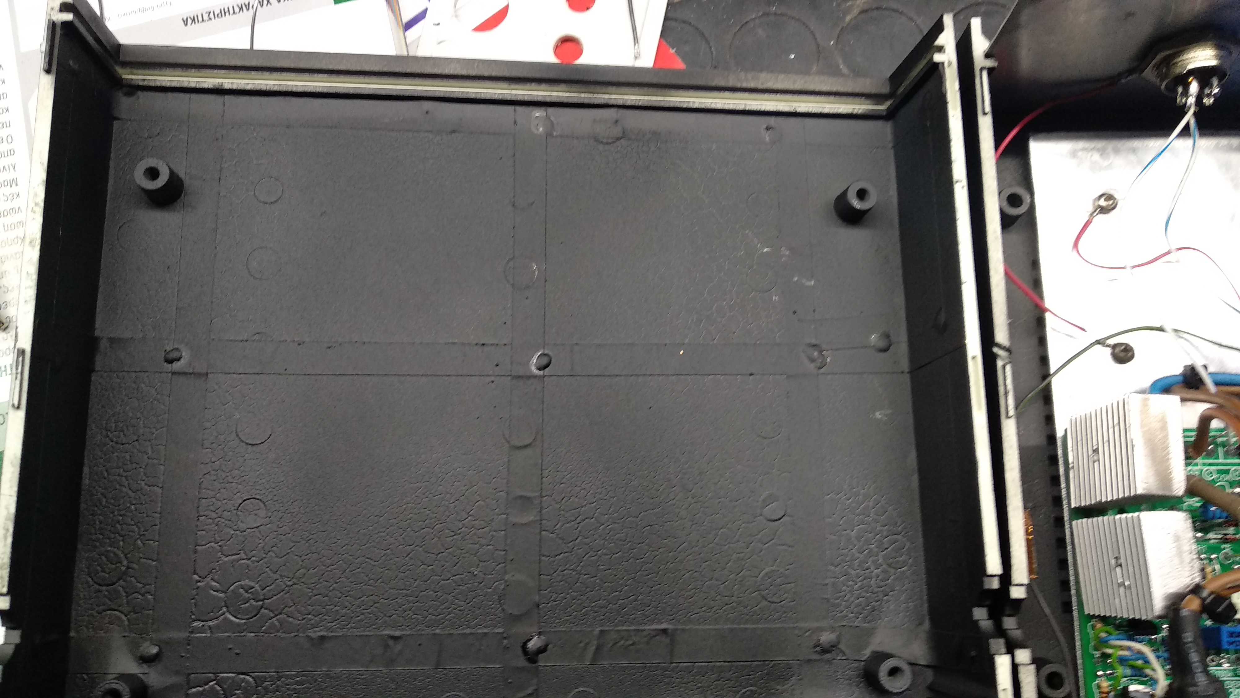

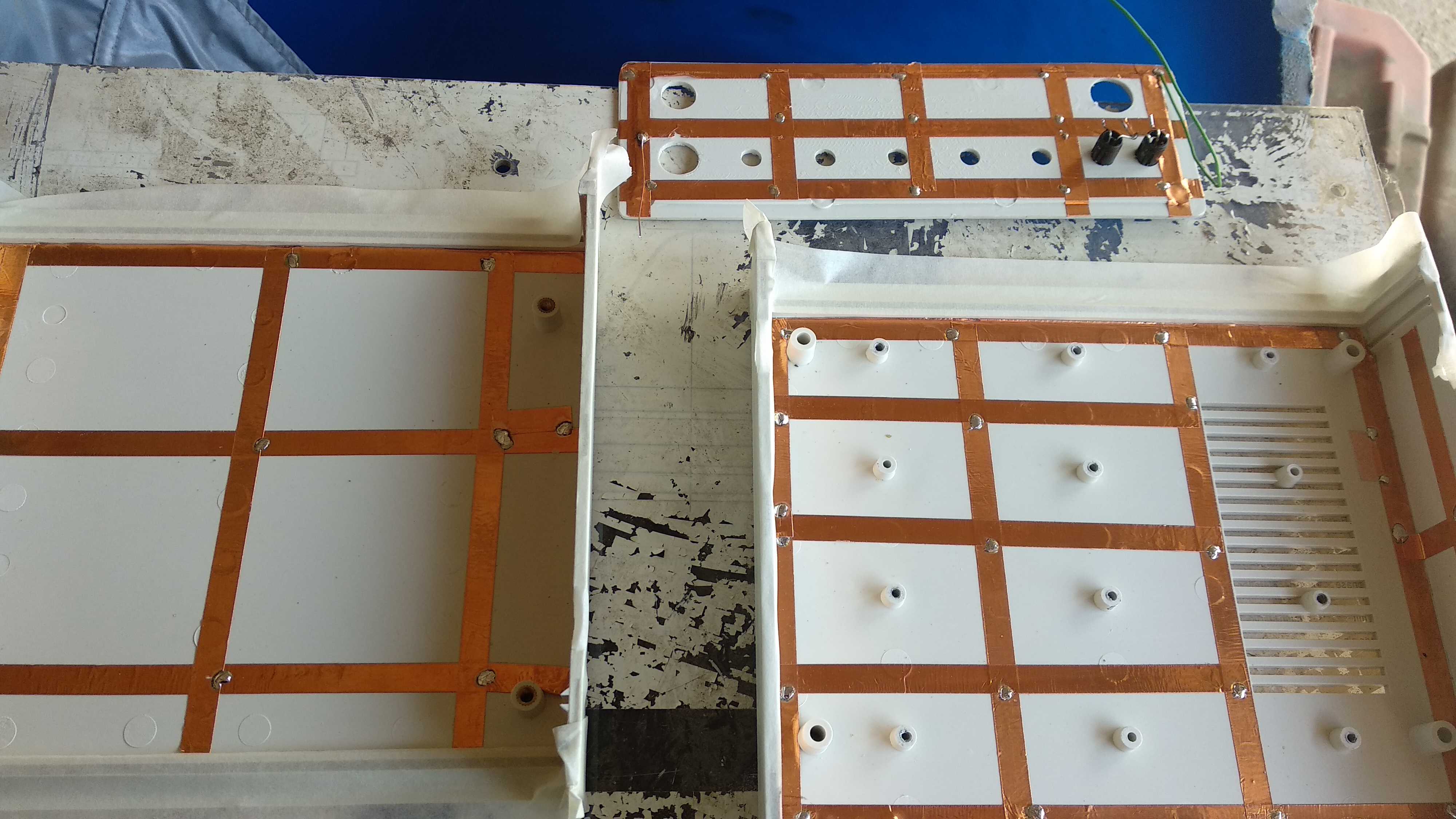

                            My build so far,KT i hope for your help and as you advised made electrostatic insulation on housing,first with coper lines soldered together and then sprayed with conductive graphite spray.

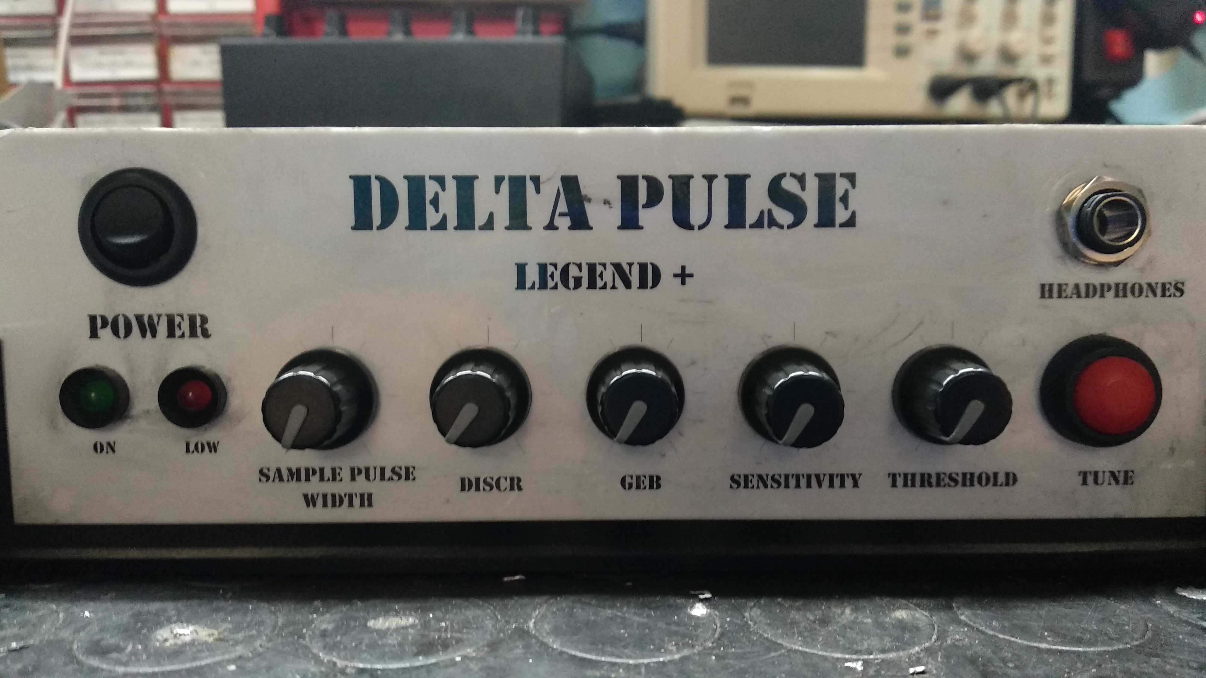

                            • just notice. change first pot marking on front panel from SAMPLE PULSE WIDTH on PULSE WIDTH. in the schematic SAMPLES' WIDTH is constant, untuneable, and length approx 45us.
                              • OK my bad!
                                Any advice for 1m X1m coil??
