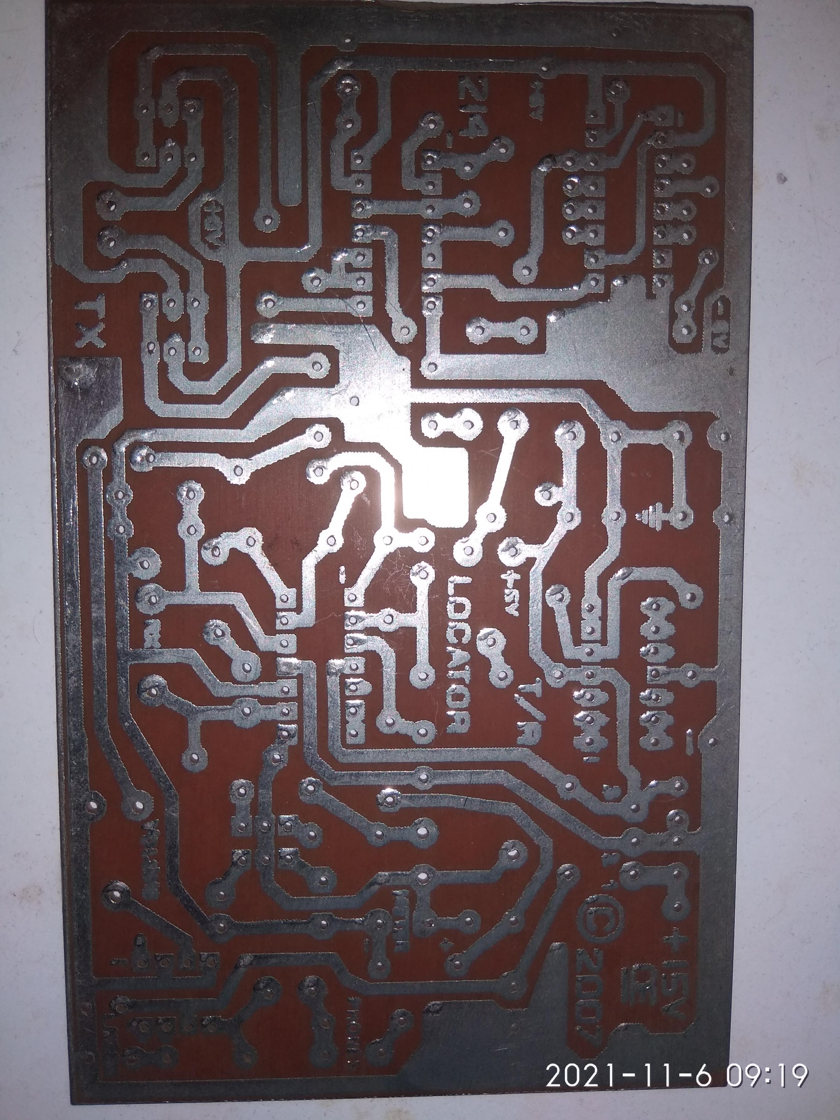

      TR Locator Redrawn
      Hi all. Can someone please be kind enough to check my layout for any mistakes,,,,appreciation in advance. Regards, Marty.

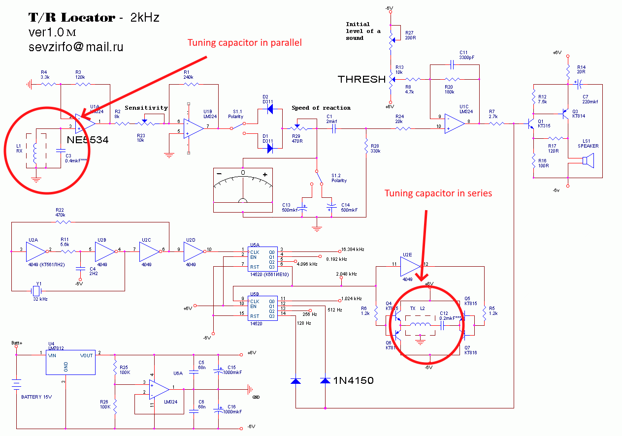

          I have some questions to the T-R-Locator.
          1) Is the schematic drawn correct? Because the TX coil is in series with the tuning capasitor but the RX coil tuning capacitor is in parallel connected to the coil. From my feeling the TX tuning capacitor should be also in parrallel to the coil like the RX tuning capacitor.
          2) For what actually is the tuning of the coils for?
          3) How and what is to be tuned?
          Thanks in advance
          • #50
            1. TX tuning capacitor should be in position as on the circuit. by the cap, by its value, you can change a current in the TX coil.
            this in not current resonance you sure need to get, but just for the control of current, ie TX power in ground.
            • #51
              Hello kt315,
              thank you for your reply. I think this helps me to understand the circuit better.
              Chris
