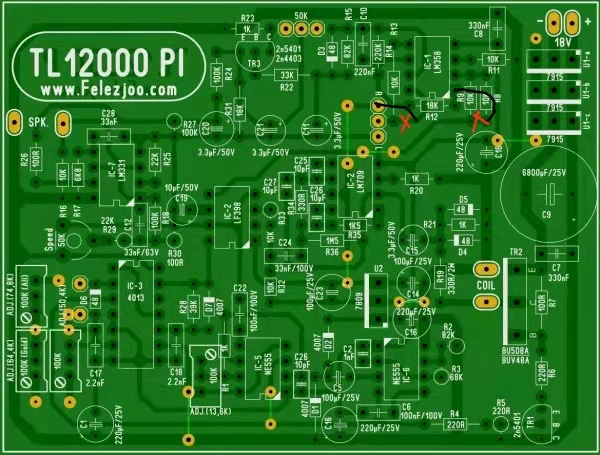

      Originally posted by deltapulse View Post
      [ATTACH]57253[/ATTACH][ATTACH]57252[/ATTACH]tl12000
      Is this PCB true or working ?

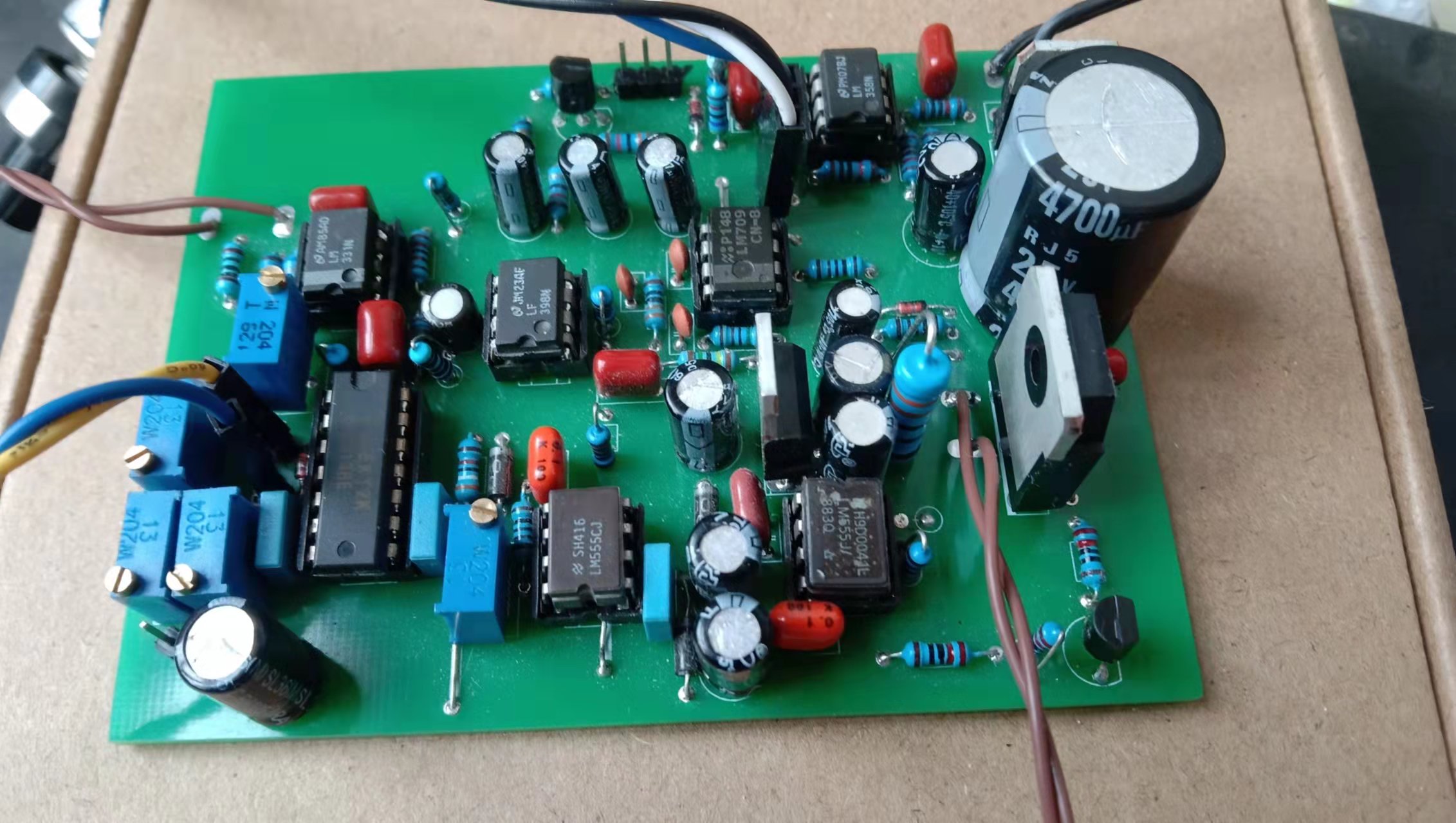

        • #49
          Hi friends
          TL12000 new working PCB with iron discrimination

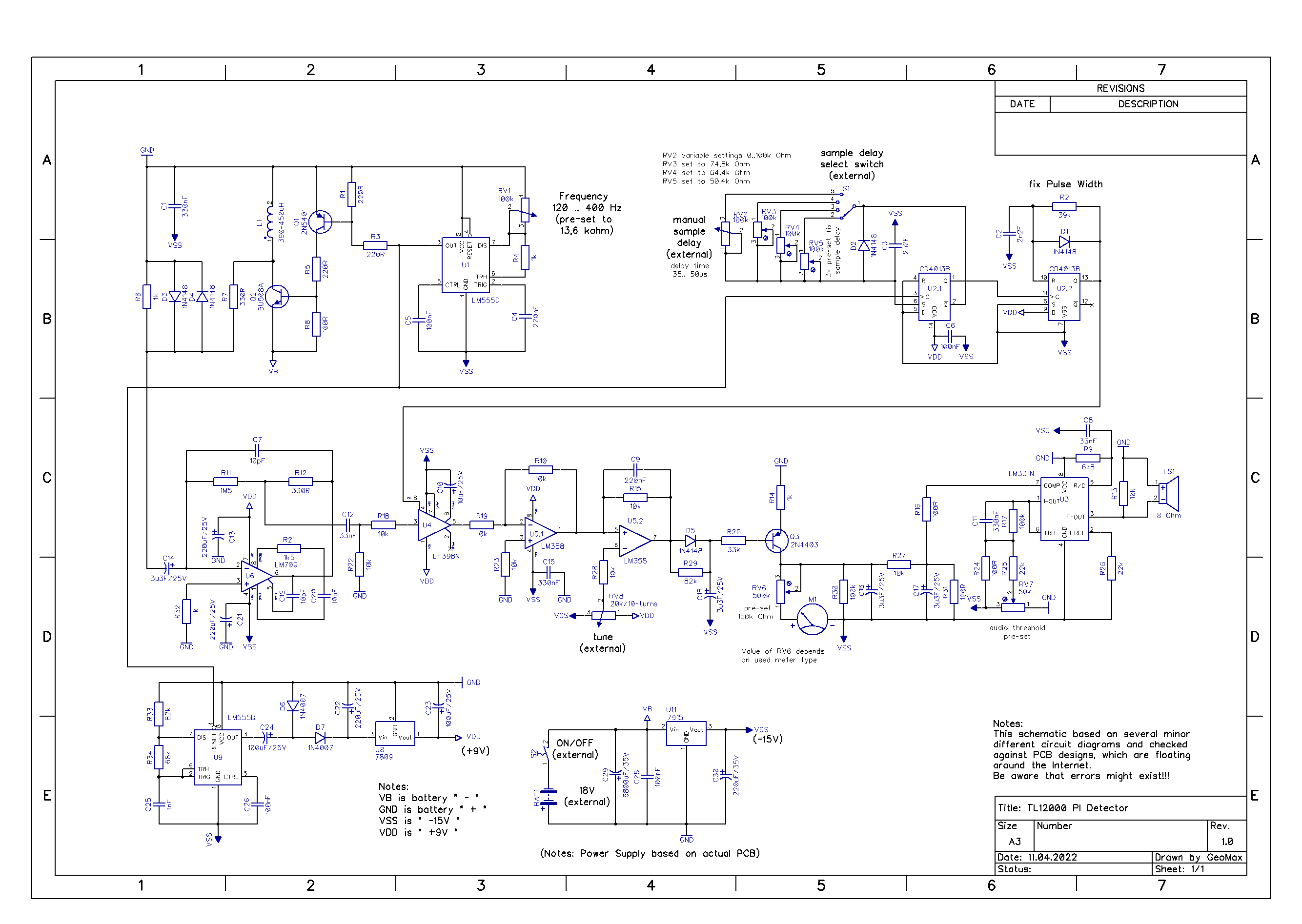

                        Hi Forum,
                        here a redrawn TL12000 schematic based on several different circuit diagrams and actual PCBs from the Internet.
                        GeoMax
                        • #57
                          can you please upload the full layout file here, maybe zip container THX

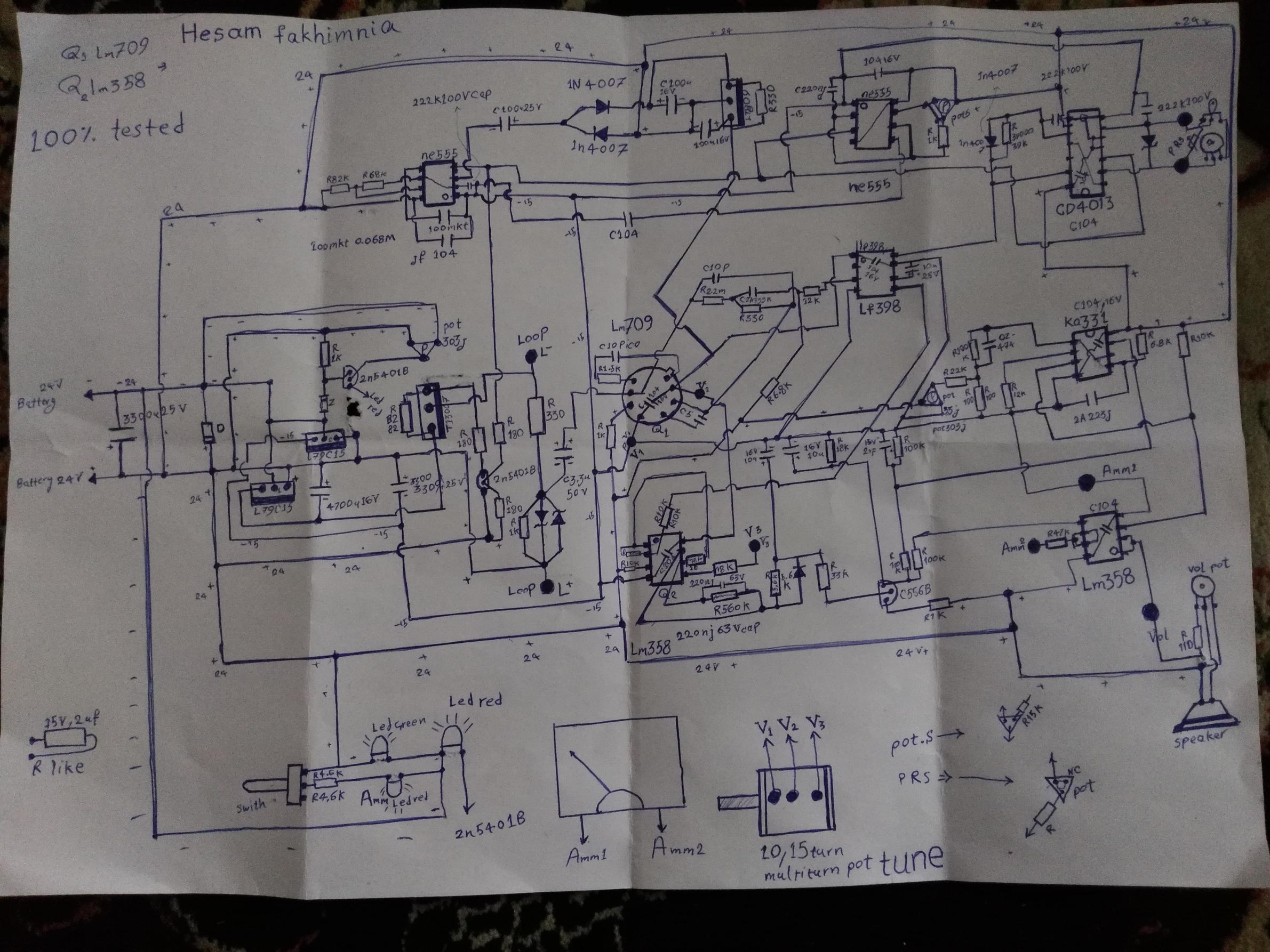

                          • #58
                            hello friend tl12000 is a very good detector that detect a 24mm coin in 40 cm i searched the net for a true schematic but no luck .
                            som one give me a device and i decide to drawn a good schematic for you guys .. this is double checked and 100 working shematic. please somone make a good layout file from this thanks ..​

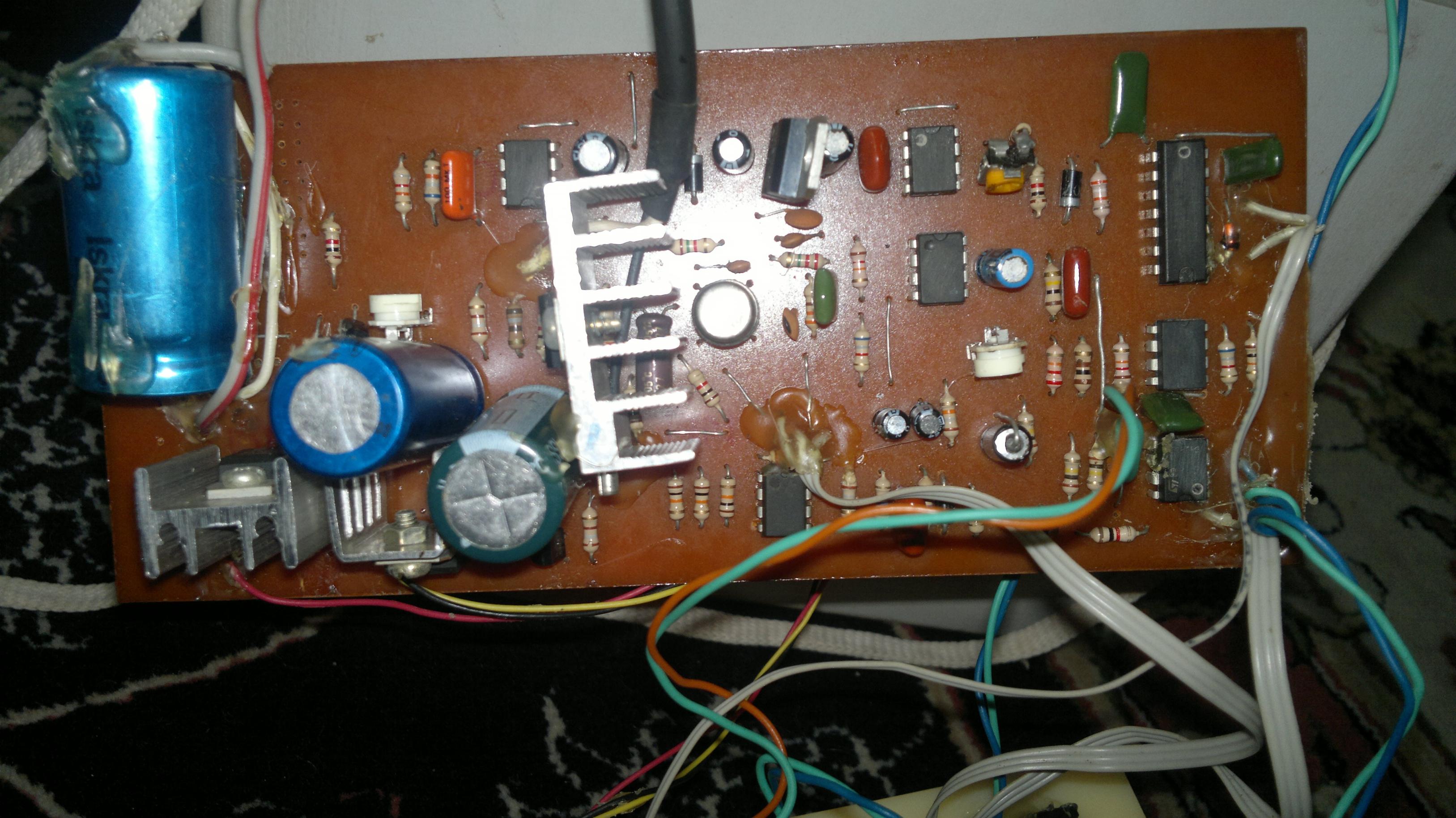

                            • #59
                              this is the device and pcb image

                                I had a quick look at your hand drawing and see already some problems. The connected R=330Ohm across pin 1 & 3 of the voltage regulator LM7809 is very doubtfull. Also the capacitor "100mKt" at the first 555 timer is not a capacitor value.
