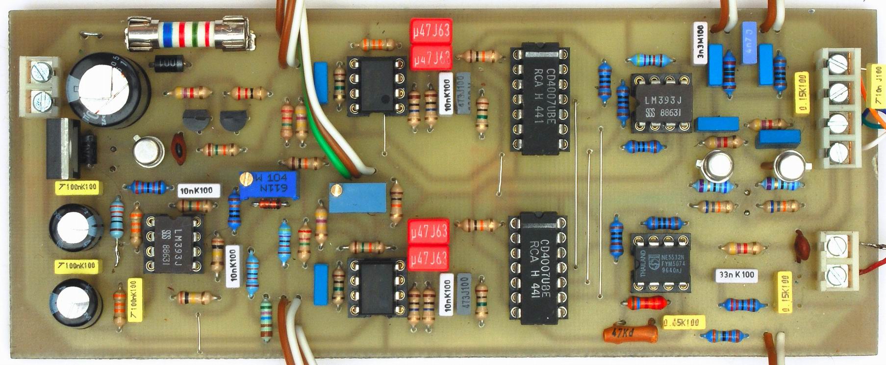

        • #49
          Originally posted by tiktak View Post
          Leto.
          Thanks.So I will try 19,5cm former TX=100w 50/25/25 and RX=100w wire 0,30 mm.
          But still cant trace scheme and see where to place what.
          Have you changed the places of TX points or they are like on scheme?
          Pleace give one closer picture on finished PCB.
          I am almost ready to begin soldering elements.
          Can I replace LM2930-8 with 7808 arent they the same?
          For transistors near TX I should use 2N2907 right?What about other 3?
          And we have 1N4001 and 1N4148 for VCO and whats the other one 1N4001?
          I still cant understand what change have you make from the look on the PCB that we have to make it work?You have mooved one resistor but which?
          I have to now so I can make changes now?
          How did you null this coil?
          Onece again EXELENT work!!!!
          I cant understand why Sasho don't post here?
          Maybe he isn't avelable now?
          Last year he have helped here dayly.
          I am curies how much diferent is nexus actuly?Maybe in some values.
          LM2930-8 is LDO voltage regulator, you can replace it with ordinary but keep battery above 10 volts.
          I used 9V regulator and 12V battery as I did not had 8v regulator.
          Try with 3k resistor (on picture disconnected 3k3) in place and measure +- voltages in respect to ground.
          About transistors read post#14, there are two 1N4001.. Pairs of red 470nF capacitators are connected in parallel to get two 1uF.
          Nulling is simple but discrimination/GEB will not work if coils are not well nulled.
          Try to use 10nF resonant cap across Tx output (see picture).. to get oscillation.
          I'm leaving home and this forum for couple of weeks but I'm sure you will figure it out..
          ..and yes Tx points on PCB are not in same order as on shematics.
          • #50

            • #51
              hi
              Thanks Leto.
              So I will also use BC107 and BC177 and BC517.
              But still cant understand how did you null coils?
              With the value of that missing cap?
              And where you solder this 3K resistor?
              I am almost ready with the PCB will finish and test soon.
              Its sad that when you shield this TEST coil the device is not working,but its probaly something missing.I am shore that this will be very good machine!
              This is one of the hidden sashos best designs.!
              He told us that this is very similar to NEXUS there is some trik in coil that we still dont now but........with so many minds here this wont be secret for much longer.
              See you soon
              p.s.what is this 650mA scale?I see that you use scale from old multimeter I think?

                          tiktak,
                          Take care on transistor pins - using 2N2907 for TX will need some twisting of terminals - check this twice!! Board is designed for TO220,225 TX transistor packs.
                          There is no missing cap -> I place resonant capacitators in the search-head near coils. 10nf is just proposed value you can fine-adjust it later.
                          If you succeeded with nulling TGS coils than this one will be easy. But making good balanced LC cross-coupled autotransformer coils is another story .. specially if you want durable results.
                          I shielded the new coils - very good results, still have to encapsulate them in the search-head and do the field-testing.

                          • #58
                            Leto.
                            Thanks.
                            I am shore that I will mess something so I will post tomorow pictures with labeled elemens and pins so it will be easyer for all.!
                            And with some revision from you the things will be clear.!
                            What are the results with this new coil?
                            What is this 10n resonant cap?I never herd such and I am almost shore that I wont be able to find it here.So how can I replace this?With normal 10n?
                            And one more thing where should I solder this 3k resistor,desoldered pin on last picture?
                            I have nulled TGS coil,but I now from the begining where to atach what and measure what.But here there are no data!So please tell me how you null?
                            Pin 7 5532?
