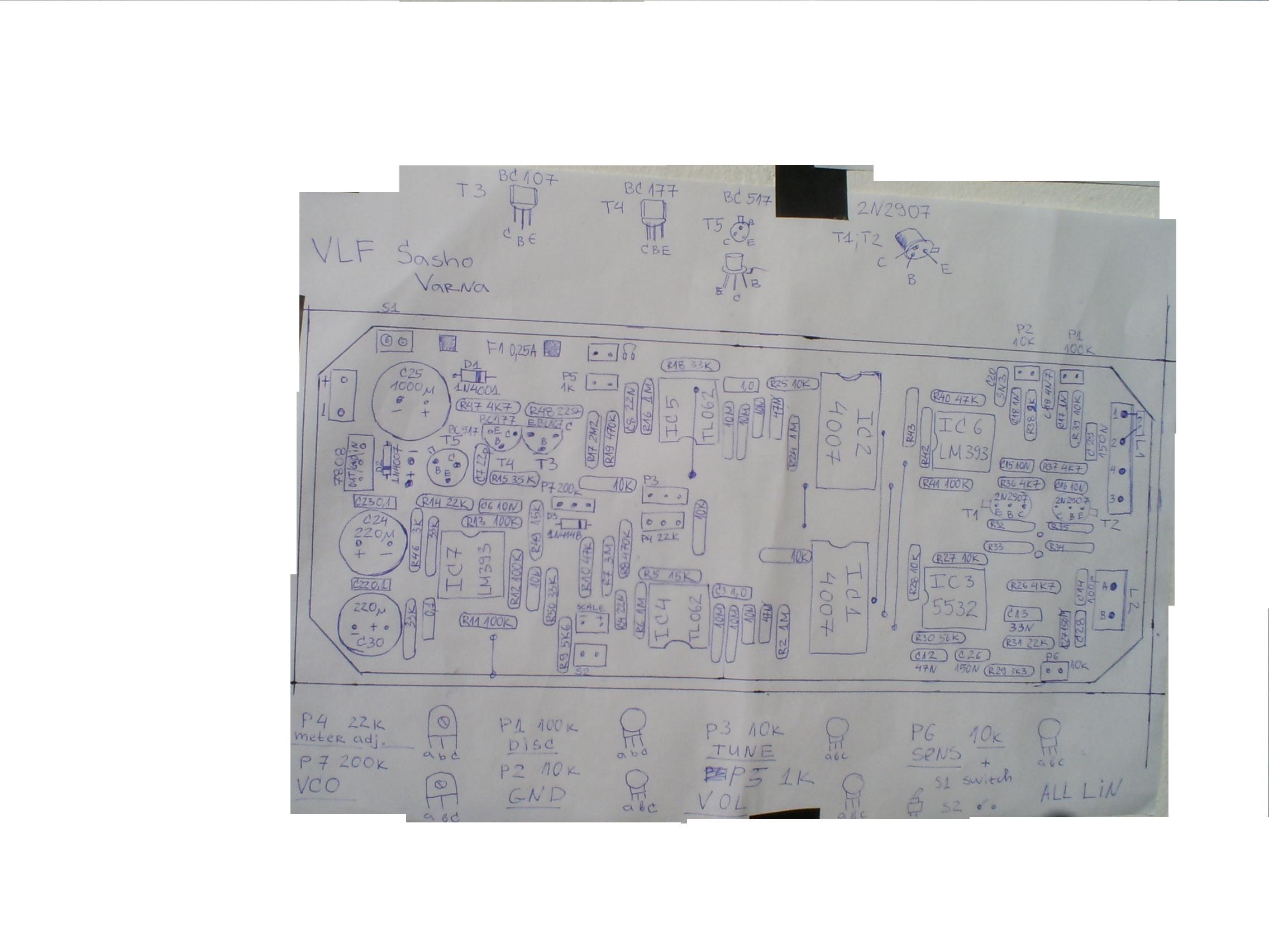

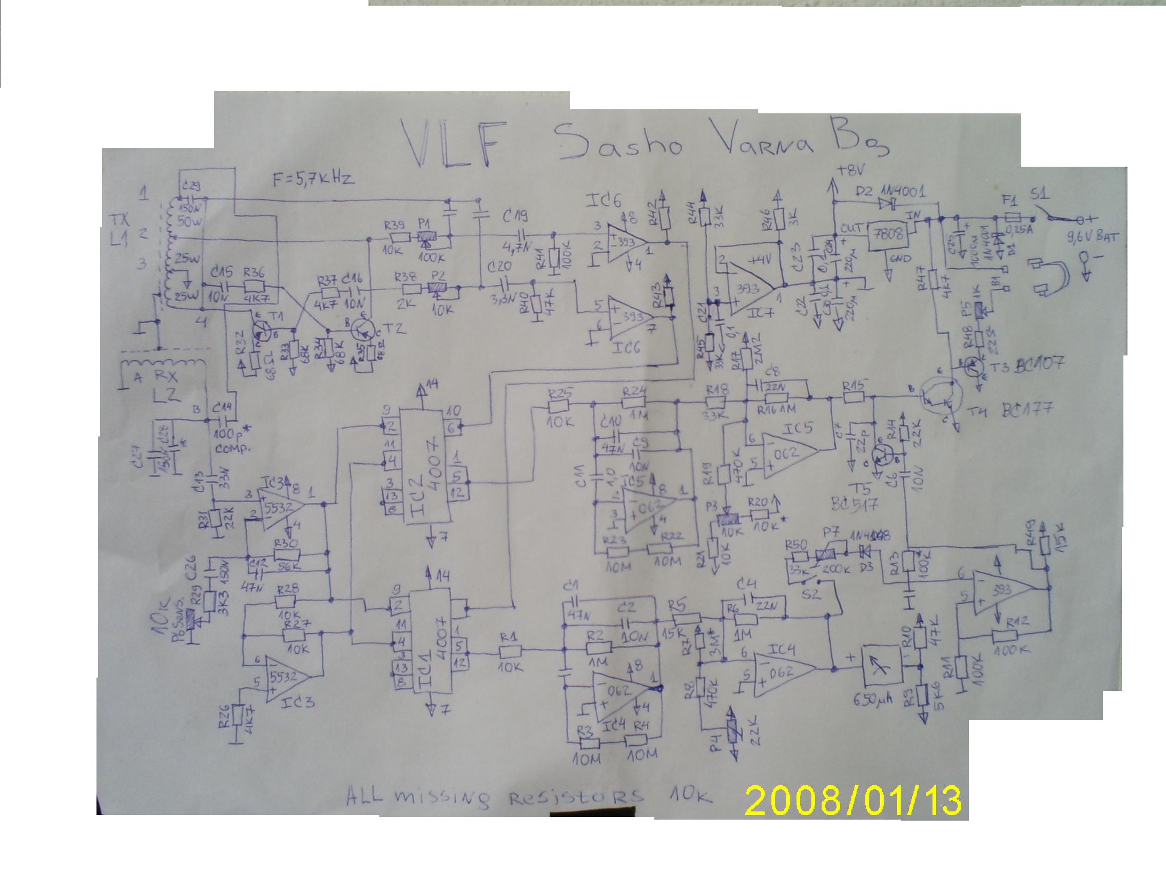

        • #64
          Leto.
          Sorry for the ugly pictures but I think that all the things can be seen.
          So now you can help me!Please revize this pictures an tell me what I have mistaked!
          I am confused with some places of resistors and transistors which is where?And how you solder their pins?Please even if you have to draw me a simple picture of transistors pins and places.
          Hope this helps.
          Please answer soon because I have soldered everithing else and waiting for your help so I can finish and test this PCB.
          • #65
            Originally posted by tiktak View Post
            Leto.
            Hope this helps.
            Hi Tiktak,
            I'm leaving in one hour, and have quickly checked your drawing..
            Sound: T5=BC107, T4=BC517, T3=BC177.. check pins twice!!
            Tx transistor pins from left to right: ECB BCE, R32,R35=68ohm, R33, R34=68k, do not forget +- cable (from regulator to TX) not seen on last photo.
            C12=47p, R42,R43=10k
            At first inset only LM393 at voltage regulator and measure voltages (+4/-4V) (from pin1)
            If voltages are OK proceed, if not - remove 3k resistor..
            And yes; resonant cap is just an ordinary cap..
            I'll return in one week - and I expect good news from you.

                  Wijdam 4e ne si otgovoril na mnogoto mi vuprosi,no sigurno si nqmal vreme.
                  Zna4i napravih ureda rukovodeiki se po Leto.No v glavata mi izniknaha o6te pove4e vuprosi i imam nujda ot pomo6t:
                  -tozi resistor R15 e 15k ili 35?Dioda do stabilizatora e oburnat naopaki?
                  -Zna4i ako sum te razbral pravilno trqbva da namerq podhodq6ta stoinost za C28 taka,4e da polu4a pravilnata 4estota 5,7Hz ?
                  A sled tova 4raz tozi 10n kondenzator trqbva da namerq maksimuma naprejenie v priemnata bubuna no c.comp C14 100pF trqbva da e izklu4en!No kak?Poneje nqmam osciloscop,a samo multimetur?Da postavq za C18 150n i da razpoq C14,a sled tova da postavq 10n condenzator na L1 to4ki 1 i 2?I da zaka4a multimetura v rejim 200mV kum priemnata bez da q otka4am ot ureda i da tursq nai golqmata stoinost?A na kraq maham tozi 10n i zapoqvam obratno C14?
                  Molq pomogni da go dovur6a.
                  Sega rabti s testova antena TX=100w 0,44mm gola jica 50/25/25
                  RX=100w 0,44mm
                  Slojih za C28 100N proizvolno no rezultatite sa mnogo slabi......
                  Znam 4e e ot diametura na jicata ama sum siguren 4e ne6to mi obqgva!!!
                  Ina4e izglejda 4e Leto si e svut6il rabotata dobre!!!!Mai vsi4ko e OK.ina4e.
                  A i o6te ne6to kakva e rolqta na tova VCO?
                  Blagodarq

                    • #70
                      Diodite do stabilizatora sa obratno za zastita pri razmeneni + i - na bateriata.Transistorite sa BC177. Na dwata kraya na predawatelnata bobina tryabwa da ima nad 25 v amplituda na osciloskop.4estotata ne e ot mnogo golyamo zna4enie.Triabwa kondezatorite v paralel na bobinite da sa ednakwi.Towa e shema za naprednali i bez osciloskop e mhogo trudno da se nastroi.Wasmogno e da vklu4i6 promenliwotokov voltmetar na izchoda na predusilwatelia-pin 1 na ne5532 i 4rez nego da nastroi6 bobinite.
