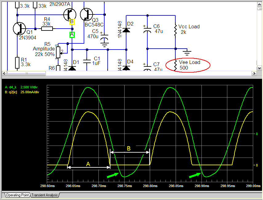

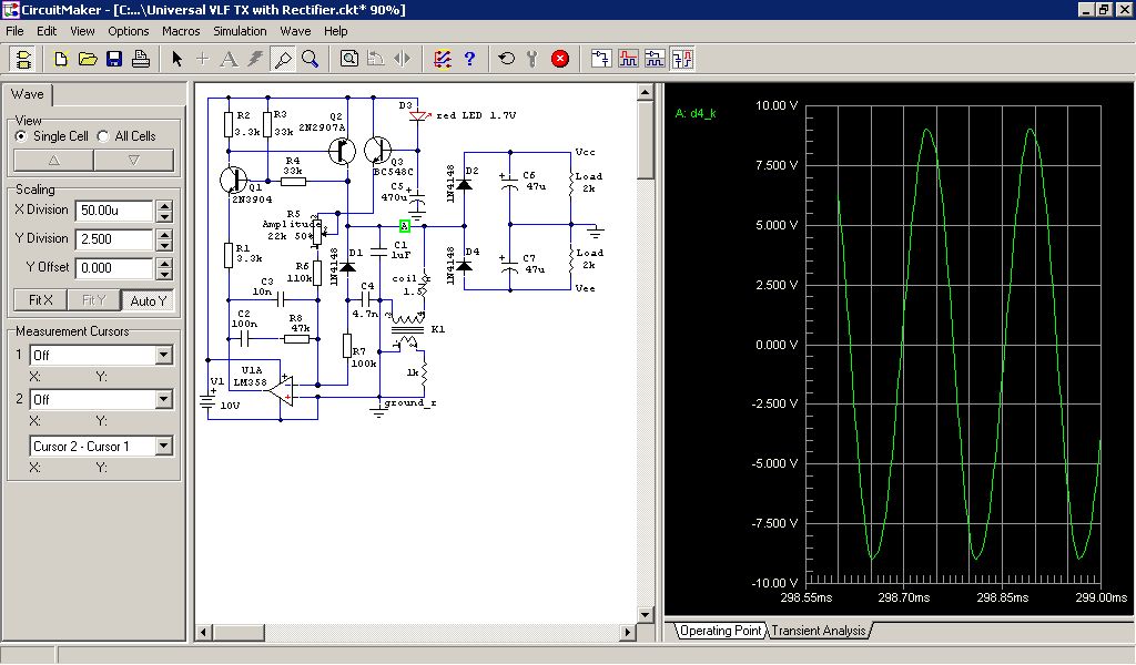

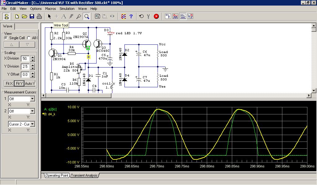

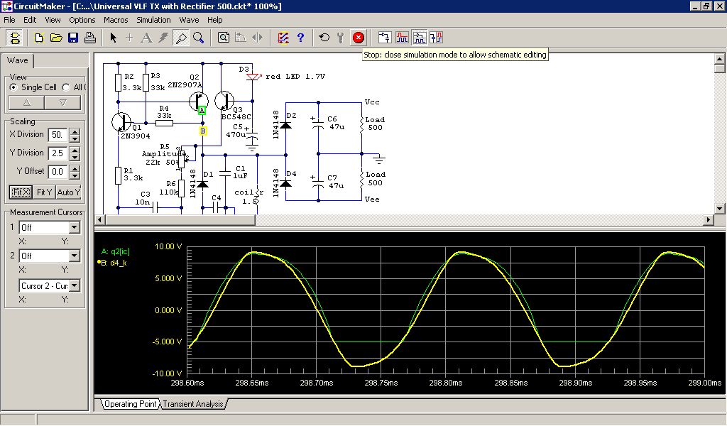

      • Hi Olivier,
        I analysed your idea in post #943 to use Vee rail for supply rest part of RX.
        For this purpose I increased 4 times current from Vee source (placing 500 ohm resistor instead 2k).
        To see collector curent of Q2, hold pressed Shift + click on collector lead.
        The attached image shows two drawbacks:
        1. Low efficiency of pumping pulse. We should decrease resistance of R1 until B=2A or conducting angle of Q2 decreases to 120 deg.
        2. Distortion of negative half-wave (shown with green arrows). To avoid this, we should use center tapped TX coil and full wave rectifiers.
        I will show the analysis of this when I have time for our hobby.

              • hi mike
                I understand why you changed only the load side negative (positive being powered by the battery) but for tested the oscillator I changed both and the distortion appear on both sides. a higher current for IC does not really help anything
                The schemat of post 949 please me well. but I have problems for the simulation. I look for the mistakes I make

                  • the green curve is the current IC (missing scale)
                    the yellow curve is the voltage
                    olivier

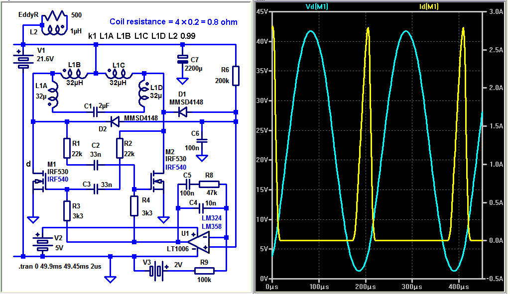

                      Davor, I'm sure that your hobby is not design of QRP amateur radio :-). An amateur designer of QRP thinks for maximal TX efficiency and minimal TX modulation. Your expression "Well stabilised and low noise voltage supply" means waste of battery energy to heat the regulator because its output voltage differs from voltage of battery rails. For max efficiency, we need battery rail to rail amplitude across pumping transistor despite battery voltage changes.
                      The TX of Relic Hawk is powered direct from battery rails, but it can't deliver rail to rail amplitude. More than 3 volts are wasted in an incompetent used cascode amplifier.

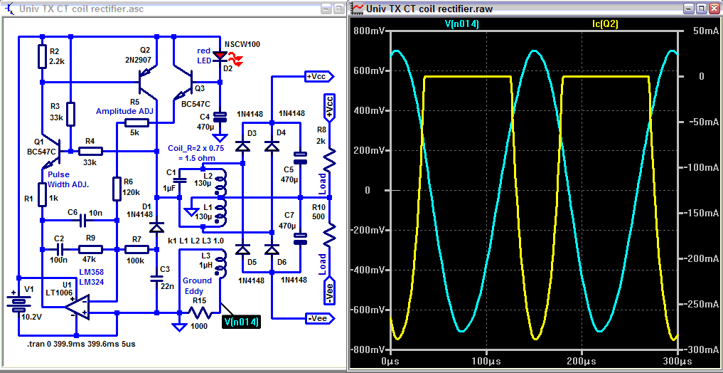

                      Here is attached the SPICE analysis for a powerful and efficient push-pull TX designed according QRP principle. The idea for this I posted in Jan. 2010
                      "The idea is TX to be powered without voltage stabilizer for maximal efficiency. The oscillation amplitude is
                      stabilized by P-I controller. For its reference voltage is used a LED. Thus, the amplitude of TX
                      oscillation decreases with depletion of the battery, but this change is slow, so no impact."

                      Therefore we should redesign not only TX section of Relic Hawk. We should redesign supply circuit for its audio section. The battery should see the audio as slowly (below 0.2Hz) changing load.
                      Here is an explanation for the attached circuit:
                      The TX circuit contains an additional schematic (not shown) to avoid deep battery discharge.
                      U1 is shown as powered with low voltage V2 to set initial operating point of M1 and M2. In reality U1 is powered direct from battery rails via a slow charged circuit to avoid oscillation start with large drain currents of M1 and M2.
                      Voltage V3 is obtained by a red LED.

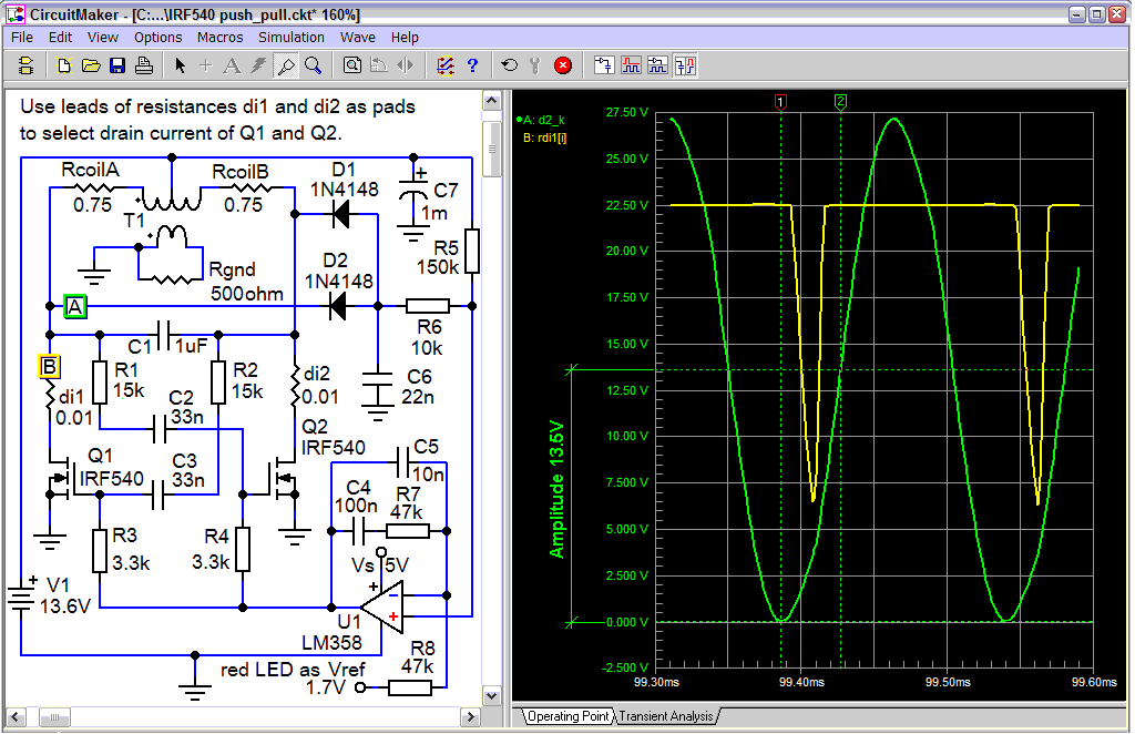

                        • Ivica, for Davor I can't agree with you, but incompetence of Minelab designers is because they have not knowledge of radio amateurs.
                          The powerful TX showed in post #955 is suitable for operation in a two box system. At conductive trace of a metal
                          pipe, it can operate with 200 ohm load between electrodes delivering 16W heat into ground :-).
                          The conductive method is described in Gemini-3 operating manual.
                          For a conventional metal detector, no need of such TX power and so expensive batteries. Below is showed SPICE
                          analysis with CircuitMaker of push-pull TX which uses a simple centre tapped TX coil and 12V lead acid battery. Note
                          that unlike original TX in Relic Hawk, here the pumping transistors operate at almost battery rail to rail amplitude.
                          To make SPICE analysis of this variant using LTspice, you can open the compressed file attached in post #955, delete
                          two sections (windings) of TX coil and change other parameters and battery voltage.
                          With this TX circuit we can end the redesign of TX section in Relic Hawk and start redesign of its RX section. The RX is
                          also incompetent designed.

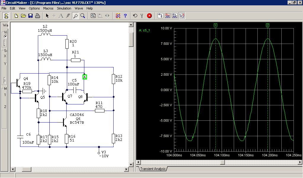

                            • hi
                              hi
                              in the same style but the oldest of the oscillator vlf 770
                              olivier
