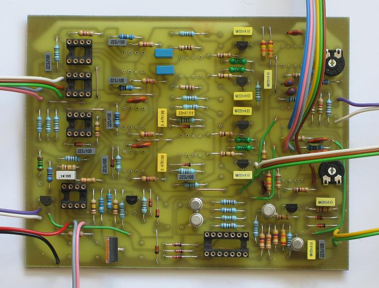

    Did you made this detector by this board ,,how it work?and which dimension is board?
      i received from a friend , i need to speak with him but i will redesigned

                Why do you need to Re-Design it?
                The PCB actually Looks pretty good already.

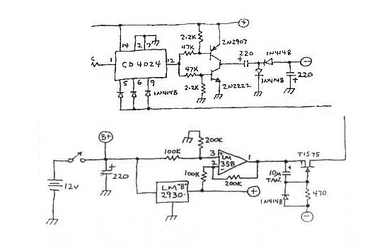

                Is that Schematic Correct?
                  i received that from a friend and he promised me that the shematic is correct.

                    I looked at shematic and almost all the parts were also in my el. junque box.
                    As I was free yesterday I etched and populated the board..
                    .. few parts are still missing -10caps and IC-sockets

                        I KNEW IT ..
                        I tried first the power:
                        positive rail:8.0V
                        negative rail: 0.74V - not even negative
                        Of course rest of the circuit not working, no oscillation, NOTHING!!

                        Hi Max, as you can see it looks like a >faked shematic< and consecutively someones failed PCB project..? PCB is really nice and no mistakes were found according to shematic.

                          Hi Leto,
                          yes pottery make me crazy...and I'm actually dealing with some bandido disc stranges but interested in similar circuits too.
                          I think that something could be wrong in that schematic in the osc section:
                          - if you have no oscillation you can't get -5 volts from charge pump
                          I don't understand why there is a fet near tx transistor base...I think the error could be there. I think that polarization of tx transistor is wrong and that caused you have no oscillations at all.
                          The circuit can't provide real -5volt (like in bandido) but think it's not a real problem cause lm358/lm393 work happy also with -3v. What's little critical are lf353s that I had bad experience with lower voltages. But think it was correct for this circuit to have them. Maybe you could use ls204 instead of LFs having less problems but think you need to solve first voltage converter/osc problem.
                          To make a try you can:
                          - disconnect 1n4148 from collector of osc transistor
                          - short source and drain of fet tis75
                          Then you can test is oscillations are present and charge pump works
                          Do this without other components like ICs to avoid too load and other problems.
                          If you get oscillation ---> problem is in tis75 polarization network
                          If you can't get oscillations ---> problem is maybe transistor gain (too low) or resitors connected on base of it (passive polarization network).
                          If you solve that problem you can get steady -5v using 79L05 and increasing negative rail voltage to at least -8volts (dropout is 3volts) or better with an ldo negative voltage regulator for -5 volts (usually dropout is under 1v).

                            PERFECT...
                            sweet words: IT WORKS
                            Thanks to you Max, you pointed me in right direction...problem was with low inductivity of TX coil I used. I hooked the tx section to RX coil and used TX as recieve coil. --> and it worked.

                            P.S. I found two versions of Golden Sabre schematic on net, use the one kurtie100 posted in this thread.
                              Golden pcb looks OK ....
                              Wrong schematic drawing: after sens comp. 100k -> anode 1n4148 ?
                              Schematic some wrong resister and cap values.
                              In -5v power converter 47k = 4k7
                              In ground/all matal 150pF is 15 pf
