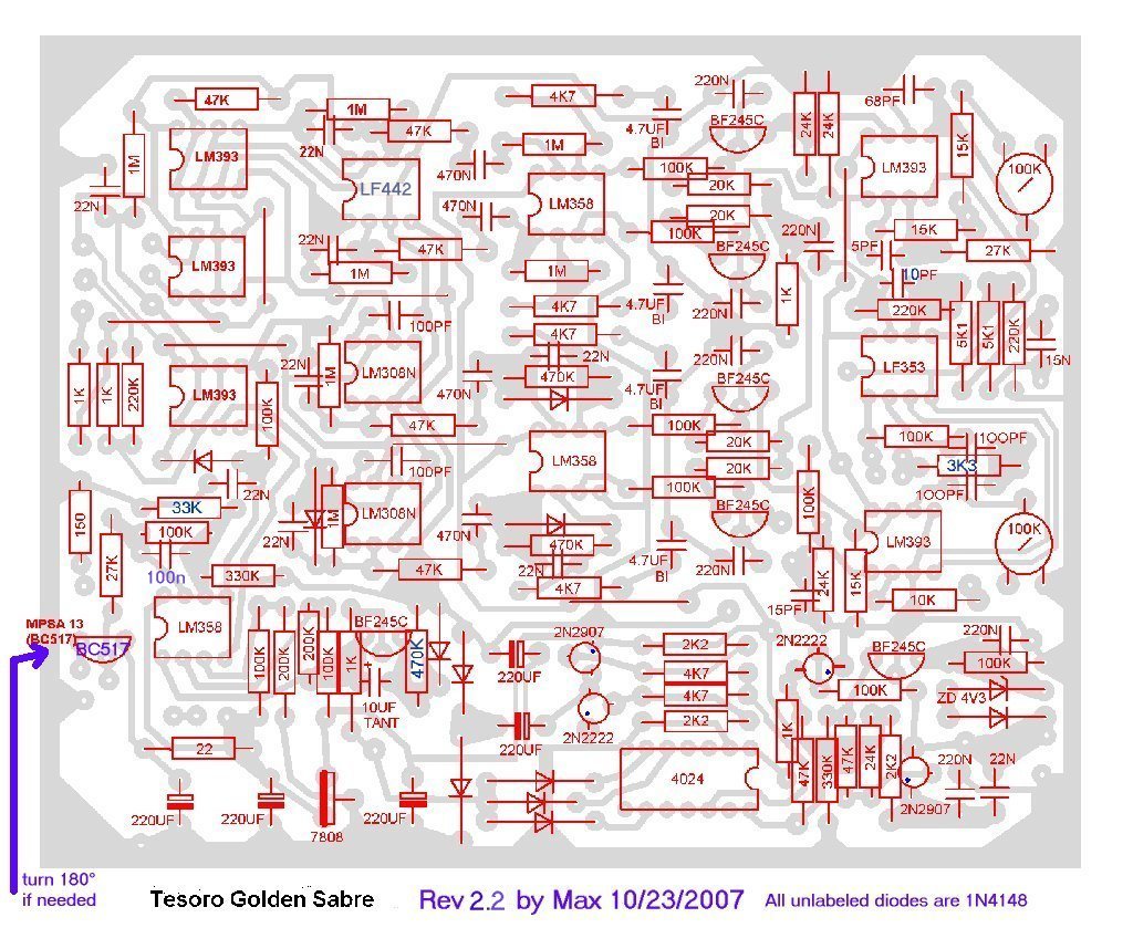

  • Max,
    The value of the cap below the "new" 33k resistor is missing.
    A good idea would be to put numbers on the Ic´s so it is much
    easier to find them on the pcb.
    Just an idea,if you want to improve even more your work
    My detector is working very poorly,25cm max ,disc and notch working,sensitivity makes no much diference.Some oscillograms are not the same than posted by you, i have work to do to find the fault(s).The output tx coil and output of lf353 are ok thought,180º and looking good.
    This is part of the fun...i guess.
    regards,
    Fred.

          Max,
          regards,
          Fred.
          yes... was old mistake... I missed that... thanks.
          New revision.
          Kind regards,
          Max
          PS: I think that for part numbers would be better if someone will provide e.g. the original layout file... cause would be a bad thing erasing too much stuff to make room for them. It's easy adding them by the layout program instead of using image manipulations prog.
          • What's the story with 3K3 resistor there? It is marked blue. Why? I never modded it...
              in original PCB file was 3K9. If you use 3K9 you mod a bit disc section behaviour.
              Anyway... no big changes. Try it.
              Best regards,
              Max

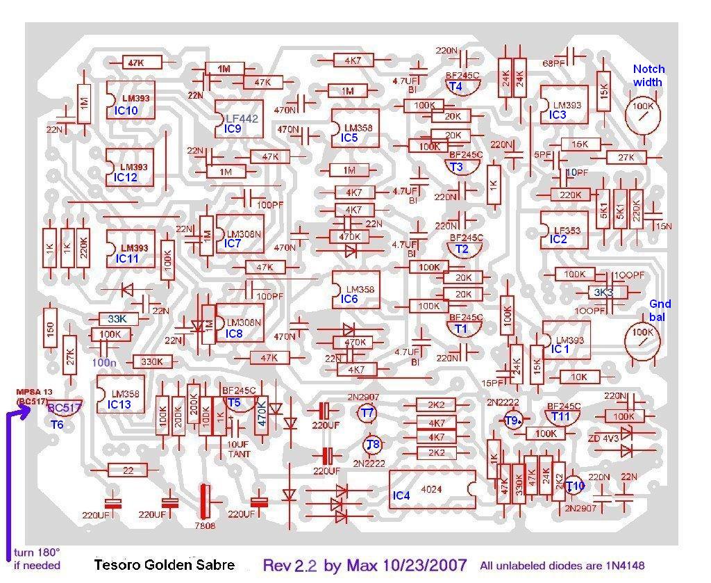

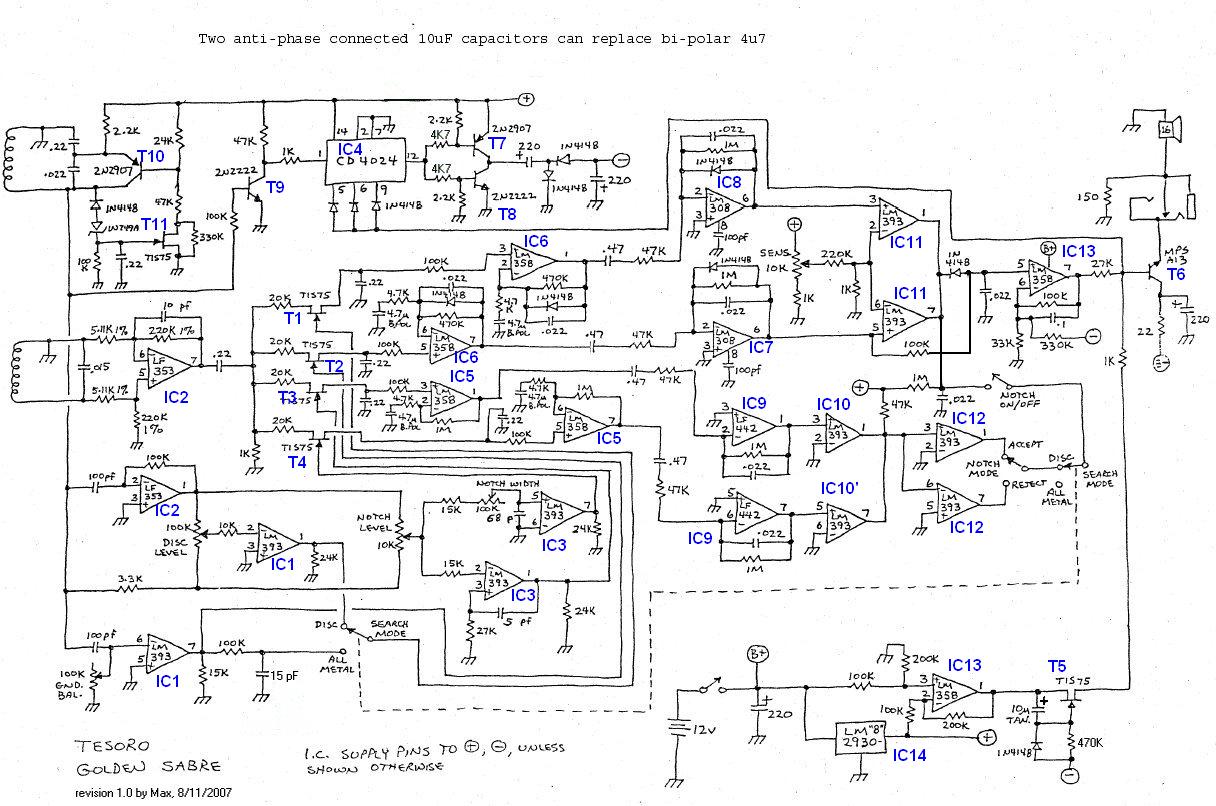

                            • I post here the schematic and parts layout with IC´s and transistors numbers.
                              In conjunction with the oscillograms from Max it is perfect for troubleshooting.
                              Fred

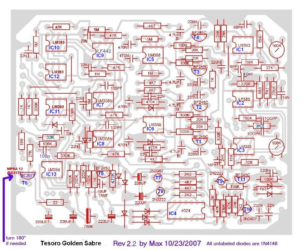

                              • Wrong IC1/IC3
                                corrected:
