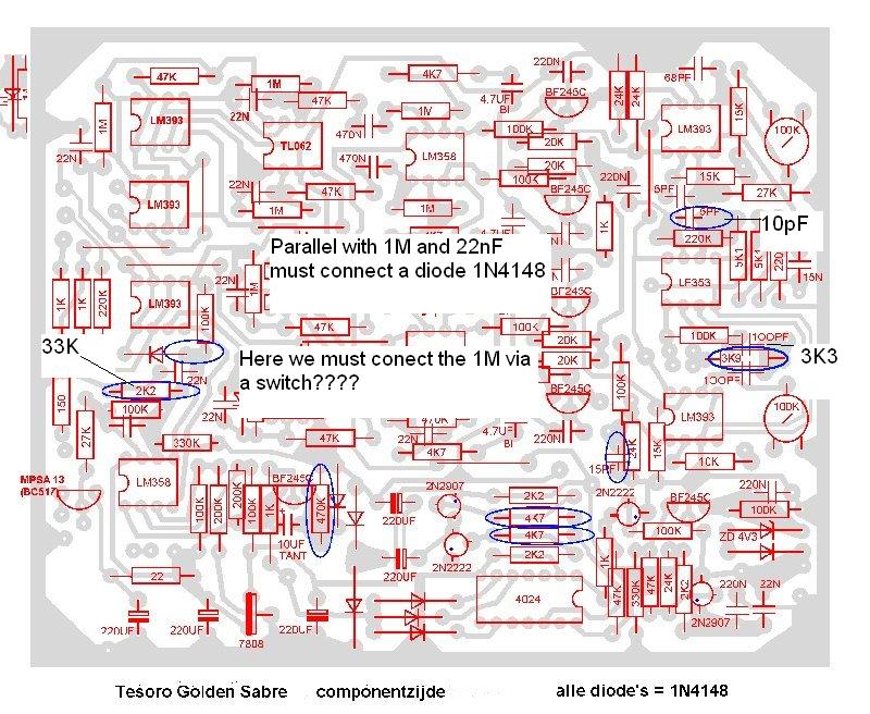

    I did that. When switched ON it producing "beep,beep,beep,beep..." non-stop and
    now way to calm it down, whatever i did.
    "..I do not have a 20-turn pot on my detector, and ground balance is quite easy to achieve.."
    So i replaced ordinary with multui-turn pot at GEB. Fine adjusted with it to produce
    0.000vV. Zero - crossing you've explained above...It was easy (as you said) to adjust to
    0 volts. Of course without any metal arround coil. When metal is presented near the coil
    this voltage is not 0V any more but respecting signal strength it raises...
    I made some measurements at analogue switches.
    Rotating GEB trimm. gave me range from -7.66mV to +180mV at switch output (TR5).
    Rotating Disc. pot gave me range from -130mV to -190mV at Fet output (TR4)...BUT!
    Rotating Disc from one side to other, as approaching to middle point, voltage reversed
    and somewhere at the midddle of pot it reads +330mV, further rotating lowered it to -190mV..
    I checked everything again and again...still no solution!
    Only way this TGSL to work very good without beep's is to Set Disc. at "3" and higher and
    Sens to "6-7" in Disc mode. GEB trimmer is adjusted as described above. Adjusted like
    this, TGSL is very deep,good discrimination...on the field it can produce very rare...but
    very,very rare "beep's"...usually when coil hit some stone or bulky grass, harder...
    In All metal mode i have to lower Sens at minimum to make it at least a bit useable..?
    I do beleive that source of problem is somewhere after front end. Why?
    OK, when switched ON it is silent. Than i provoke it to "sing" with some coin or simillar.
    It wont stop as i move away that coin. So, i noticed if touch 3 lead cable (5cm long) from
    pcb to Disc. pot...it stops with "beep's" at once??? When cable released it still remains
    calm - no sound. Again when coin is moved over coil, it "beep's" without stoping?
    If touch randomly other parts on pcb, sometimes i can stop it. But most significant is
    that cable and Disc. pot. It stop with "beeping" always, when those are touched with finger?
    Also rotating Disc pot has much more influence on detector behavior than anything else.
    Rotating Sense pot doesnt affect anything noticeable. Also rotating GEB trimmer wont stop
    once provoked "beeping" at all...??? Damn!

      BTW i found a huge source of noise here! Damn! It was damn Disc. pot 100k...I replaced it with brand new one and all blleps stopped in Disc mode!
      But it was new also!? Damn!
      Now i have some bleeps only in All Metal mode...
      Damn!
          Damn!
          yes sometimes graphite layer is so thin that produce noise also in new parts.
          Best you can find is wire wound (like multiturn) pots... but too expensive for more than one detector having that.... then they are also heavy 3 or 4 times a small pastic one or aluminum boxed type.
          Instead try an LM393AN at last comparator to gain better offset level... could reduce noise.
          Kind regards,
          Max

            Yes, it was damn Disc. pot from the begining. I have 8 finished pcb's here at my workshop. But choose only one as testing pcb, for nulling and testing coils. By damn Marphy's law that one pcb was only one with bad potentiometer...! Damn! that's why i had so many problems last few days....
            It was infront of my eyes and i couldnt see it!!! Damn!
              You missed it! Already there, see R54..
              Damn!
              If you look at the schematic posted earlier, where I asked you to disconnect pin 1 of U106A, there is no 1M resistor. BUT - if I look again at the original schematic, then there is a 1M resistor, but it is connected by a dotted line with some words that say "To check this!". Must be an old schematic.
              Glad you have fixed the problem.

                            • I attach here the pcb with errors that Max sent here. I have checkthe 10pF... the 1M and one diode that there is at the schematic but no at the pcb. Tell me if are correct.
                              I have 2 LM308 with metallic case. Where is the ledge??? Ivconic said that it is on pin1......... i looked at datasheet and shows it at pin8. Who is the right.... the shop had only 2 pieces so i dont like to burn it.
                              • No Geo! Beware! I sad that made MISTAKE considering pin 1. under notch...
                                It is pin 8. under notch not pin1. !
                                Yes there are 4k7 resistors in chopper, not 47k as showed in schematic.
                                There is also 2k2 instead 33k....
                                about 470k in battery test....i put 470k,it is working...
                                1M resistor goes parallel to diode...only if you want to boost audio. For now do not put it.Leave as it is...
