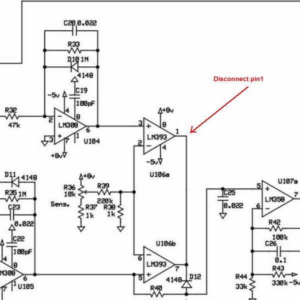

                    Maybe there is some quirk in the TGS design that causes this problem.
                    I've just been studying the TGSL schematic. It is the same double-differentiating architecture that I'm using. However, there is one interesting thing about the TGSL design that I think could make the TGSL easier to ground balance, which is even more of a mystery why you're having problems. When it's switched to All-Metal mode the DISC channel is still active, but instead of being sampled with the DISC sample pulse it is sampled by a slightly delayed version of the GEB sample pulse. This has the effect of creating a small dead zone that should make it easier to locate the GEB sample pulse over the zero-crossing, with the result that there is also some tolerance to changing ground conditions built into the design.
                    Here's an interesting thing you could try (see attached diagram).
                    Disconnect pin 1 of U106a, which will effectively disable the DISC channel, and let us know how this affects the ground balance.

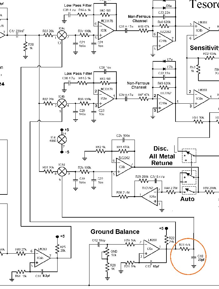

                      Hi Qiaozhi,
                      yes right... it uses the 100k+15pF network that introduce a delay respect to GEB main signal (actually there is a phase shift cause of the respect main GEB signal... so the second gate is driven by a signal shifted by a particular angle that depends on components and frequency of triggering).
                      A similar thing you can see on one line of bandidoII schematic GEB+delayed GEB control 2 analog gates... though it's different from TGS that has a more basic approach.
                      The difference is that on BandidoII , in all-metal, you have a total disconnection of the 2 disc channels (non-ferrous/ferrous) and the delayed signal directly drive the "magnitude" output stage (integrator+threshold amplifier) in TGS the upper channel (used also in DISC) is actually as the "output stage"... cause TGS hasn't a separate just "magnitude" driven output stage... maybe cause it hasn't motion/non-motion all-metal and so don't need that 3rd route.

                          Would it be possible for you to disconnect pin 1 of U106A (as mentioned earlier) and tell me what effect this has on finding the ground balance point?
                          • I'll do that.
                            Are you awake still? For how long you will be here?
                            If you plan to stay a while (30minutes) i can do that now and later inform you...

                              I suppose that when you put the iron washer inside middle of coils you get a shape variation of TX signal due to the magnetic losses and added histeresys(and eddy current flowing in) influence of the washer. If so... you'll end-up with a not perfect sinus also at RX and then when you measure it the multimeter just cannot read it well cause of distortion of the sinus... and you get 0 or near that... where I suppose you have greater voltage in the 10-15mVpp range.
                              About bleeping Qiaozhi is right about the two channel config of TGS... this actually could introduce problems when the 2 gate signals are separated by few delay due to the 100k-15pF network... expecially due to the differential comparator config you see before output stage.
                              I think that using an LM393AN , with less offset than standard 393N, could minimize that (and of course I have it on PCB)...but don't solve it totally.
                              If Qiaozhi found the real problem we could just add a section to the switch of mode... then disconnecting the pin1 when in All-metal position.

                              • "...Disconnect pin 1 of U106a, which will effectively disable the DISC channel,
                                and let us know how this affects the ground balance..."
                                I did that. When switched ON it producing "beep,beep,beep,beep..." non-stop and
                                now way to calm it down, whatever i did.
                                "..I do not have a 20-turn pot on my detector, and ground balance is quite easy to achieve.."
                                So i replaced ordinary with multui-turn pot at GEB. Fine adjusted with it to produce
                                0.000vV. Zero - crossing you've explained above...It was easy (as you said) to adjust to
                                0 volts. Of course without any metal arround coil. When metal is presented near the coil
