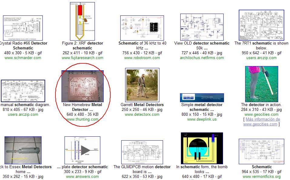

      • Hi Ivconic! Nice exploration! You're very famous! When I write on Google images "metal detector schematic", your name appears on PCB!
        Esteban

                • Originally posted by Esteban View Post
                  Esteban
                  Main point of interenet is to allow anonymus person (like myself) to reach others arround globe.
                  But in this,our, hobby....it is better to stay totally unknown..

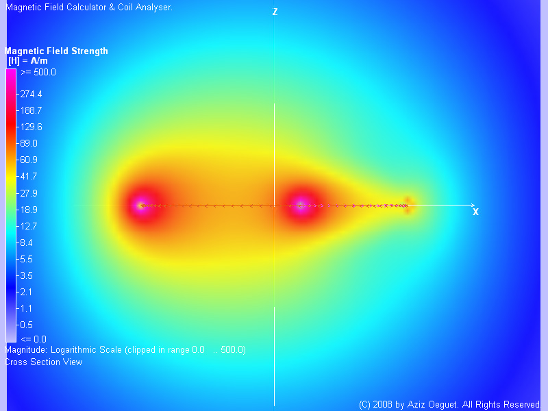

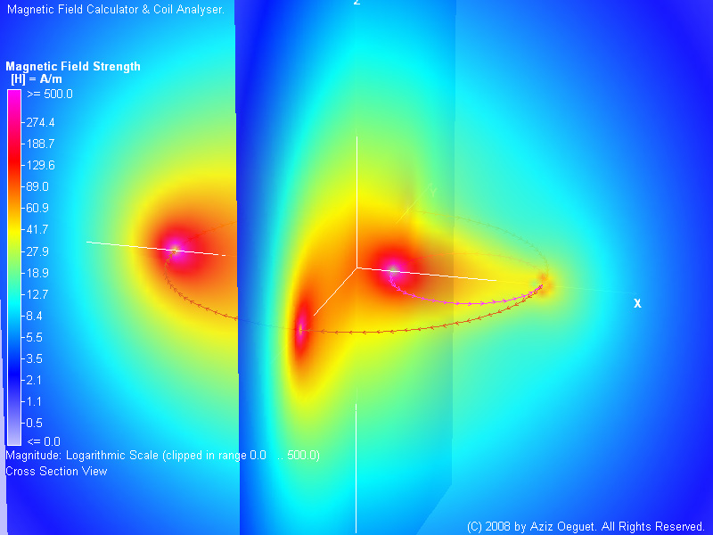

                        • Omega Coil
                          Another view:
                          • Thanks for the description and visualisation. I know now what omega coil is.
                            For all, who are interested on magnetic field strength distribution, see picture below. I should make more simulations in the future.
                            Aziz
                            • Next: another view of magnetic field strength of same coil above.
                              • M Field
                                Hi Aziz
                                Interesting, congratulation, and hope usable in measurement not only programming toys.
                                But what is input parameters (how coil shape is influenced in visual xyz results?)?
                                What happen if you put third cold coil somewhere in field, can you to define it?
