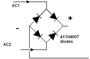

    I will try build this circuit.I cant understand what is B1?I already have lm317T and will buy the rest of the parts tomorrow.But what is this B1.As I see I must conect + from ac/dc adaptrer to diode D1.

      is a bridge rectifier... you need a 1A rated (or more) bridge like in the picture below. There are also different, bigger case , flat type also but signs are always the same.
      The wave signs go to the ac adaptor (or dc one, same thing you need 16volts or more there), then the + and - are connected to circuit and give you the positive and reference voltages.

      • B1 is a bridge rectifier.
        You can buy it or build one as follow, good up to 1 amp.

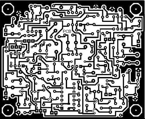

              I've made a board... but then realized it's wrong side ?
              So I think this is the right way for copperside.

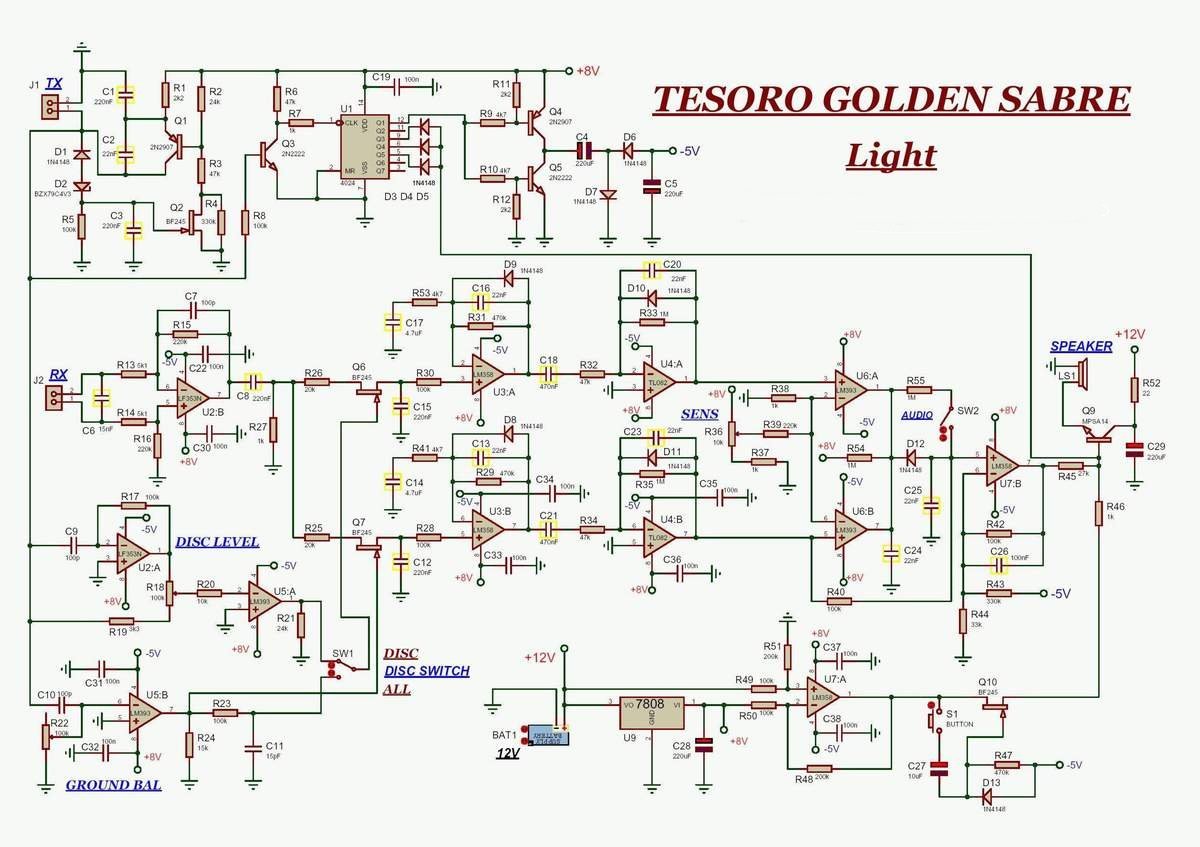

                Another strange thing is that on this PCB there aren't the decoupling capacitors of 100nF I can see in Ivconic's schematic for TGSL... maybe cause of limited space.
                Are there decoupling in Goldy PCB ? Who knows ?... I remember not.

                  Hi Max,
                  Your work looks wery nice, wich program you use for drawing PCB's?
                  I'm not sure what is "decoupling" but maybe is this one located below 4024 as SMT one in Vladimir's version of TGSL PCB.

                    the PCB design is Vladimir's work... not mine. I've just cleaned up the colors to make big contrast in print of it.
                    I think he used maybe sprint layout to do it.
                    Capacitors I mean are like C22 or C30 in Ivconic's schematic...at supply pins of op amps... of course one could choose to connect them on the copperside soldering on existing pads and gnd tracks... if needed.

                      Hi Max,
                      Schematic you posted here is with TL082. I use PCB drawing and schematic from PDF earlier posted here and this schematic is with LM308s. And all is ok with schematic and PCB drawings.

                        yes I think this is the last posted one by Ivconic that uses TL082. I've made the board... though I had a problem with orientation of printed film first time... so I've made a wrong board first time and a remade just few minutes ago... so I have it now.
                        As I see in your picture your PCB is different: does it work good ?
                        I'm thinking of making this last version... using the double op amp. but not TL082... I'll check some components and see the effects.
                        I think I'll find some good dual instead of 2 LM308 this time.
                        But I think I need some luck...
