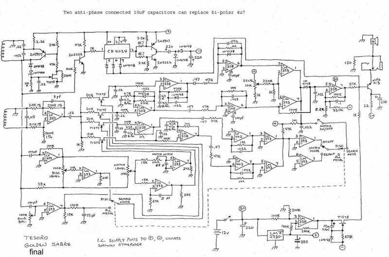

          I am same way, need to understand. The secret is to understand the "Synchronous Detector" part of circuit, which are the two JFet transistors after the receive coil (RX coil) pre-amplifier stage. The two transistors simply act as switches, driven on and off by square waves (not really so square) derived from the transmit oscillator connected to the transmit coil (TX coil). Google "synchronous detector" and "lock-in amplifier" for theory.
          Each transistor is driven by a different phase, approximately 90 degrees difference. The exact phase is adjusted by the ground balance control pot on one "channel", and the discrimination control pot on the other.
          The synchronous detector essentially converts the received oscillating signal into a very low frequency pulse in each channel. The size of the pulse is determined by the strength of the signal stimulated in the metallic target under the ground, and also by the phase of the signal. Different metals respond with a slightly different phase.
          By adjusting the discrimination control, you can make the synchronous detector of the "discrimination channel" create a negative pulse for signals with a phase less than a certain amount and a positive pulse for signals greater than a certain amount. The "ground balance" channel makes a positive pulse for all metals, and is adjusted so that the soil in the earth, which responds similar to the material ferrite, will not make any pulse at all.
          The two pulses are amplified in separate "channels", then fed to a comparator. The comparator will only make a positive output voltage if both input pulses are positive. The output of the comparator is low-pass filtered slightly (to reduce chatter from quick noise pulses) and fed to a final op amp which triggers an audio tone if the comparator pulse is above a threshold.
          The oscillator in the circuit does dual duty -- it drives the transmit coil, and also drives a counter circuit which itself does double duty. The counter circuit drives a push pull transistor combo which is rectified and filtered to create the negative power supply. The counter circuit also divides the oscillator frequency down to an audio tone for the headphones/speaker.
          Well, that's a thumbnail sketch. Got to go for now....

                • One compatriot also made TGS and mailed me this link with demonstration.
                  Nice to see.
                  Device is acting just fine.
                  http://www.youtube.com/watch?v=kKWqNyInTEE
                    "...only other difference is 33k at last LM358, this is 2.2K...."
                    I was thinking about this many times in the past. 2K2 option is giving descent audio level and at the same time such treshold, enough to keep audio spikes almost calm. Sometimes, in some cases, when coil is not best suited and with 2K2, audio may have some chatters, reminds mostly on instabillity.
                    Yet, than 10K there will solve chatters problem but audio level would be decreased significantly. But if we adopt 33K as right value there, "stabillity" would be great and sound bairly audible...if any.
                    So i dont think 33K is possible value in any case.
                    I am rather prone to beleive that W.Lahr (if he put 33k on schematic) deciphered that resistor wrongly. It is not the rare case some resistor colours to dim in time, so most likelly 3 red "rings" on resistor could easilly look like 3 orange "rings" (red-red-red=2K2 and orange-orange-orange=33K).
                    So if man take skim look on resistor mounted on pcb, it is easy to be fooled by some colour changes due any objective reason.
                    My experience tells me that 2K2 resistor is right value there - original.
                    totally agree: it was a mistake reading color rings caused maybe by wrong light on pcb at that time... or by too fast reading without e.g. a lens to check more carefully.

                          • TX Voltage
                            Did some measurements on original TGS with original coil (8 inch)
                            TX Voltage = 8.2 pk-pk! Was very shocked this was so low! Checked supply voltages (11.8V batt, 7.9V off regulator) so those are OK. Could be due to coil (Tx ~23 ohms) but seems very low. Any ideas why?
                            Also looked at Tx Rx signals on scope. Are many different from handmade with DD. Rx shift to left with copper coin. Will have to do better experiments, to much rush now.
                            Also one more component difference (on schematic) 10pf cap on pins 6 & 7 of LF353 is 5pf. Don't think big change but that is it. I update schematic.
                            Molzar

                              • Originally posted by Molzar View Post
                                Molzar
                                I believe that voltage is perfectly typical. My circuit gets 10 v p-p. The reason I think is the feedback through the JFet TR2. Every JFet has different Vgs-cutoff voltage, which affects when it starts limiting the oscillation voltage, so we all get different TX voltage. Try Ivconic's trick - bypass the JFet by connecting the source to drain and then check the Tx voltage - it should jump to about 16 v p-p. But the waveform may be quite distorted, I don't know if that matters or not.
                                I just tried this with my circuit and it did not change the depth significantly -- surprised me! But my circuit is not tuned up well at this time, and much noise around. Still, I expected to see more effect.
                                If you want to increase voltage without distortion, you can add diodes to the zener diode to change the threshold voltage in the feedback path (LEDs work well), or find a JFet with different Vgs-cutoff voltage (I think you want smaller Vgs-cutoff). With these mods, you can probably get 14 V p-p without much distortion easily.
                                (I don't mean mods on original TGS! Of course leave as is! )
                                -SB
