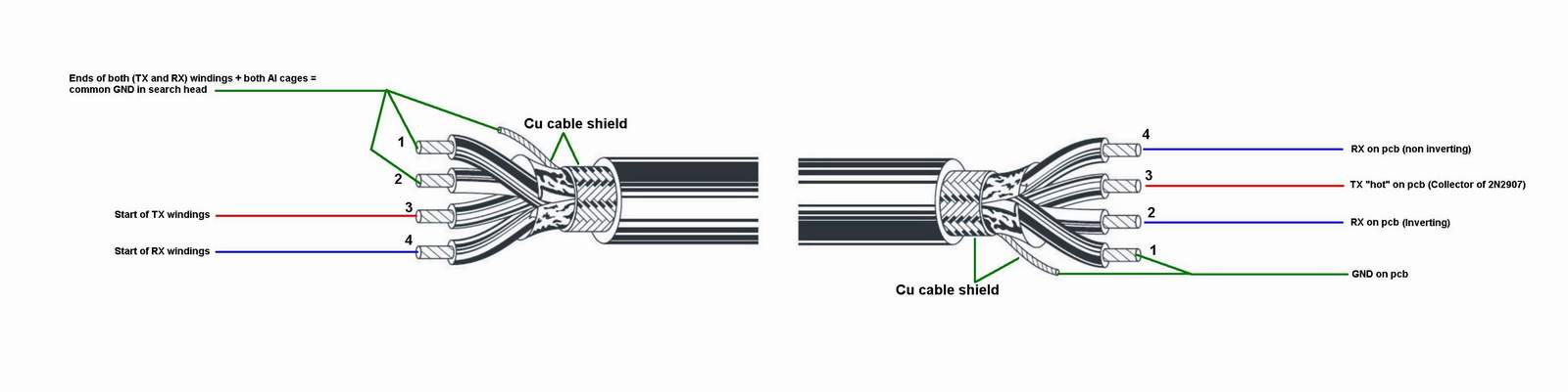

    This is my usuall setup. You may notice that i am using 4-lead cable. It is acting excellent. I made over 30 devices so far using this setup.
    Actually...no need for 4-lead cable here. 3-lead cable will do the job just fine. I am using 4-lead cose it is easy to obtain it in local shops, here.

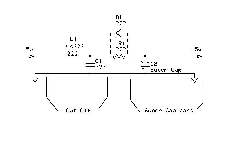

      Actually, i was thinking to experiment with more complex filtering;
      super cap and small choke.
      Now, job is to accuratelly calculate choke for this filter... we have 3.5-7kHz (approx) spikes there.. So choke must cover that bandpass.
      Hmmm.... i would not be offended much if somebody help here with choke calculations..!
      so I think you mean we need an LC low-pass at 3.5Khz cut-off, right ?
      Anything above in frequency will be attenuated by 20db/decade constant slope, ok ?
      If so... suppose your big capacitor is 47000uF (47milliFarads) you'll get from forumla of simple LC low-pass that frequency of cut-off is by:
      F=1/2*pi*sqrt(L*C)
      ... so the sqrt(L*C) = 1/2*pi*F
      then L= 1/(4*pi^2*F^2*C)
      now F = 3.5Khz = 3500Hz
      Then L= 1/(4*3.1416*3.1416*3500*3500*0.047) = 4.39E-08
      Then L = 43.9nH (about) to get required cutoff.

        43.9nH !!! Sheeeesh!!! Where to find such small choke!?!?!
        • Or....let's "humanize" choke value and use some other capacitance in formula, ok?
            It should be fine to use bigger choke as long as resistance is very low. You only want to pass DC (zero frequency), so why not use bigger choke and make cutoff even lower?
            -SB
              you just asked for the value... not where you could buy one!
              Anyway... I think nH level inductors can be made about easy at home!
