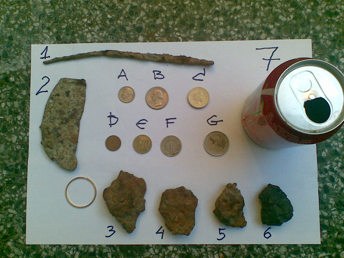

                  • Here are some test targets to be more specific in future.
                    A-10C US;B-25C US;C-one pound GB;D-1Euro cent;E-10Euro cent;F-1dinar1974;G-2Euro coin.
                    1-rusty iron thing;2-rusty half of horse shoe;3,4,5-hot rocks/or mix with melted iron with different size/;6 is my favorite hot rock;7 coca cola can;
                    We now that we should expect:
                    *1e coin = 32 to 36cm in air
                    *cola can = 55cm in air
                    if device is ready.
                    Ups I forget there is also 3,5 cm brass I think ring.Which turns to be most favorite target for TGSL.

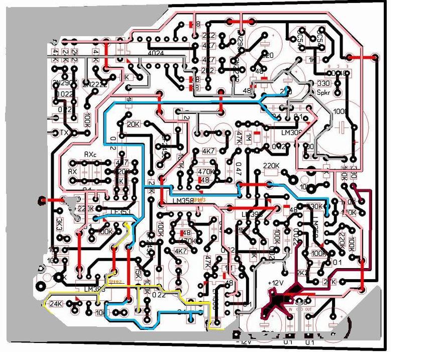

                      • Ivconic,
                        I have searched last version and now there are few questions that bugs me.
                        Isn't yellow line forming bad ground loop that could cause noise problems?
                        Also U102 and U103 dont have 100N comp.cap!Why?
                        • Originally posted by Ultimate_Haze View Post
                          Ivconic,
                          No, not at all.
                          U102 and U103, yes those are not having decoupling capacitors. Why? I dont think those are neccessary there at all.
                          If your pcb and components on it are correct than only problem would be your coil. Doesn't matter how many coils you made if nulling wasn't done properly. I guess, you must done something wrong in process of nulling coils.There is some little mistake you probably repeating at each coil.
                          It is difficult to predict what that mistake would be.
                          As repeated so many times; coils do demand serious attention in process of making, shielding and balancing (nulling).
