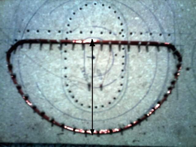

        I have several configurations that I can see here for DD 22 cm!
        Which to use?
        DD22 cm:
        Former d=?
        Outer d=?
        Tx turns=?
        Rx turns=?
        wire 0,30 mm with varnish.
        p.s.I have used TL082 insted of LF353.Try TL072,but no differance.Now will order LF353.
        But my probleme must be coil.
        Try this:
        OuterDD 22cm
        Former diameter 19cm
        wire as you said (that is about 0.28 without varnish)
        TX turns = 140
        RX turns = 145

              Can you tell me what is this distance in cm-s for my DD 22 coil?
              Shell I use this angles that ivconic shows on this pictures,or the shape of coils should be D?

                  Hi tiktak,
                  picture posted is right for you. You can follow as guide , no need of perfect D at all. Then null as always.

                    But I am wonderind how much should be the distance that I have draw on this picture!If the coils should be 22 cm when asembled then I think that this distance must be more than 9,5cm?For the high I now 22cm but how much should be this distance,so when asembed to be 22cm?
                    Maybe 10,5 cm or 11?

                        • Nelson,
                          What is this distance that you use/look at the picture in my previous post!/for your DD 22 coil?

                            Hi tiktak,
                            follow my instructions... I get 27cm steady for 1 eur coin with my DD22. Very stable performances, very stable detector operations, no hums, nothing at all now. Used TLC2262 instead of TL062.
                            Find the damn LF353, other things work (e.g. TL072) but 353 is better there, till now.
                            Tested in all-metal and disc, noticed that in disc I lose about 1cm... due maybe to pot setting... have no time to play with now.
                            In disc mode it rejects nails and even hammers !
                            It's a damn good detector, great disc, great stability. I think that with some mods I can beat bandidoII soon even on depth sector.
