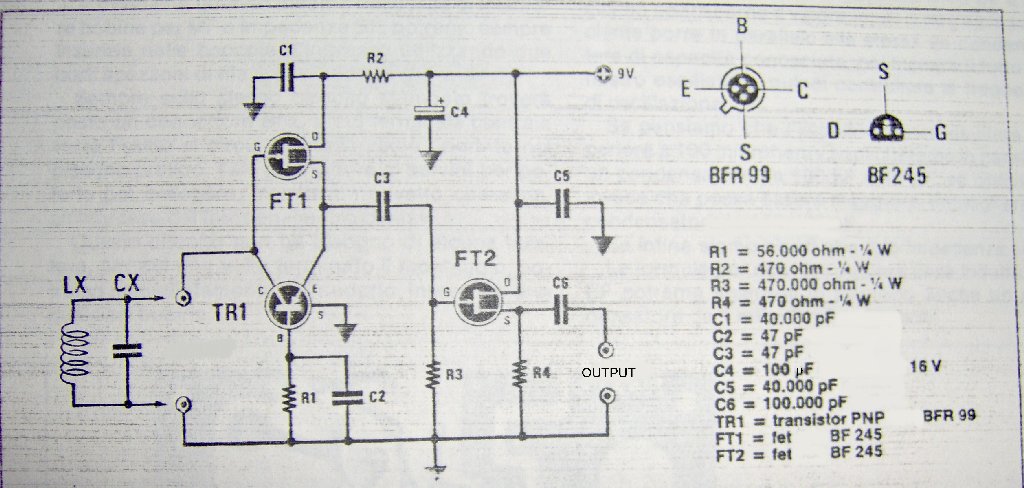

    I found this circuit some years ago, at local library...it came from an old magazine.
    I've built and tested and work great.
    Anything you put there, I mean a coil and a cap... and it oscillates !
    Can go from BF (1KHz...or less) to about 400MHz. Wide range !
    No need of function generator anymore ???
    The formula you already have !
    but anyway... here it is
    frequency=
    for lazy people there are also online calculators...like http://www.see.ed.ac.uk/~jwp/radio/s...e/lc-calc.html

    • Hi,
      Max.
      So what is the idea?
      What I conect to output points?This circuit measure what?Frequency or inductance?
      Because I begin to confuse.
      And can this BFR99 be replaced with come more easy to find transistor?

          Max.
          This is the oscillator output.
          In fact it looks like you can leave out everything to the right of C3, as it's just a buffer circuit.
          You simply need to measure the frequency of the output signal, or the output from C3 (if you don't fit FT2) and then use the formula to calculate the inductance (L).

              Use this formula:
              L = 1 / (w^2 * C)
              where: w = 2*pi*f

                you can just connect your multimeter for reading frequency at the output leads. That's all.
                The circuit gives a good buffering and any multimeter will read that signal. I'm sure of that.
                You only need a suitable and known capacitor value to use the reverse formula and find the actual inductance of coil.
                BFR99 is a special RF transistor... but you can replace if you want with any good dinamic gain PNP one... e.g. a >250 gain 2N2907.
                Circuit works too at lower frequencies... but of course you'll never get it oscillate at 400MHz like with the BFR99...
                Of course you don't need so hi-frequencies to make your readings... just few KHz are enough for your needs (find inductance value of coils).

                    The idea is that you put a know cap. value e.g. 47nF or something similar value BUT known and the coil at input of the univ. oscillator.
                    Then read the frequency of the given by the LC resonant load directly at output of this circuit with your multimeter.

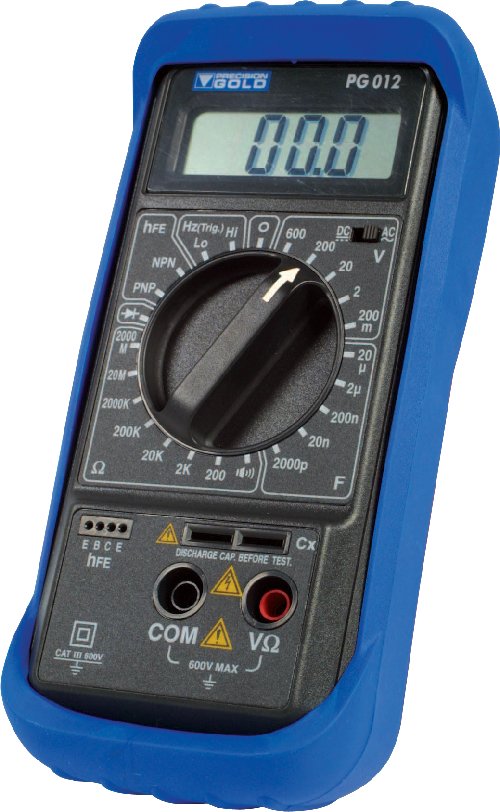

                        your multimeter must have the frequency meter built in.
                        Or you have to use scope or a stand-alone frequency meter.

                          What should I conect to this S point which goes to ground?

                            Here's an example of a multimeter with a frequency input ->
                            http://www.maplin.co.uk/Module.aspx?...meter&doy=19m8
                            It also has the advantage of a capacitance meter, so that you can measure the capacitor accurately.

                              The reason for the circuit?
                              Answer (with a question): How are you going to measure the frequency if you don't have an oscillator?

                                fact is that is simple using the formula of above , so just one capacitor, instead of using e.g. the tx section of GSabre directly then reversing the Colpitts formula to get inductance. But you can do also that way... you haven't buffer but you can read frequency directly from GSabre oscillator too.
                                Circuit is a general purpose one... could be used for other measures of frequency on general LC loads.
                                You need in both cases a frequency meter, or a multimeter with it built-in.
                                I was thinking you got one already (multimeter)... so I posted the oscillator circuit.
                                I know. So could be worth getting a good multimeter with inductance meter too ... like suggested before... than find a new with just frequency meter!
                                Anyway, when I talk of "built in" freq. meter I mean a multimeter like the one below (must be Hz label somewhere at rotating switch).
                                About the S = shield , is the metal case of BFR99, internally connected to the S-lead. You could also ignore it if use e.g. 2n2907.
