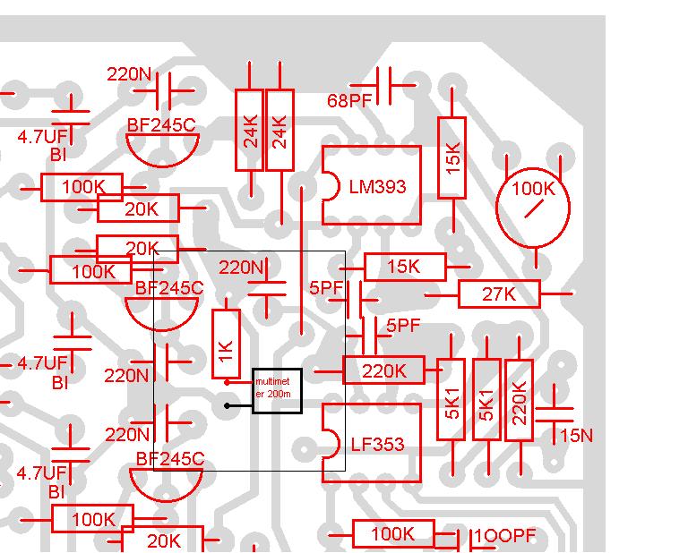

    Thanks for the advice I will try this way because for now dont have other alternative.But please tell me what can I demage when measuring current?
    The multimeter or metal detector?
    Be careful when the meter in the milliamps test mode. I don't know your particular unit, but It may be more succeptible to damage. It is easy to blow a fuse - or worse when measuring current. You should definately THINK about what you are doing before you apply power, more so than usual.
    How should I Measure AC current, instead of AC voltage?Put the multimeter in DCA 200m right???Or?
    /look at the picture that I have post/
    THANKS

        About your meter:
        Tiktak, for the purpose of this discussion: in the voltage measuring mode, you are using a VOLTmeter. In the current measuring mode, you are using an AMPmeter. A milliameter is also an AMPmeter, but set to a low range.
        So long as you make connections to CUT (circuit under test) as I tried to show in my picture, you should be OK.
        Here's some theory you should already KNOW, but here it is again:
        When measuring voltage, a VOLTmeter will present a high resistance to the CUT. You can connect a VOLTmeter across a 220V source, and only a small amount of current should flow through your meter because the actual resistance presented by your VOLTmeter is, ideally, very high.
        That is not true when you measure current. An AMPmeter will present a very low resistance to the CUT. If you put your AMPmeter leads across a low impedance voltage source (such as a battery or voltage regulator output), something WILL smoke. All of the current that you allow, will flow through your meter - as determined by I=E/R (I = current, E = voltage, R = resistance). You must limit AMPmeter current with a resistor. That is why you need the 1k resistor in the null test circuit I showed you. You must not short out your opamp output, or else the measured result will be invalid.
        And, there is the possibility of damage.
        An AMPmeter (milliammeter, also) is approximately ZERO ohms resistance from one test lead to the other. It is a potential short circuit waiting to happen. Even one volt, or less, can theoretically cause infinate current to flow through zero ohms. Infinite current generally means something is bad, or will be soon.
        So, what could happen if you want to measure a 12V battery with your multimeter, but you have your multimeter dial set to amps? In the milliamps mode you may only blow the multimeter's fuse. But, in the 10 amps mode, there is no fuse - and so you could either zilch the multimeter, or whatever you are measuring. Some meters have good overload protection circuits, less expensive multimeters usually do not. If you are careless in the AMPmeter mode, you might have to kiss your multimeter goodbye. Use the milliamp mode because it is fused. Fuses are relatively cheap, but they are not 100% effective - so you should still be careful.
        An AMPmeter is approximately zero ohms from end to end, don't connect it anywhere that cannot handle a straight piece of wire! You don't place a jumper from one end of a battery to the other unless you want fire and smoke, do you? - it's the same idea.
        Read your meter's instructions.

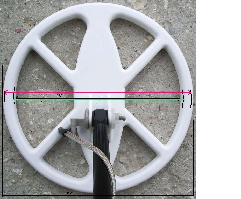

              • Hi,
                Max.
                Thanks.I uprishiate that you spend from your time to answer to all my questions.
                About the 25DD I am still in frustration.You say ,try use less turns with respect to 28DD,but this 28DD use 120 for TX and 125 for RX!And 22DD use 145 for TX and 151 for RX?If I decrece the number of turns,I should increase the D of the winding?>???
                I dont have LC meter!The only thing that I have for now is this multimeter.
                Can I measure inductance with this?
                The resistance should be from 19,XX to 22,XX ohms!But what should be te inductance?
                Here is a stupid picture that I have tryed to show this coil housing dimensions!
                That why I think that the former size should be 25cm??
                Tomorrow I will have all the materials for making coil,so I am in a hurry!
                I have replaced TL062 with TL072 for now,and there seems to be a differance.I have make some tests again with my first coil and looks like its better!Less noise
                  I am BEGINER!
                  In this calculator there are inner diameter/I understand former size?!?/;wire thicknes and number of turns!
                  What is the (2*pi)?
                  I can't get the point?
                  Using "pi" was just an easy way to write "p".
                  The value of pi (p) is 3.14159
                  So 2*pi means "multiply pi by 2".

                    • hi
                      porkluvr.
                      I have told you that I am begginer and have very little to use and much to learn.
                      Maybe because of my bad english,but I cant see for shore in which diapazon should I put multimeter when trying to null!
                      Please look at the picture again 200ma can be measured in DCA!is this correct?

                        By the way, you should really buy an inductance meter. there is no way to directly measure inductance with a multimeter.
                        The only other method (without an inductance meter) is to connect your coil to the TX circuit and measure the frequency, either with a oscilloscope or a multimeter with a frequency measurement function. Since you know the capacitance values in the tank circuit and the frequency, you can easily calculate the inductance.

                            yes sorry. I made a mistake writing previous answer, you have to increase number respect to 28cm and decrease respect to 22cm.
                            I was thinking at 22cm then wrote 28.
                            Anyway, you'll get the picture. You need same inductance but you have more area inside your new D shape.
                            Let me know.
                            Follow Qiaozhi advice. Buy one inductance meter... there are cheap ones now. Or if you can wait I think I've found a circuit that could solve your problem if you can measure frequency.
